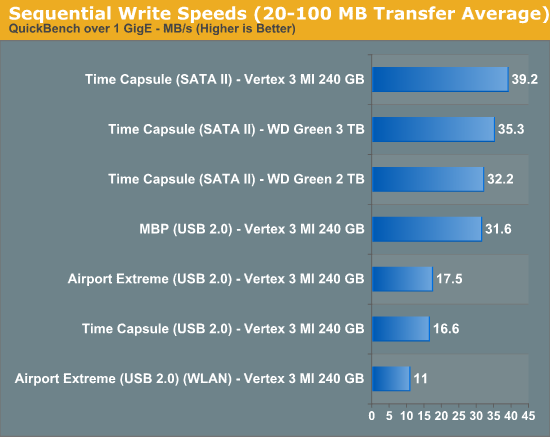

Oh. I thought you meant if you were connecting the external hard drive directly to the computer. If you connect it to the USB port on the TC, then it will slower to backup by more than 1/2.
http://www.anandtech.com/show/4577/...nd-time-capsule-4th-gen-review-faster-wifi-/7
The SATA II benchmarks are when the hard drive is connected directly to the SATA II controller in the TC. The USB benchmarks are when the hard drive is connected via USB.
But if you're doing this via wireless, as opposed to via ethernet, then you won't notice the difference if the hard drive is connected to the TC via USB. (wifi is slower than the max speed the USB port can provide so the backups will seem to take the same amount of time regardless of whether you're backing up to the TC's internal or external hard drive )
