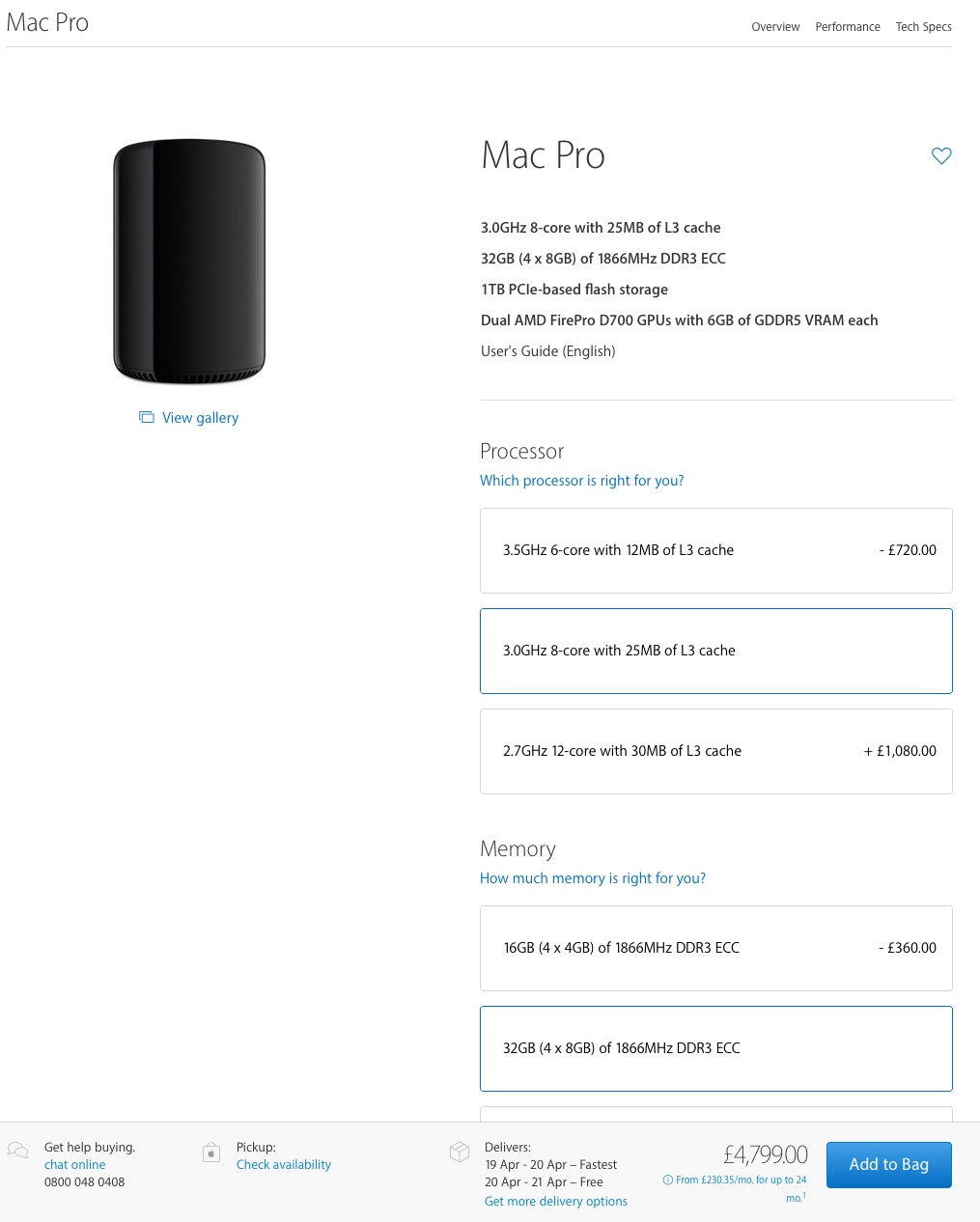

Make sure you have a good look at the prices before you order. I’ve just seen that a refurb;
can cost more, yes MORE than a new model;
