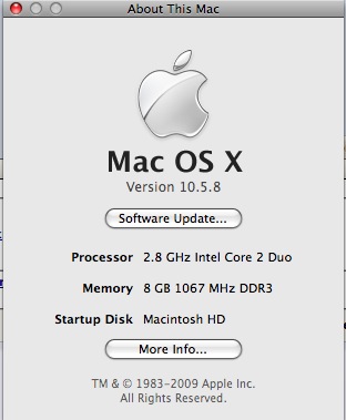

How do you figure? The new MBP's can support 8Gb otherwise they wouldn't offer it!

Yes, it can support 8 GB. Probably overkill unless you are running multiple memory hog programs at the same time...or multiple VMs like I do.
Thanks, ya, photo and video work does tend to be both processor and memory-heavy.
