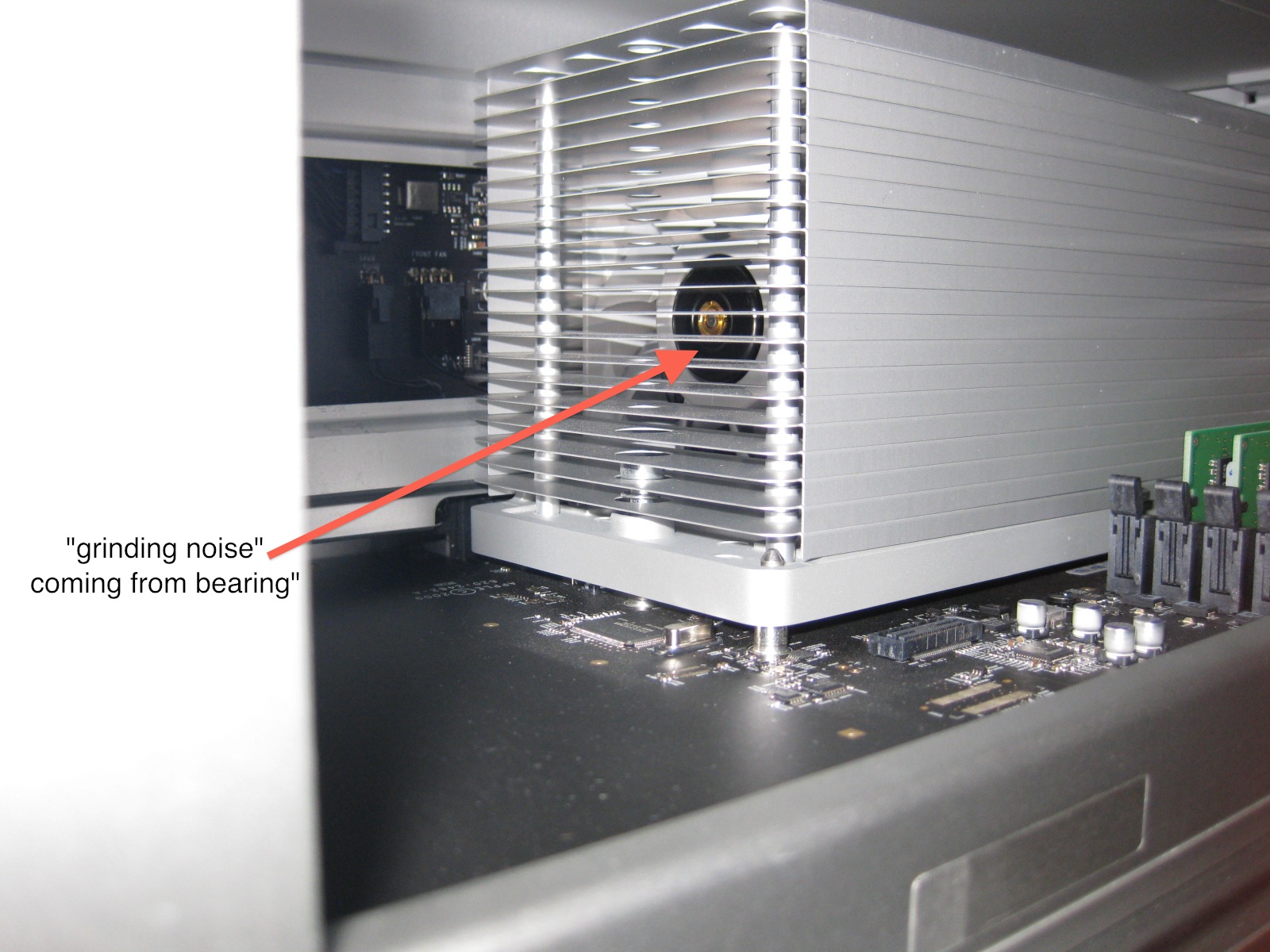

Are you familiar with the in's and out's of your Mac Pro? If you are comfortable enough with taking the side panel off while the machine is running, can you hear the noise coming from the CPU heat sink fan? See my attached photo? If so, arrange a service call with your local Apple Store and be persistent that something is going on with that fan. Does it sound like it is coming from where my pictures shows?
I have determined the culprit was the heatsink fan, the "BOOSTA" fan on my single-processor Mac Pro. I have fixed the situation for now, it's not making the noise anymore.
What I did: Used SMCFanControl, set "BOOSTA" to 4000rpm and ran that fan on high for one minute. Set it back to lowest setting...I think the fan had never been run on high before, and somehow this has fixed the problem...I am going to post this over in the other thread too so hopefully this can help somebody.

My Mac Pro seems to have a lot of vibration going on. I got some coming from the intake fan and possible some other vibration. Not sure how to address this problem when I go in for my PSU replacement (mine buzzes) on Wednesday.
Desmo1098, were they able to replace JUST the CPU fan or did they have to replace the whole CPU/RAM tray? :/
@ 2contagious
They replaced just the heat sink, which had the fan built-in. There was no need to replace the CPU/RAM tray. I confirmed that they would also check the thermal paste and the verified that they would.

That second file I posted of the sound:
http://www.wardcurry.com/rattle2.mp3
...was taken with the recording device mic right next to the CPU heatsink fan. You can hear the sound is alot louder than the sound taken from in front of the grille next to the front inatake fan. That's why I think it's heatsink fan.
Here is a recording I took today. Right next to the Heatsink fan. You can tell the rattle is very annoying, and very loud:
http://www.wardcurry.com/rattle3.mp3
Even better yet, listen to THIS. This crap is getting LOUD:
http://www.wardcurry.com/rattle4.mp3
Today, the sound is getting louder and worse. It is that flimsy sputter sound that is very annoying, and it comes and goes every few seconds.
I am thinking about just buying a new heatsink online and replacing it myself.

Sounds like a bad bearing. 🙁
If you're going to replace it yourself. Perhaps you could jimmy-up a 120mm fan. ???
I am probably going to buy a replacement heatsink from applecomponents.com
The part is $89.00, and it will require that I carefully take the old heatsink off and apply new thermal paste to the processor. I think this is what I am going to do.
I have just about 100% completely determined that the sound is coming from the heatsink fan, Those last recordings were from my iPhone placed inside my Mac Pro running right next to the side of the heatsink. The rattle is getting louder now and more frequent. I could not sell this Mac Pro with it making this noise, and I have to keep my Mac Pro on the floor now just to keep the audible noise at a bearable level. The putter-putter sputtering flippy sound that is makes is super annoying, and I think replacing the heatsink is my only option now.
I just don't want to leave my Mac Pro with Apple for a period of DAYS while they have to order parts and do the replacement, this could take several days to over a week, plus I don't want to haul a 50 lb. machine to my Apple Store. Just not worth it when I can get the part for $89.00 and do the install myself in no time flat.
So this is my plan. I'm probably going to order the heatsink tomorrow. I just hopes this works out and solves the problem.

Just a note about taking it to Apple. I took mine in for a replacement PSU on Friday and got my machine back on Tuesday (or Monday, can't remember for sure). Some people have had luck calling them and convincing them of your problem over the phone so that they preorder the part for you. Just an idea if you are still under AppleCare and want to save the $90. If not, good luck with your new heatsink 🙂
The heatsink, the 3mm 9" hex wrench, and the thermal paste are ordered...I am set now. Just have to wait until the end of the week for everything to come in, then I will be ready to install my new heatsink.
I hope this fixes the problem...
Well, bit the bullet and took my MP to the Apple Store in Aberdeen. They took the easy route and replaced all my fan units, and the rattling/buzzing sound is now gone. Their best guess was a worn bearing.
