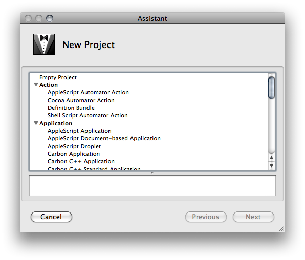

Hmm, when I create a new project, I'm met with this window and it only has the Carbon C++ and Carbon C++ Standard applications. I just create a empty project right?
Edit: Lazydog, thanks so much, I just had to scroll down to command line and expand it. It worked. Thanks!
P.S. Now the .cpp and .h help please 🙂 thanks.

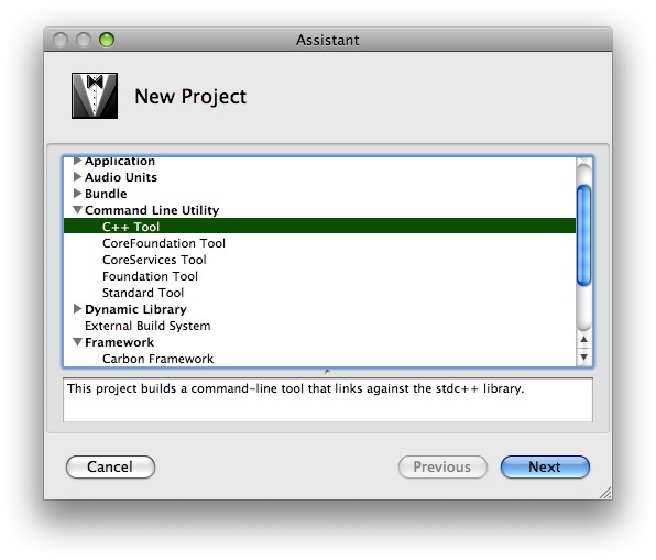

Command Line Utility->C++ Tool.

Yep I found it before in my previous post. Thanks anyways though lol
