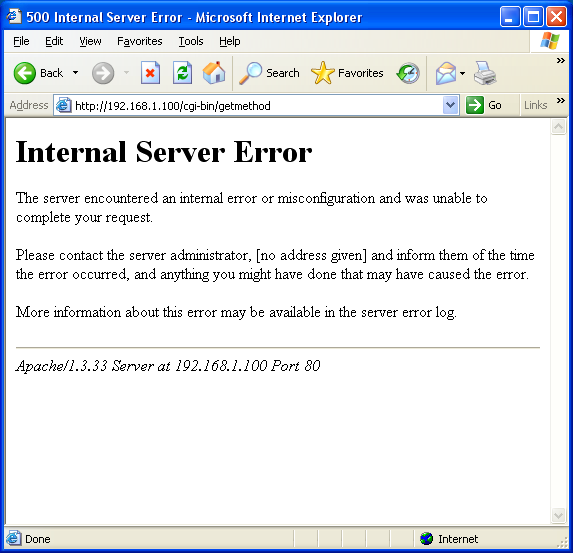

This CGI setup does not "always" work when I access it from my Windows XP machine on my home network. I have lots of info to illustrate the issue, so please bare with me as I present it.
I'm running Tiger (OS X 1.4.11) on a Mac Pro. I've enabled web sharing and that seems to work fine from my Mac and from my Windows machine. I'm running the default Apache server that comes with Tiger. On Windows, I'm running IE 6 under XP.

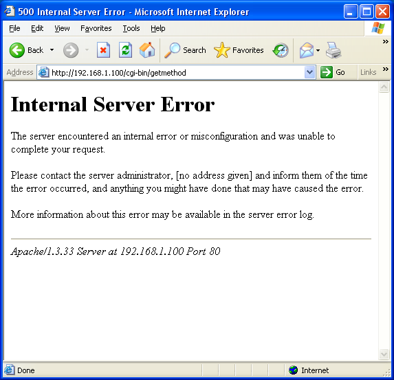

Now, interestingly enough, while on this "Internal Server Error" screen, if I click the IE's Refresh button, I get the prompt for "do I want to resend this form", I click RETRY, and VIOLA! The output of the CGI program appears. This is eating my lunch. Why does it fail the first request, but work on the refresh?
The initial request error status code is 500, which seems to be a catch-all error code. If I tail the error_log and access_log, I can see the requests and errors, but I don't know what to do to fix them. Here's the access log:

Why do you think I am getting the premature end of script headers? It obviously works under Safari, the command line output proves this, and is working under IE after the refresh, just not the first time. I've chmod'ed 755 so many times I'm blue in the face. I've tried renaming the getmethod execute to getmethod.cgi and there is no change in behavior. I've tried dozens of combinations of "\n\n" to add a blank line under the content-type header line. I googled and saw one tip for making sure I added fflush(stdout), and I didn't have that, so I added it to my C program.
So, what's the deal? Is this an Apache thing?

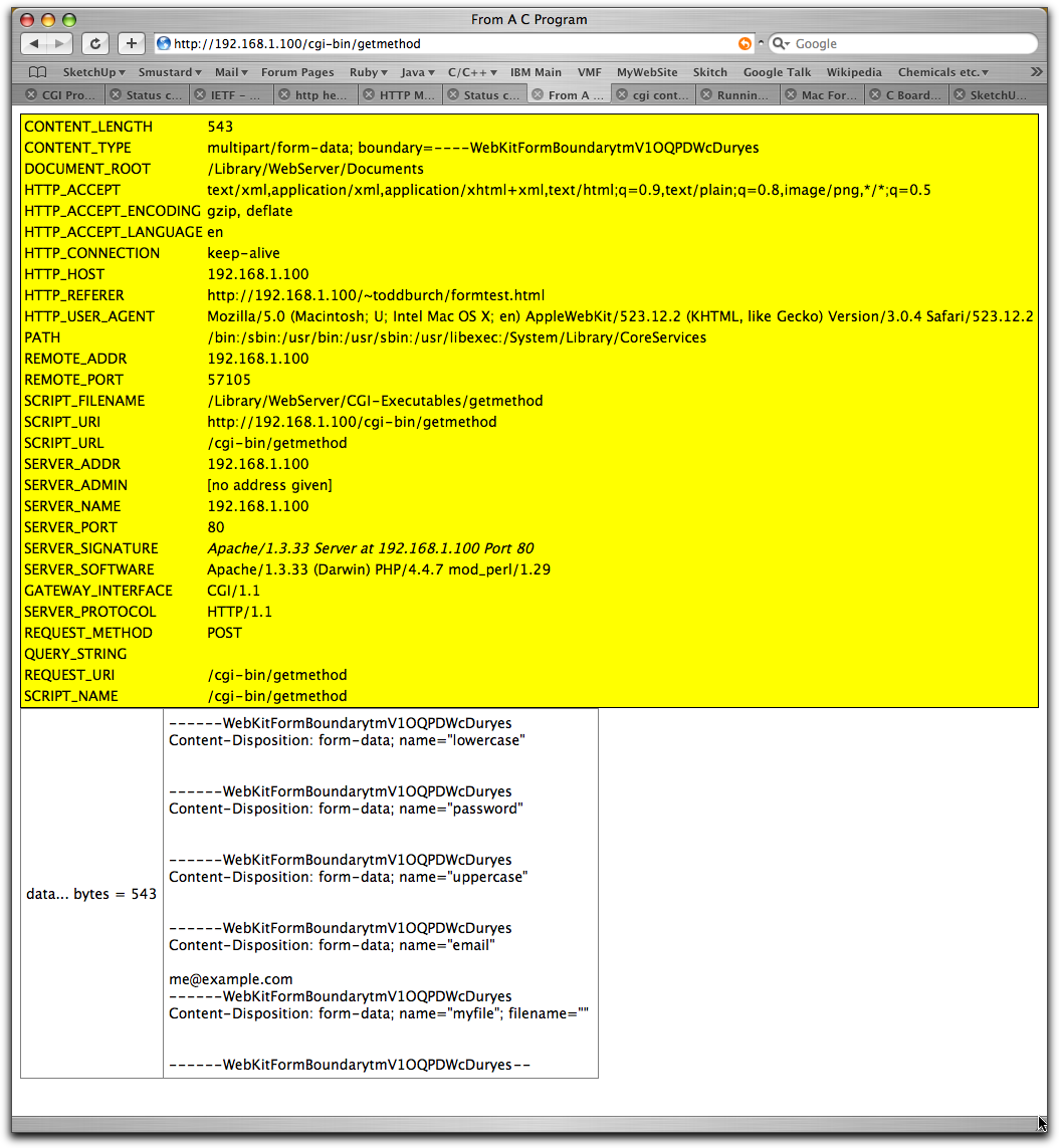

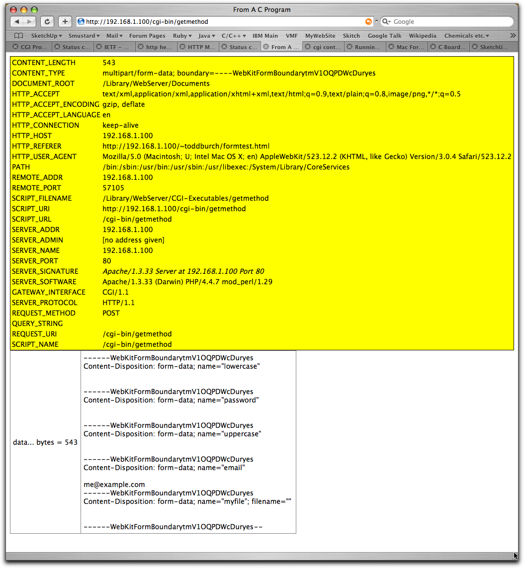

When the output page is served up, for method="post", one of the environment variables is the boundary separator for the content-type data in stdin. See the attached image with yellow. Notice the 4 hyphens that lead off the start of the boundary separator.
Now, look down at data (white back ground). The boundary marker starts off the 6 hyphens, and the last marker even has two trailing hyphens. Is how this is supposed to work is to simply look at the "line" and if the boundary marker is on the line, then treat that line as a boundary marker? It seems reasonable that this would be the approach to take.

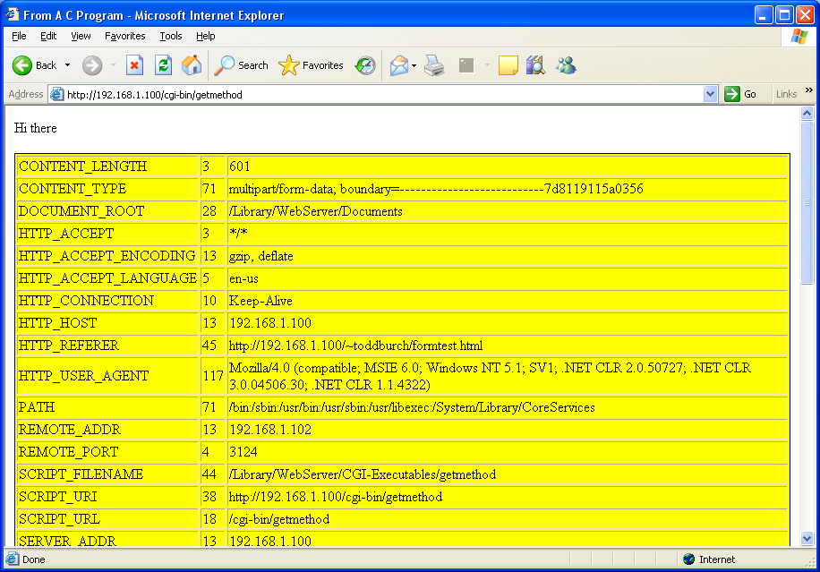

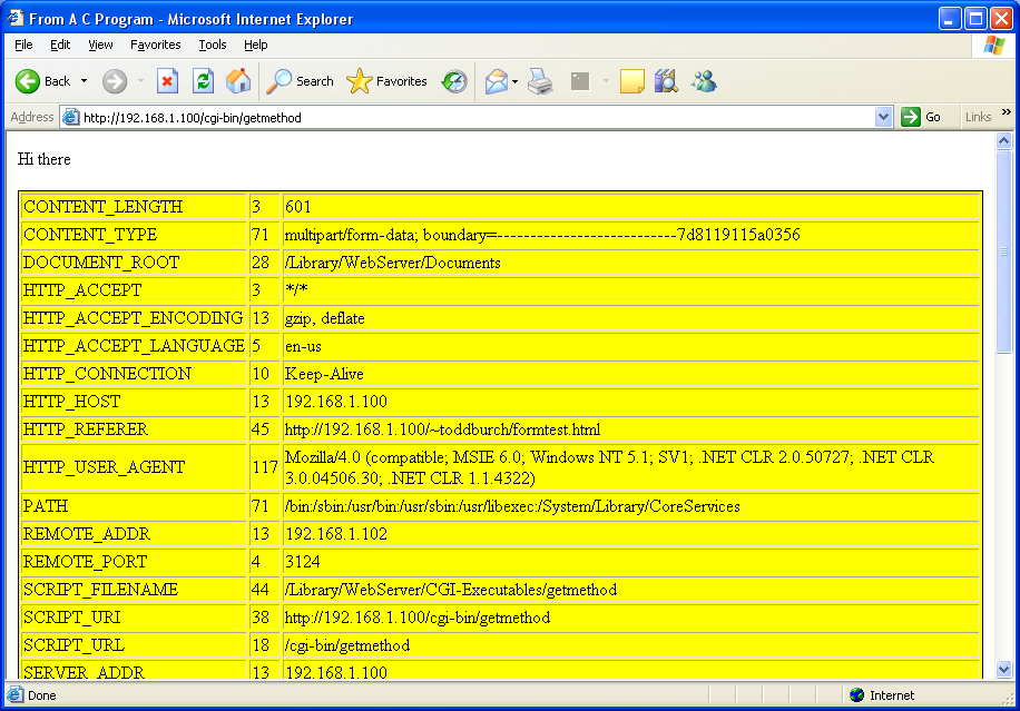

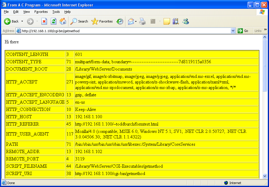

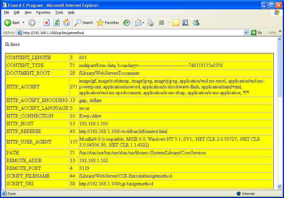

[size=+3]YOU ARE THE MAN!!![/size].
That was exactly it. The HTTP_ACCEPT variable was longer than 256 bytes. Upon refresh, it was 3 bytes. I recoded my table to show the length too, and this confirms it!
WOO-HOO!!!
Thank you so much. I owe you a cool one!
Todd
