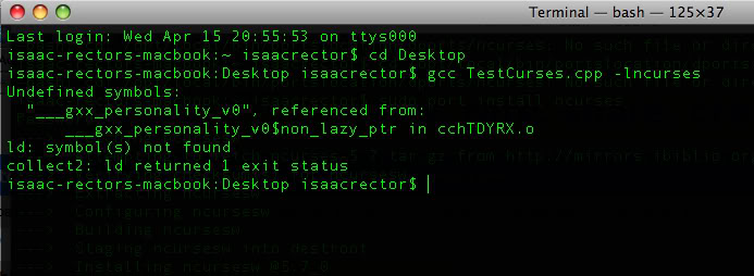

When i try to compile using gcc <filename.cpp> -lncurses
I still get the error:
Code:
Undefined symbols:
  "___gxx_personality_v0", referenced from:
      ___gxx_personality_v0$non_lazy_ptr in ccbYsUJs.o
ld: symbol(s) not found
collect2: ld returned 1 exit status
Image:
I still get the same
Code:
Undefined symbols:
Looks like you have the "-l" flage correct but you need a "-L" (upper case L) flage to point to the directory where the library is. Either that or set a library path
This is not a "Mac" thing. It's a compiler issue and it works the same on all unix-like OSes
