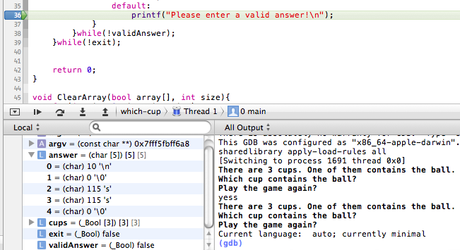

If you run the program the first time around and type in 'yes' when asked, it will go back and do what it's suppose to... The second time it gets to the switch statement NO MATTER what you type - the switch goes do default!
I've run the code in Xcode 4 under gdb and looked at the answers array the first and the consecutive times around... At first all seems normal, but then the array is filled up with jumble!
Does the fgets() fail? Does the array needs to be cleared or something?

My guess is that a new line character is left in the buffer. So the second time around, fgets gets '\n' which match nothing but the default. This makes sense with the 'Yes' alternative as well since the string consumes all space you have i.e 'Y', 'e', 's', '\0'. Try making the answer into answer[5].

The posted code works fine if you only enter short responses, such as "y" or "n". It only malfunctions with long responses: e.g. try it with "yarrow" or "yesterday" or "you must be joking".
Better input checking would improve results even more. The key is to check for a newline at the end of the fgets() result. If you don't see a newline, then it means a complete line wasn't read, so you should repeatedly call fgets() until a newline IS read. This newline indicates the end of the line, i.e. the end of "yarrow" or "yesterday" or "you must be joking". If you're smart, you'll put this in a separate function, which you can then reuse in other programs that have similar input requirements.

subsonix, the suggestion works temporarily for my programing practice to allow for answer to be 5 chars long, though if I enter something longer than 'yes' the problem still occurs...
chown33, I am a little confused on how this solves the problem...
The inout still REMAINS in the stdin buffer...
If I type in 'yess' the first time around and press enter, the answers array (size 5) will have 'yess' + the '\0' (terminating zero). The second time around it looks like this:
It seems like the rest of what I typed in i.e. carriage return, is inputed to fgets() without even asking for user input! Thats right! The second round fgets() skips user input entirely! (as you can see by the program stopping at the breakpoint in the pic, at the default clause of the switch statement)
My conclusion is that the stdin buffer needs to be cleared from my understanding... Is there a way to do that?

What is commonly used in place of fflush(stdin), is a while loop like this:
Code:
while( getchar() != '\n' );
I remember when I had this NEW LINE problem I used a scanf after my fgets to absorb the new line left over. It may not be the best way but it worked for a small project I made when I was learning C
