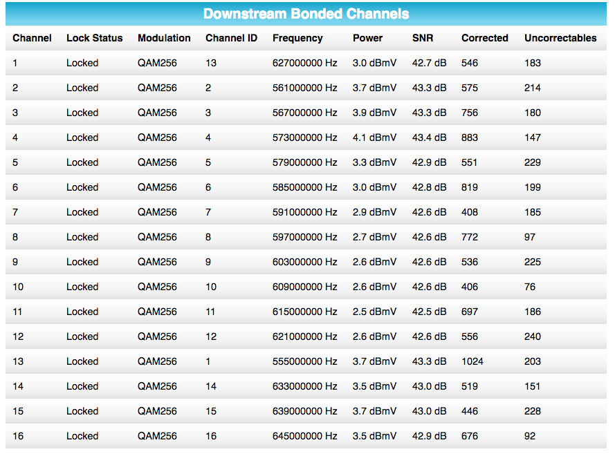

Not sure about IPv6 — AFAIK it has never been enabled in my area. I don't think it worked with the 6141 before, and it isn't enabled with the 6183 now (per ipv6-test.com). For laughs I'm attaching a screenshot of my current Status Connection page; I think I've only rebooted once since the tech removed the trap. I still find that it's touchy every now and then, but it's still MUCH better than it was before. Faster than the 6141 for sure, albeit slightly less reliable (one outage last week after trap removal not related to Time Warner's network; vs. every day with the 6183 and the trap; vs. never with the 6141).
As far as SB6183 vs. Netgear, I'm not sure what to say. I've never had a Netgear cable modem. No idea if it would be any better or not; but I'd note that a trap on your line may still cause issues with any modem using more channels than you're using now.
