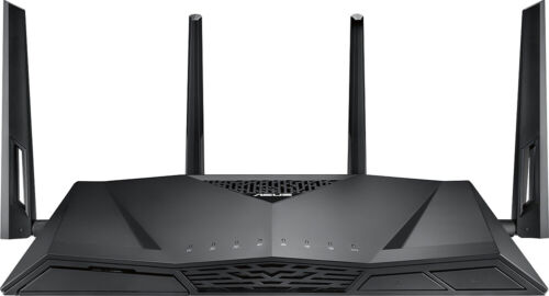

You should never lease any modem from Comcast or any provider since most of them supply modems lower than DOSCIS 3.0 so you’re better off investing in buying your own modem.
The combo aren’t great so buy separate device. Any cheap Arris DOSCIS 3.0 will work as long as it’s capable Of handling your download and upload speed. You might be able to find cheaper ones. I would recommend AC 2900+ for router.
$47
$140
