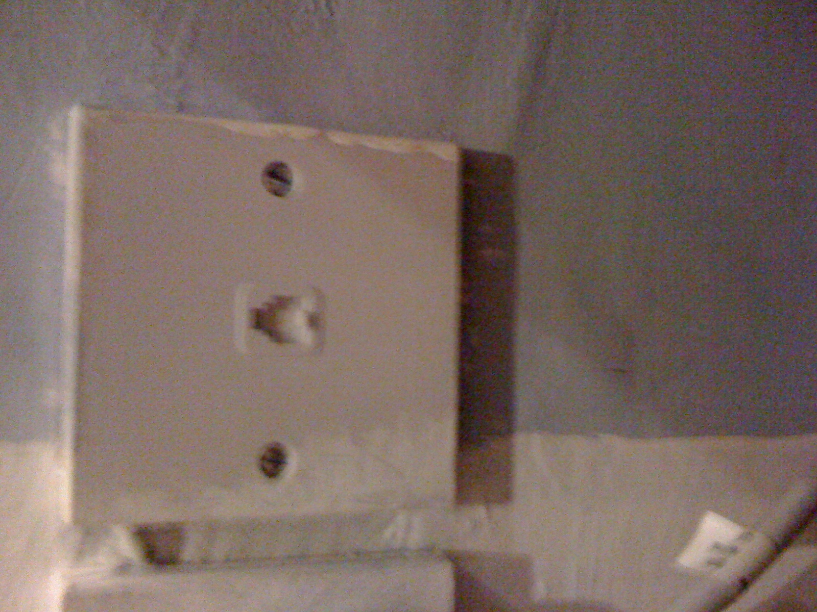

Hi I'm looking to upgrade my netgear DG834GT as it is so slow neogitiating a connection and was wondering how would i get the normal cable modem into the airport.(cable modem is a plug usually used for dial up back in the day, and no I'm not on dial up I have 7MB internet) I attached a pic of the interface anyway. I was looking at cable to ethernet adapters, do i use one of those, how would i setup the base station when i enter my PPOE settings like username and password for my provider. And will i go with the airport extreme or that tempting time capsule, F.Y.I plan to buy a pogo plug to access 1TB from anywhere and locally, would that just eliminate the heat of a time capsule and the price or has time capsule got better with their "Service Grade" Hard drives. And as for the cable modem, if u guys can link me up to the exact converter that would be good? 😀

That isn't just a router, it has the modem inside it.
You will need to buy a new modem compatible with your service (should be a page on their website) and look to see which one is a plain ethernet modem.
Especially since some of their choices will be USB/Wireless.
Stick the new modem between the wall outlet and the Airport Base Station.
However, the Macs tend to have problems with the Netgears and can cause the negotiation issues using wireless, so if it has an ethernet port disabling/bypassing the wireless portion and using it as a plain modem works better.

You will end up having to get a new modem. The modem is what does the whole "changeover" from RJ11 to RJ45. If the modem is not working you could tell the ISP and they should change it out for a new one either free of charge or little cost to you. Then take the ethernet cable to the Airport and your done other than setting up the security in the Airport.

This is the modem part, which means in order to replace this router ... you need the Airport router + ADSL modem.
For the modem, skip the wireless versions and get the ethernet one.
The compatible modems with your provider should be listed on their local support website.
(phone jack) -rj11--> (ADSL modem) -rj45--> (airport wireless)
