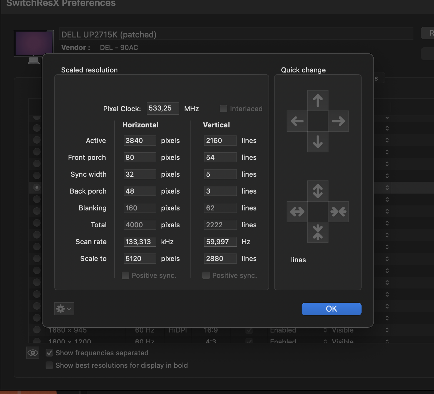

I've tried a new configuration.
I've used the:
- monitor's DP cables (the pair)
- OWC Thunderbolt 3 Dock
- two adapters from DisplayPort to USB-C (to connect the DP cables to the Dock)
- the dock to the M1 MBP (tb3)
- separate power cable to the M1 MBP (the other tb3 port)

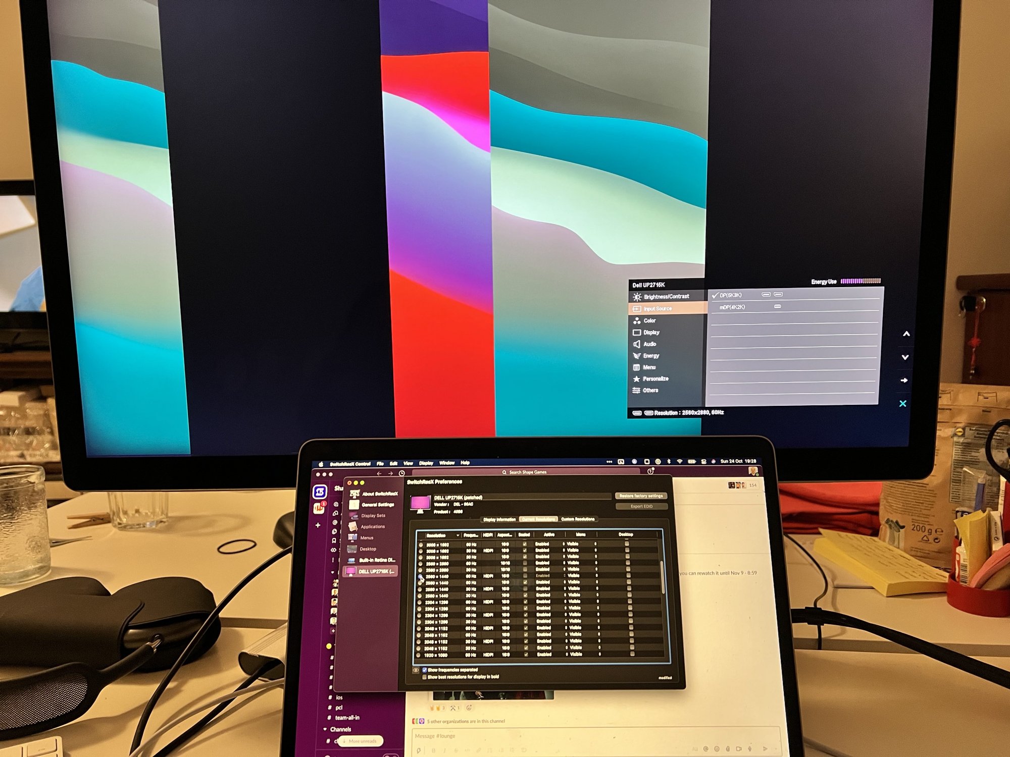

Also with the patch file from Flaky Goodness. Now I get all the possible resolutions & 30/60 Hz combinations. Including the proper 2560x1440 HiDPI @ 60 Hz. However the screen looks like this. The monitor's menu shows a resolution of 2560x2880 @ 60 Hz though.
That’s not right. What happens if you hook up the monitor (using the USB-C to DP adapters) directly to the MBP, without the dock?
And what’s the timing info for the 2560×1440 60Hz HiDPI setting?

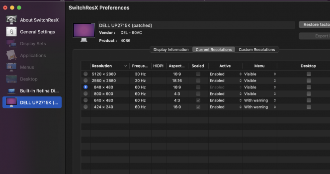

Ok, with the Plugable adapter. Now I'm getting the 5K @ 60Hz showing on the monitor. And in SwitchRes 2560x1440 HiDPI @ 60Hz!
HOWEVER - the monitor flickers like crazy. It's visible when looking at an image with different colors. It looks like it only flickers in certain areas of the screen (most visible in the center). 🙁
Ok the flicker has stabilized after about one hour. And it was gorgeous! 🙂
But this morning I moved the cables and the monitor went black, when I powered off/on the monitor it was back at 5k30Hz. fml
At least I know it can do 5k 60Hz. It's probably the adapter or cable - some connection issue.
