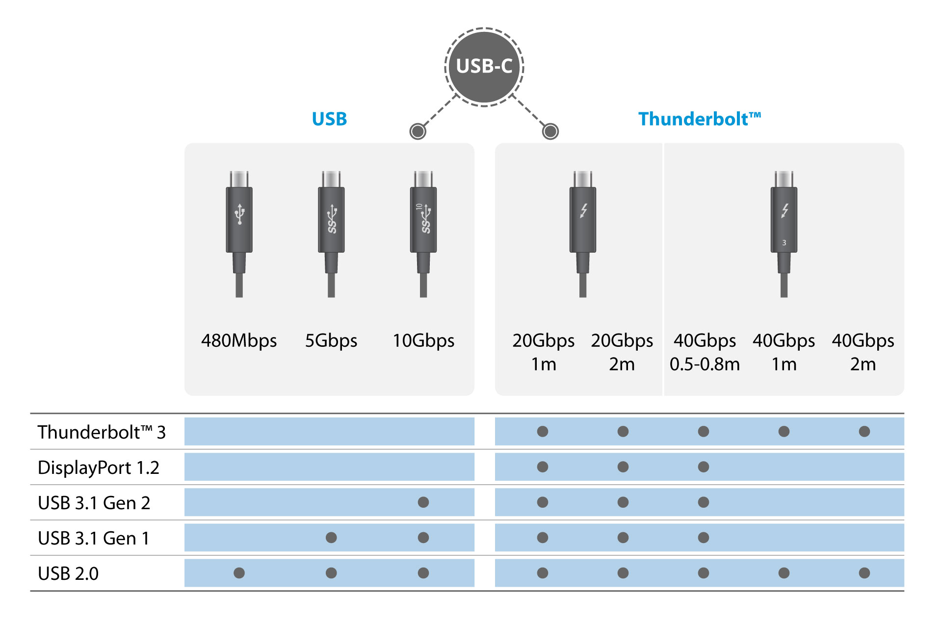

I believe you're reading that chart wrong. The cables that support DP1.2 at 1m/2m are only at 20Gbps bandwidth. They're all TB3.
I thought TB2 topped out at 20Gbps, which is why I assumed the the cable on the left referred to TB2. Note the cable on the right has a "3" under the lightning icon, and the other cable doesn't, implying it isn't TB3.
My question was why can a 20Gbps connection support a 2m cable, but the table states that a 40Gbps cable can't? I appreciate that higher frequency signals can have more limited cable runs, but if so, you would need a lower frequency cable to connect a monitor, which would make the whole system far less flexible for daisy-chaining.
[Update: looks like the table is correct. Passive TB3 at 40Gbps has a maximum length of 0.5m, https://blog.startech.com/post/thunderbolt-3-the-basics/. Active cables can be up to 2m
That's not a long cable unless you have the computer right under the monitor. ]

USB 3.1 and TB3 cables are not physically the same, only the connector interface is. Please see the chart I posted above and note the length limitations.
Yes I know, especially TB3 short passive / active long cable, they can really act different with USB 3.1 devices, I am just lazy to explain things 😉 as your charts, is better to explain the difference.
That's why I said choosing right cable for USB 3,1 and TB3 cable is so convoluted things.
