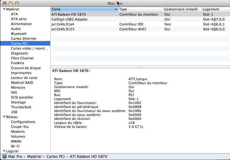

Hi, I've bought this card for my macpro (as the Orico not working properly), everything is great in USB3.
I don't have any eSATA for testing the eSATA ports, but I'm concerning about the kext.
Is this normal that there is no kext for the IDE Controler ?
Thanks in advance.

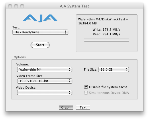

I ran this test using the FASTA-6GU3 to an OWC On-The-Go USB3 enclosure, with a Crucial M4 256GB SSD inside. It's a little faster than when running the same test through the Voyager Q dock, for some reason.
