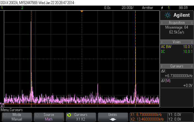

Noise @ 6.73[kHz] and 13.46[kHz]
My station sometimes also made noise (I sold it).
I captured the noise spectrum with a measurement microphone through a preamplifier connected to an oscilloscope (with FFT).
Conclusion: a whine @ 6.73[kHz] and the second harmonic @ 13.46[kHz].
It's a pretty irritating noise for young persons. 🙂
