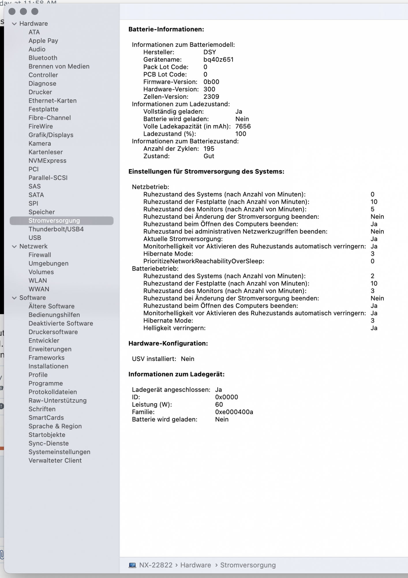

Has anyone a similar problem with the TS3+? I have my whole setup connected to a power strip and I turn it off when I don't need it. If I turn it back on, my MBP only gets 60watts from the TS3+... After restarting the MacBook I get 87 watts.
Is this an issue with my macbook or with the TS3+ dock?

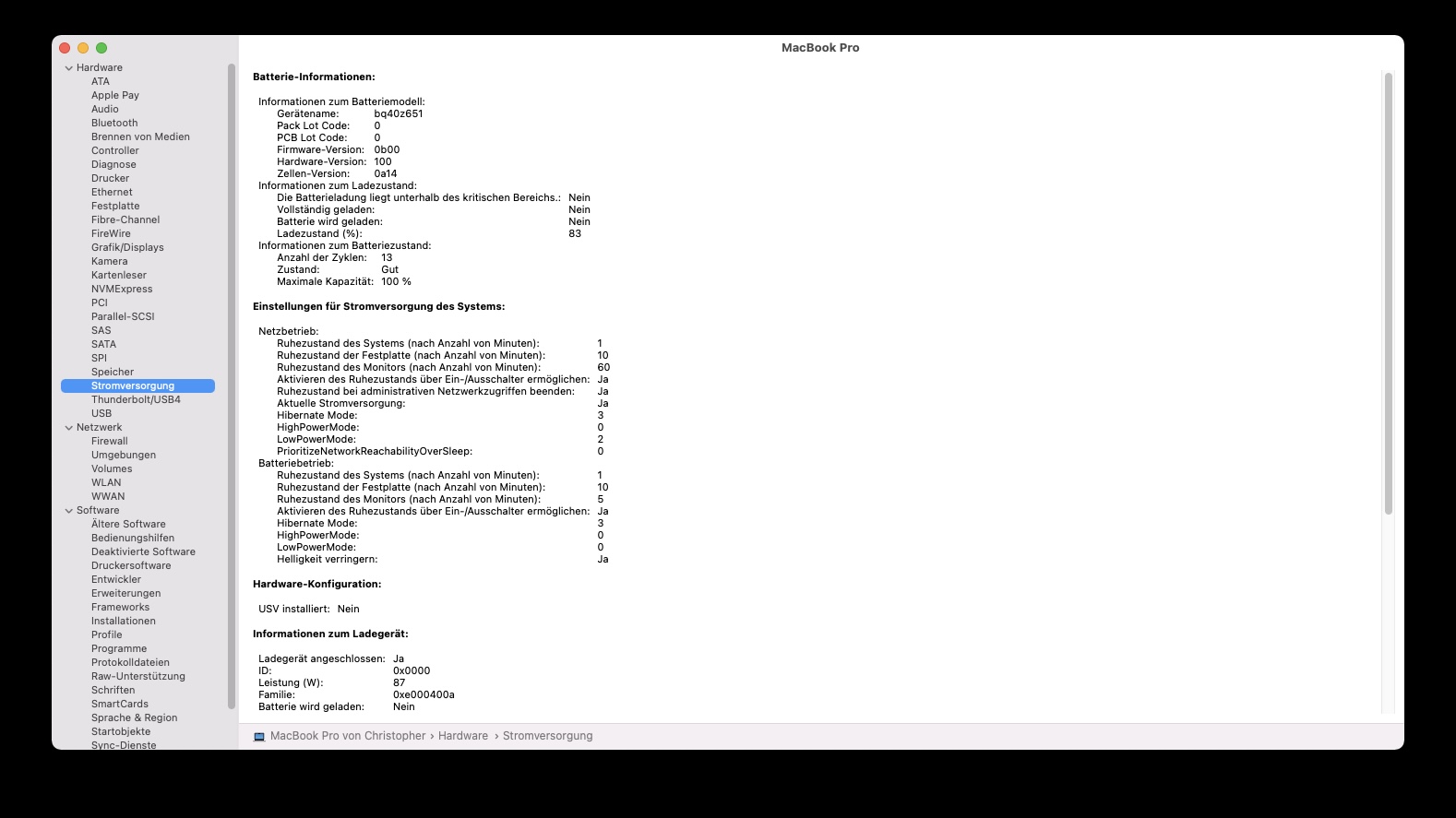

I regularly disconnect it from the power grid when not using the machine for a longer time. It always shows full wattage and as I said I can draw up to 90 Watts without seeing battery discharge.
Just powered up the dock after the MacBook was attached to it overnight in sleep and took a screenshot for you.

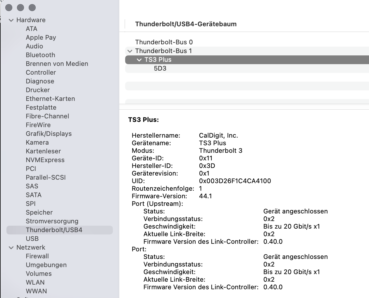

But it sounds strange it sometimes works for you and sometimes not. With a faulty unit it would be more likely to not work at all. To me this sounds more like a software bug. Do you have the latest firmware on your dock? I am running the latest firmware and macOS 12.2 Beta 2 at the moment.
I really don't understand what the problem is, now I can't even get 87 watts after restarting my machine... It just stays on 60, yesterday I was able to get 87 after restarting my macbook.
I have firmware 44.1.
Bildschirmfoto 2022-01-20 um 13.18.36.pngBildschirmfoto 2022-01-20 um 13.18.11.png
Strange. You might wanna try installing macOS 12.2 Beta 2 just to rule out a bug in 12.1. Doesn't have any major issues at least for me.
