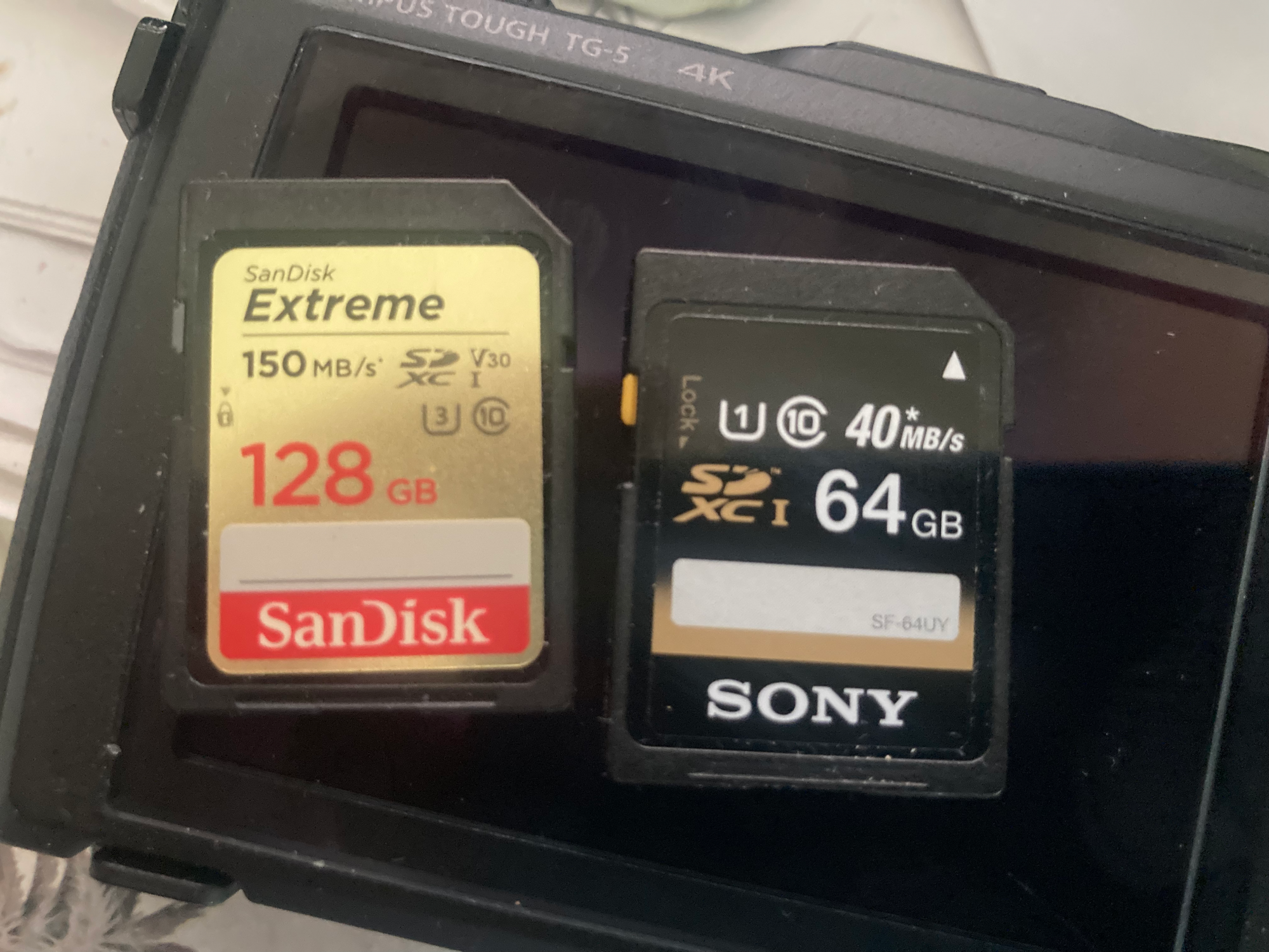

UPDATE: The CalDigit SD card reader seems to work fine with the older SD card shown on the right. Newer card shown on the left gives problems.
Since I've seen this before on other readers (the ones that are too old to accommodate the newer cards) my current theory is that the 3Plus's reader is an old design and I'll need to use the Apple USB-C reader to get around this.
Waiting on CalDigit to confirm; don't expect them to be able to do anything practical about it :(
Tom
