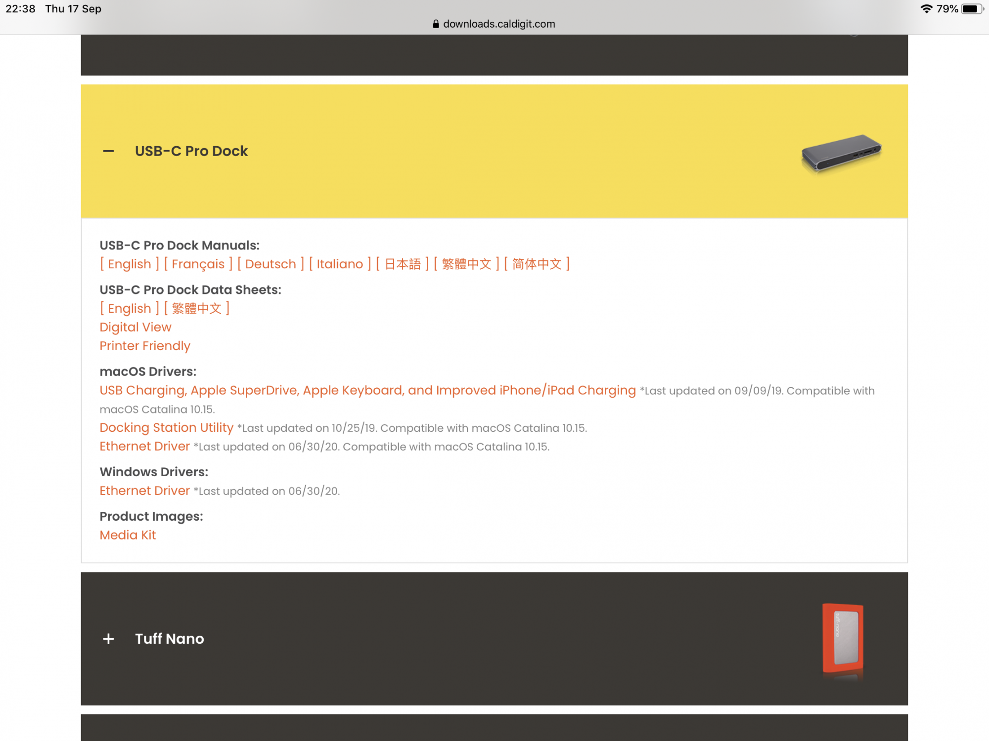

where CAN I find a download link? I can't find the firmware update in download.caldigit.com

I've also been experiencing the network storm problem. Using the driver Caldigit has on their site (which is in fact just a rebundling of one from Realtek) fixes the problem, but when using that driver incoming packets are not logged (you can't see your download bandwidth for example), and moreover it's difficult to get the OS to load it consistently. This driver seems to fix the issue by causing the ethernet interface to go completely dark when the Mac is off. The Apple driver leaves it on (probably needed for WOL) but then triggers a bug in Caldigit's USB drivers that occurs on other docks as well to cause the storm. I'm hoping the jpiscaer firmware updates these drivers to fix this.
