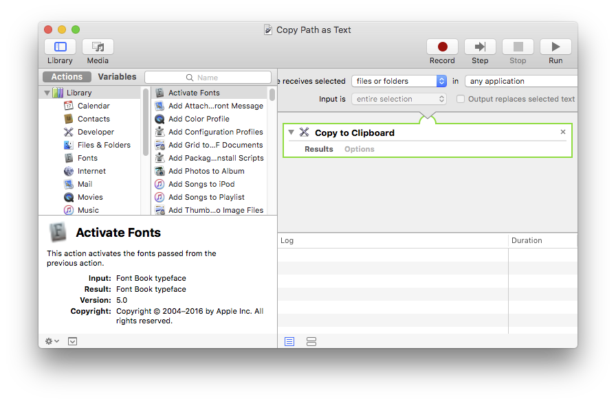

On a sidenote: in case you were wondering how I got all those file and folder paths into this posting... I came across an article on how to create a File to Path OSX Service. So all I had to do was right-click the folder or file in question and select that Service which would allow me to simply do a CMD-V (paste) into this posting. Handy!
