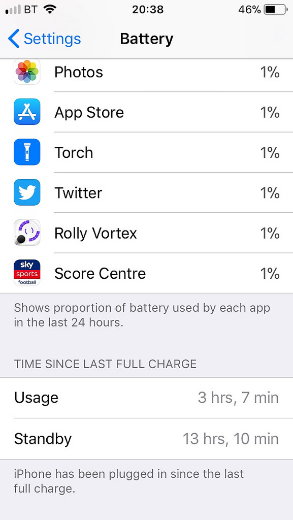

Mine stays at 100% for ages then goes down quicker once it reaches 99%, is this normal ? iPhone SE brand new

Always have to calibrate the battery of a brand new phone. Let it run down to under 9% twice in fact / then you’ll see improvement in meter.

That actually is normal and will always be the case, as Apple’s software will always say 100% when in reality the battery is charged between 95-100%.
When you leave it plugged in once the battery indicator shows 100%, it trickle charges up to 100% then slowly discharges to 95%. It will do this back and forth until you unplug your device.
You can test this with CoconutBattery on a Mac. This is the reason why many times your phone will stay at 100% for an hour and then drop faster. Also the reason why sometimes your battery indicator goes from 100% to 99% as soon as you unplug it. Just depends upon what point the trickle charge was at when you unplugged.
