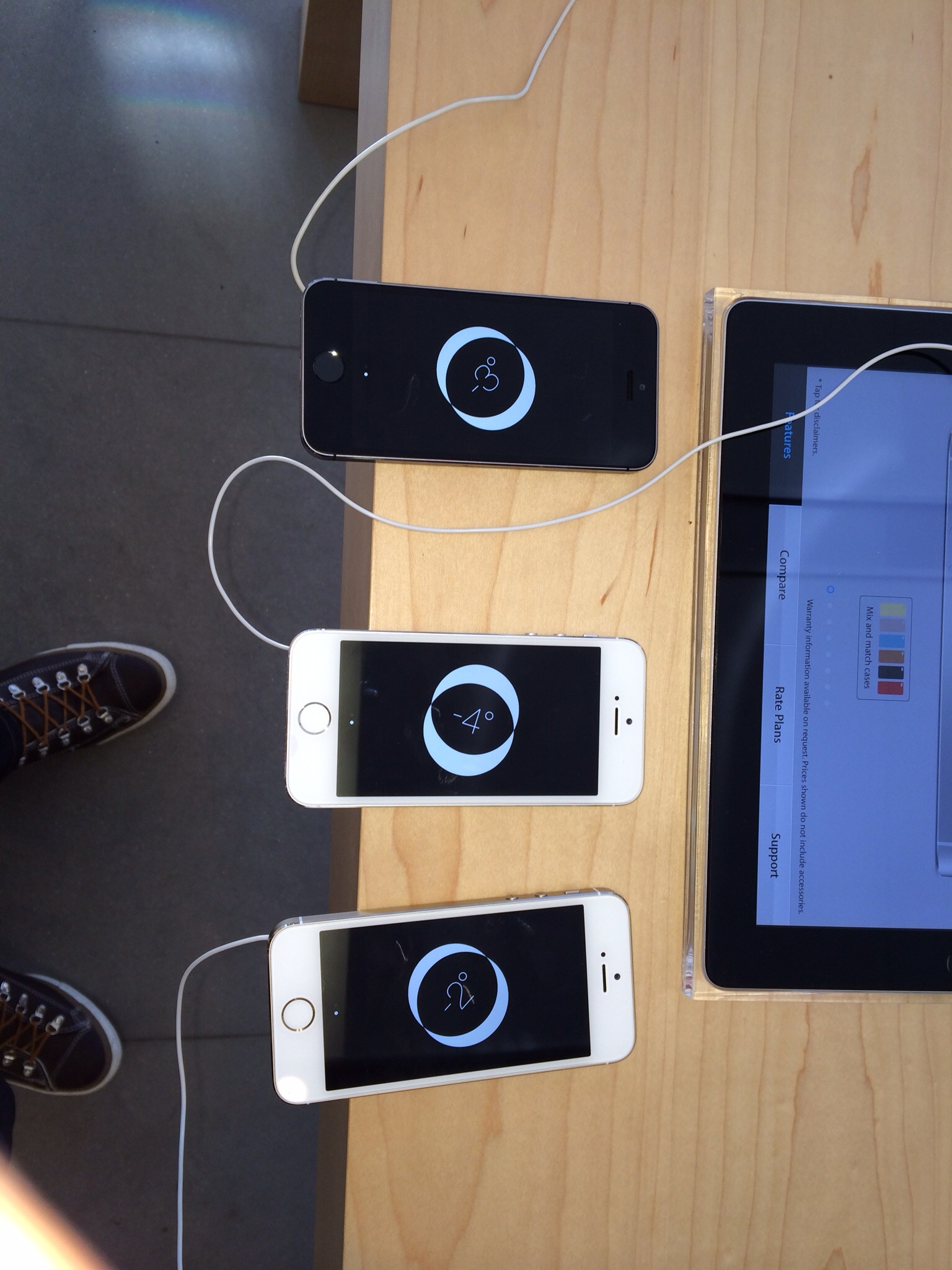

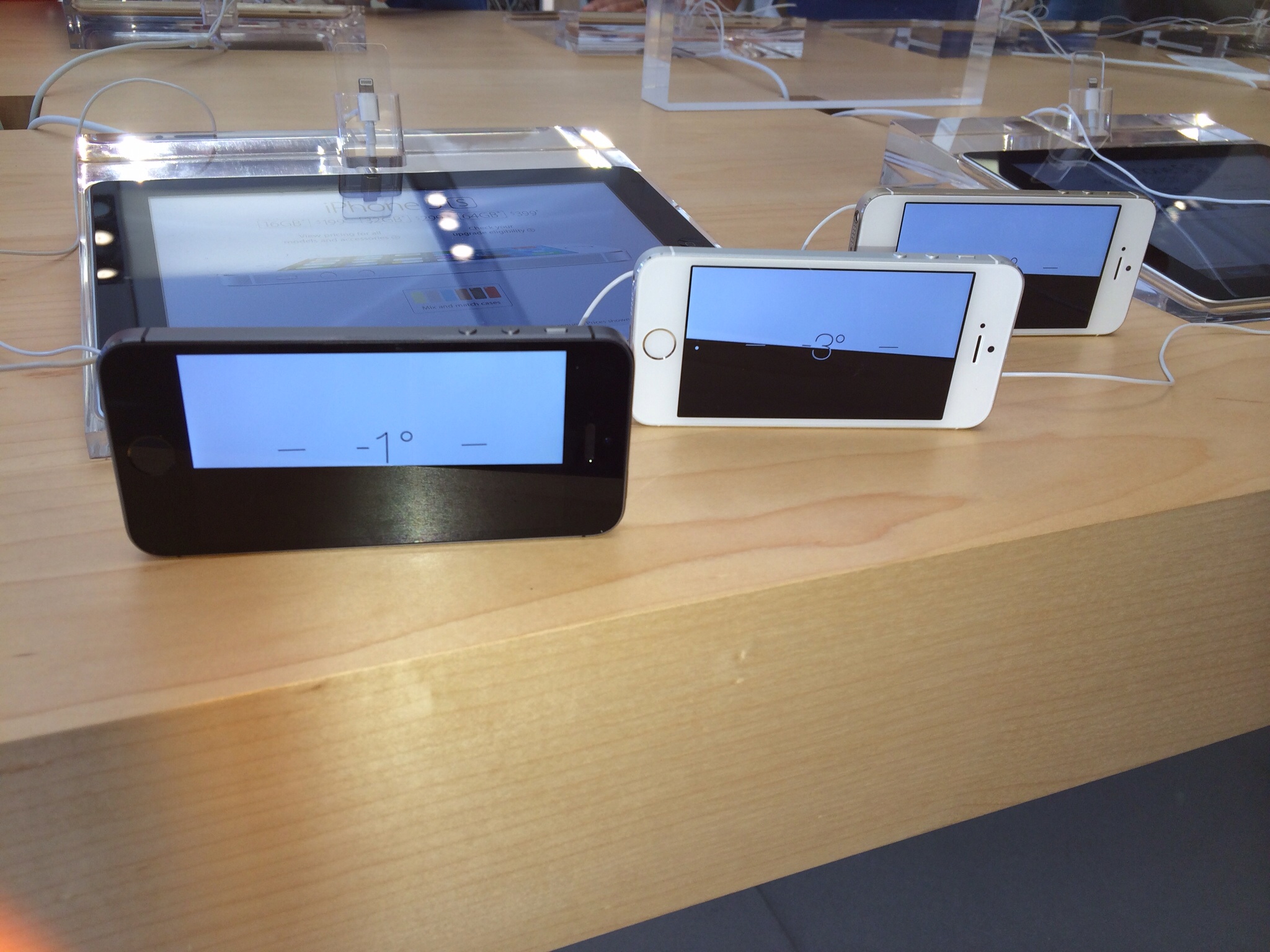

possible that I am missing something. dunno, I see a lot of people going 'mine's off by 4deg" "mine is 6!!" "mine is 2!! wtf".. that's what the picture in the OP is showing too.
is that not giving flying fs about accuracy?

My compass is off by about 12 degrees after performing a calibration. The compass also seems to easily get interference. It is quite often off by random amounts. In one instance it was off by 180 degrees.
The level is off by 4 degrees when the 5S is placed on a known level surface. An iPhone 4S placed on the same surface read zero degrees.
iPhone 5S 16 GB space grey
iOS 7.0.2

Just went to 2 apple stores one in San Francisco and one in Corte Madera EVERY single iPhone 5s and 5c was off...EVERY SINGLE ONE! I showed them the problem and I had them replace my phone 3 times still not working properly I'm off by 5 degrees will try again at walnut creek on Sunday
