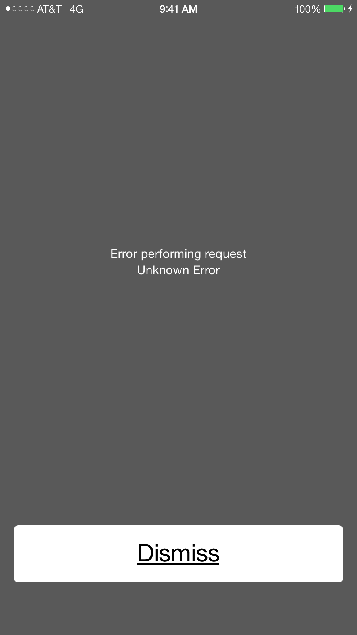

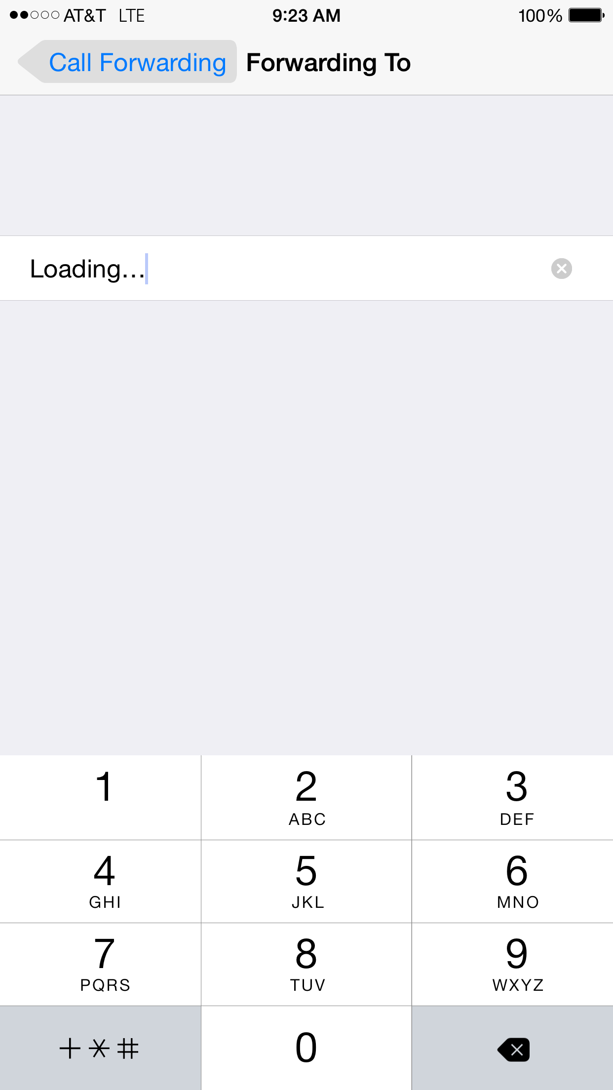

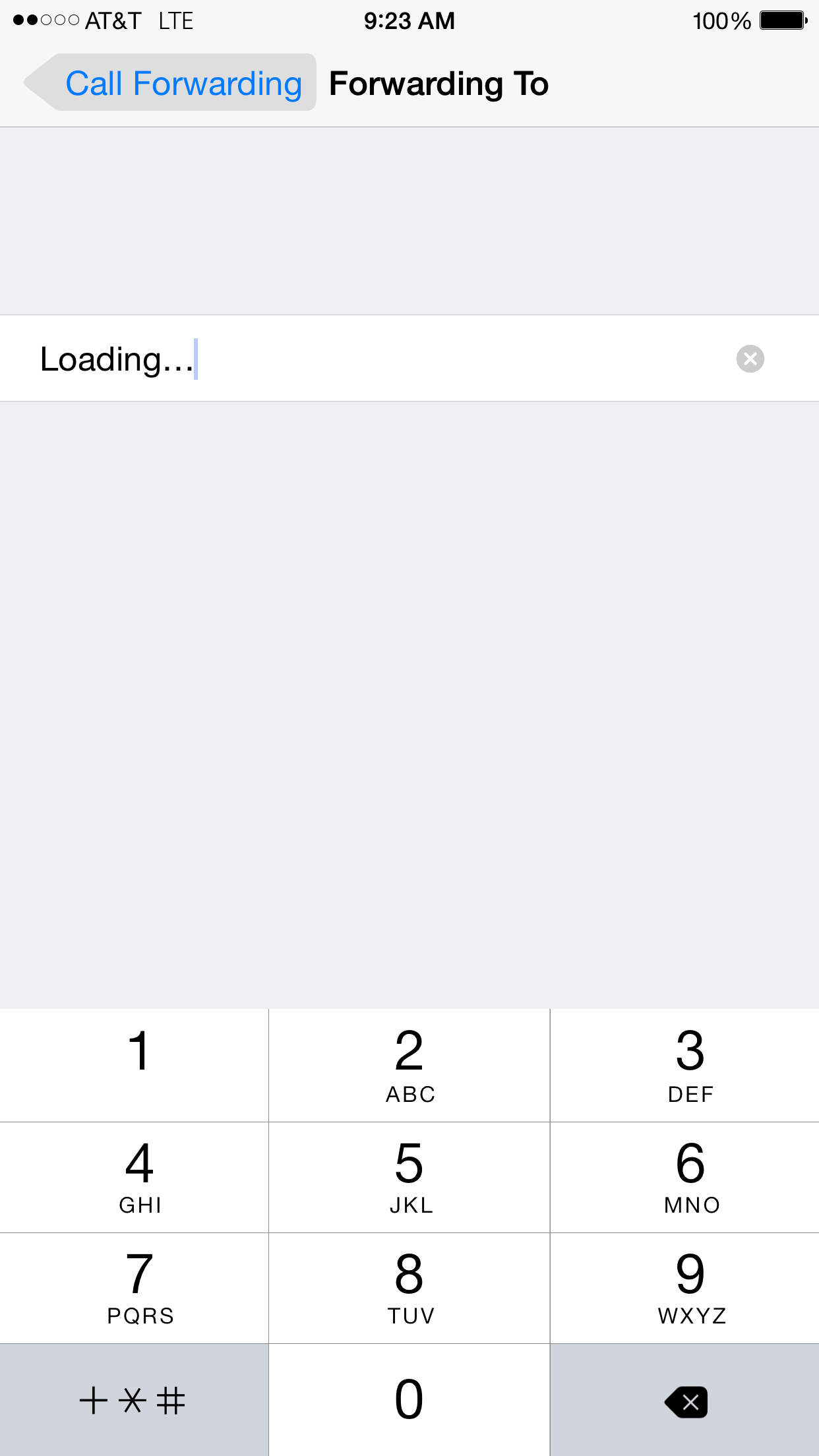

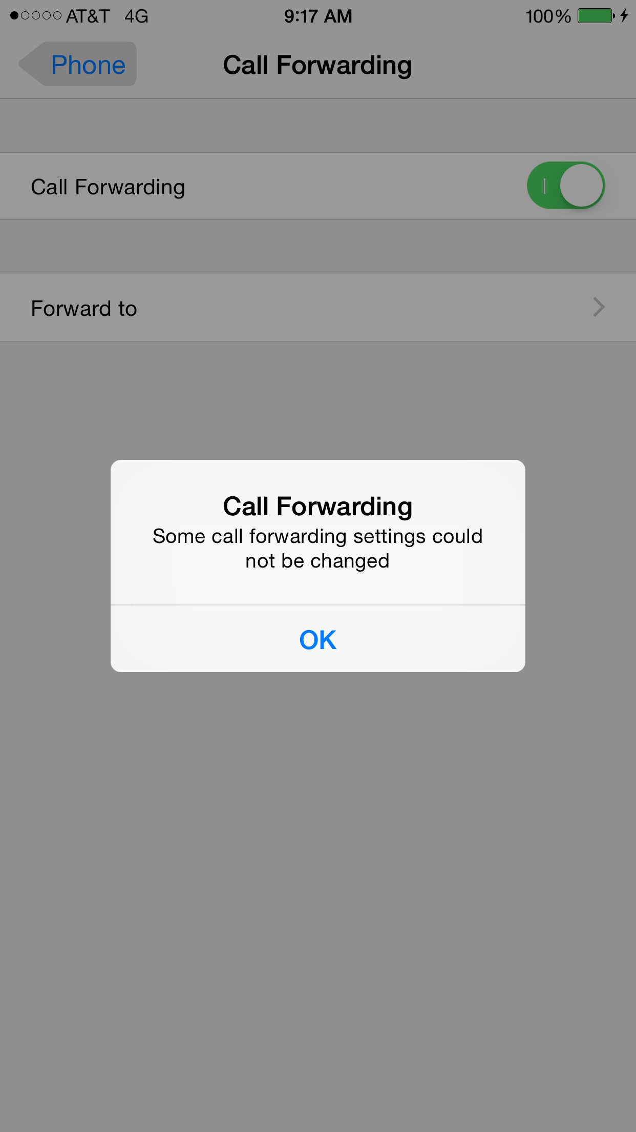

Hello,
I was curious if anyone uses call forwarding and/or call-waiting with AT&T?
Using an iP6+ and noticed when I turn either option on-- exit out and then go back, it is off again. Further, when I try to enable call forwarding it cannot update/fails to update. I also tried the **21*num# method and that way fails too. Was curious if anyone had seen this before?
- I've tried resetting network settings and to no avail. AT&T said they have never heard of that problem before.
Thanks,
Justin.
Attached are the screenshots of the errors:

Hi-- yup on iOS 8.1 also did a complete wipe, erase all content and settings, to no avail, will follow-up with AT&T, thanks.
Problem solved.
Problem SOLVED 10/23/2014!
So I moved the SIM from my iPhone 6 plus to my previous iPhone 5S, I was able to see the forward when AT&T set it for me (I asked them to because I needed it forwarded and was unable to do it). When I put the SIM back in my iPhone 6 plus it showed the forwarding icon on the top left; however, I could not update it.
So then.. there was only one last thing (I thought) it could be.. I asked AT&T to update the IMEI of the new iPhone 6 plus, when I checked with AT&T—it was still tied to the old IMEI number of the iPhone 5S.
Once AT&T associated the new IMEI with the (account/SIM?)—per AT&T I powered off the phone and turned it back on and voila problem fixed and everything is working!
I hope this helps someone if they transfer their old nano SIM from an iPhone 5/S to a 6/6plus and runs into this issue!
Justin.
