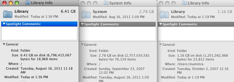

SATA alone is a significant improvement. Its an extra 50MB/s, less latency and less overhead from the OS. An SSD isn't so much about the raw MB/s but the access time. Any modern HD will have no trouble saturating an SATA-1 channel on large transfers.
An SSD will completely transform the machine. You're going from 7ms delay to 0.1ms delay. OSX has over 100,000 files in the system folders and an SSD will make the system's access to the files far quicker.
