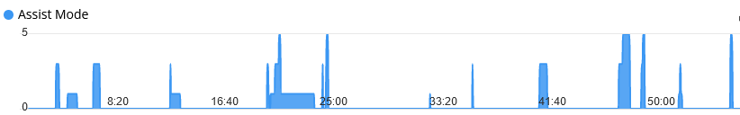

I ride a Specialized Creo (e-roadbike) using the motor to take the edge off hills and spend a lot of time with no motor assist. The bike measures how much power I provide at the crank and relays that data to my Garmin Edge, giving my actual measured "work" in kilojoules. I also often record an outdoor cycle on my watch, which is estimating power from gps/speed/HR/etc but no direct measurement of power.
Three recent rides:
12.5 miles - watch said 605 active calories - garmin/bike said 374 kJ work (active calories)
23.5 miles - watch said 1164 active calories - garmin/bike said 704 kJ work (active calories)
12.6 miles (diff route) - watch said 574 active calories - garmin/bike said 345 kJ work (active calories)
As mentioned, I don't use the motor a lot - so I can imagine the overestimation might be substantially worse if I used the motor a lot more. Here's an example of the amount of motor used - time (minutes) x assist mode (0/1/3/5)
