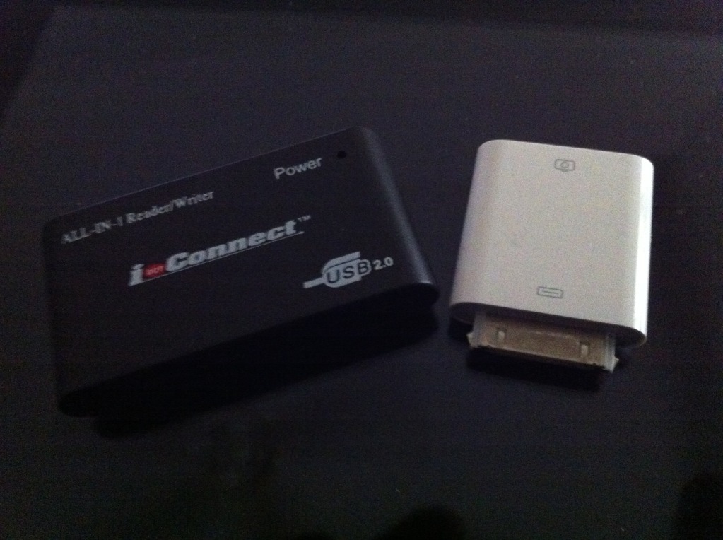

Does anyone have any readers that works on the iPad and has a MS Duo XG slot on it.
iDOTConnect All-in-1 usb 2.0 Reader/Writer
I bought it at Fry's a couple years ago. It even has a compact flash port.
