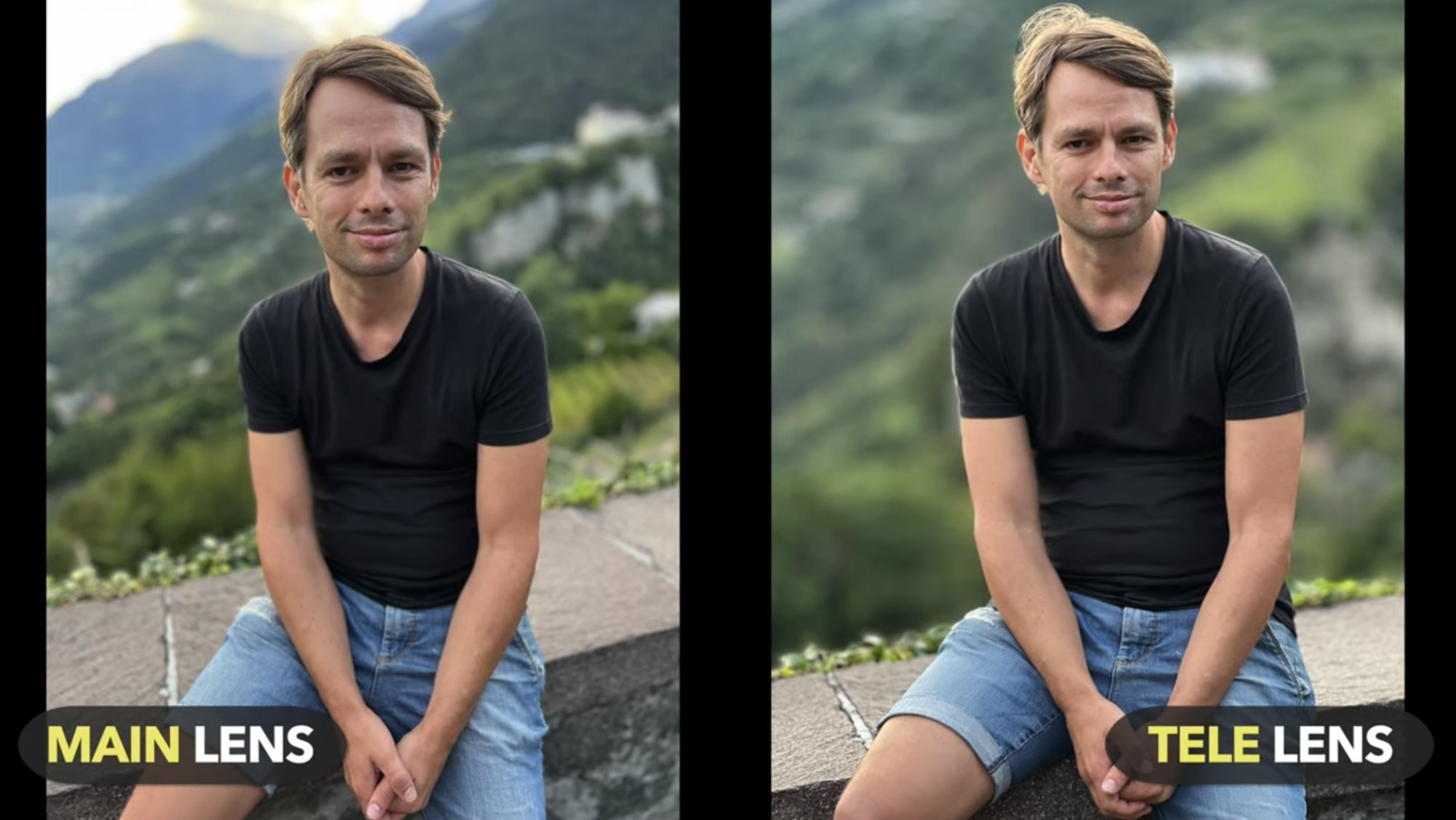

Just bought an iPhone 15 Pro! Loving it! On some of my photos, I have noticed a distortion. Like squashed up heads. I have included this photo I found from a YouTube video (@MountMedia). It’s exactly the same as this. I take pictures of my child and I hate that it does this in some photos. Never had this issue with my 13 or 14 Pro. I can’t understand why it’s doing it. I am using default settings at heif at 24mb. Is it anything to do with the 22/28/35mm options? Currently it’s set to 22mm.

Completely normal optics. It’s how lenses work based on how close you are to a lens. The closer you are, the skinnier your subject will be. If you take 2 pictures from the same distance and crop the non zoom lens to match the zoom lens, the proportions will be the same. What you have done here is backed up for the zoom photo and then moved in closer for the non-zoom photo to get a similar shot. A good experiment would to be put on your .5 lens and take a picture super close to your face. Look how skinnier your face is. Then put on the normal 1x, do the same. You will see it’s just a zoomed in version of that super skinny version of your face.
This video explains it pretty well.
Can I DM you the picture in question? I don’t wanna put a picture of her on the net. Was hoping it’s possible to fix it.
I second that, that's exactly how it is and it's pure optics.

The issue still falls back to the iPhone 15 camera is wider angle than older phones. if you frame subjects the same as you did with older phones, you will get distorted images on the edges. On older phones you would naturally, physically back up, removing the distortion. but It's not the phone or setting, but the lens that apple is using now.

This is all pure physics. If you get a wide angle lens on a professional camera you will notice the same effect. And the 1x lens of the iPhone 15 is basically wide angle already. And it needs to be handled as such.

There are a lot of uses for ultra wide lenses (traditionally anything wider than 24 or 28 mm equivalent). But shots of people aren't usually one of them because of the perspective distortion already mentioned. I would use a 35 or 50 mm lens for wide shots of people and something like an 85 or 135 mm for headshot portraits.

There's more to it than just the focal length. The angle between the image sensor and subject also influence the level of distortion, as does the placement of the subject in the frame. Objects closer to the corners of the image are more likely to look distorted with a wide-angle lens. As for the angle bit, imagine two flat planes, one extending out from your phone (or camera) and one where your subject is. If the two planes are completely parallel, you minimize the perspective distortion. But if they are at an angle to each other, then you'll end up with more perceived distortion. This is often considered in architecture photography (see images), where pointing the camera up or down will cause building to look distorted but holding the camera pointed parallel to the ground will reduce this. The focal lengths in the image are not the cause of the perspective distortion, it's the angle of the camera to the subject.
