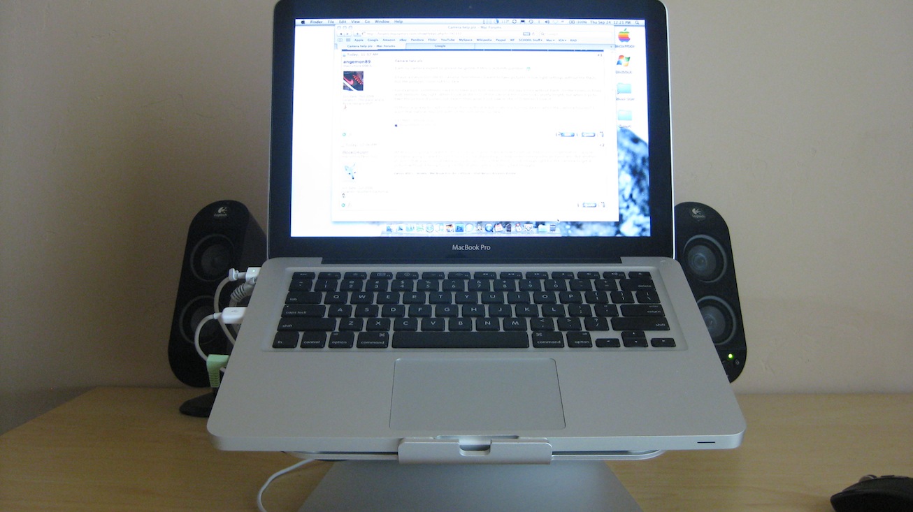

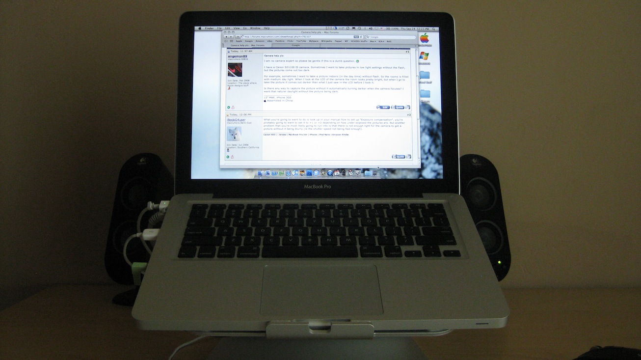

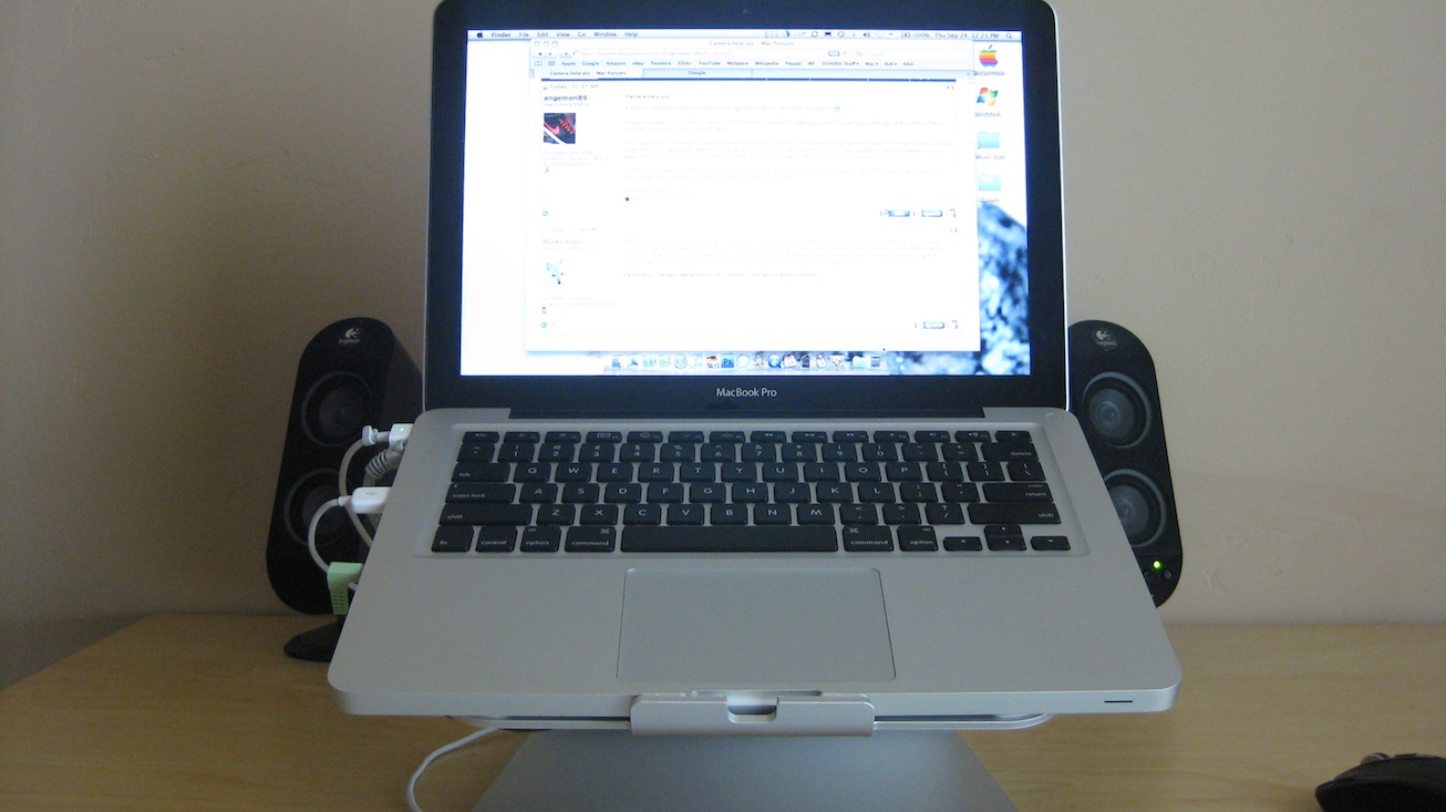

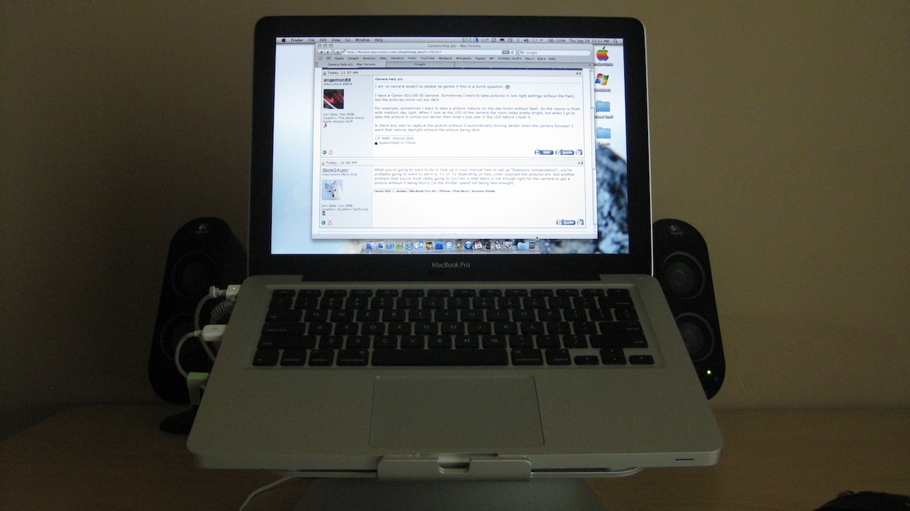

Awesome, I just took some test pictures with the exposure at 0, then at +1. It came out much nicer at +1. Thank you sir.

In the images you attached, if the camera was set to center or spot metering, it almost certainly would have taken a reading from off your computer's screen where it's bright. If you had it set to evaluative metering it still would have been heavily influenced by the screen, but at least would have taken some of the rest of the room into consideration. If you spot metered off the wall where it's darker you'd get an image closer to the second attached photo, the screen is overexposed, the room looks properly exposed.
