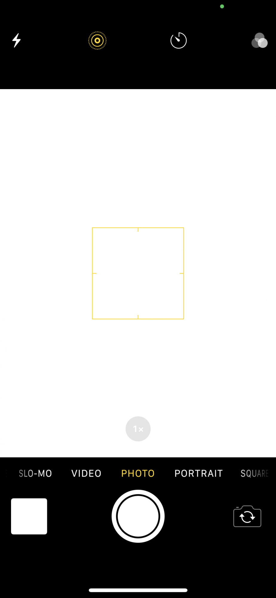

Today I accidentally dropped my iPhone X at the gym. The height was less than 1 meter. The phone landed on the back. It didn’t suffer any external damage, nothing is broken. It was in a thin silicone case, and also had a screen protector.
However, I noticed that when I try to take a picture, there is no picture. All I get is just a white picture.
My question is - is it really possible that a fall from less than 1 meter could have caused some internal damage?
* Front camera works fine.
Yes, it is possible. If I am not mistaken, I have read about this very problem with the iPhone X on the forum years ago.
If a reboot, reset all settings, erase and set up as new doesn't solve the problem, you are probably looking at a hardware problem. Given what you described. I don't think your chances are good with the typical user options. I hope I am wrong.
It's possible the drop may have loosened or disconnected the rear camera connector.. Not sure if you're ok with opening the phone up to check the connection but there are many YouTube videos showing the procedure.
