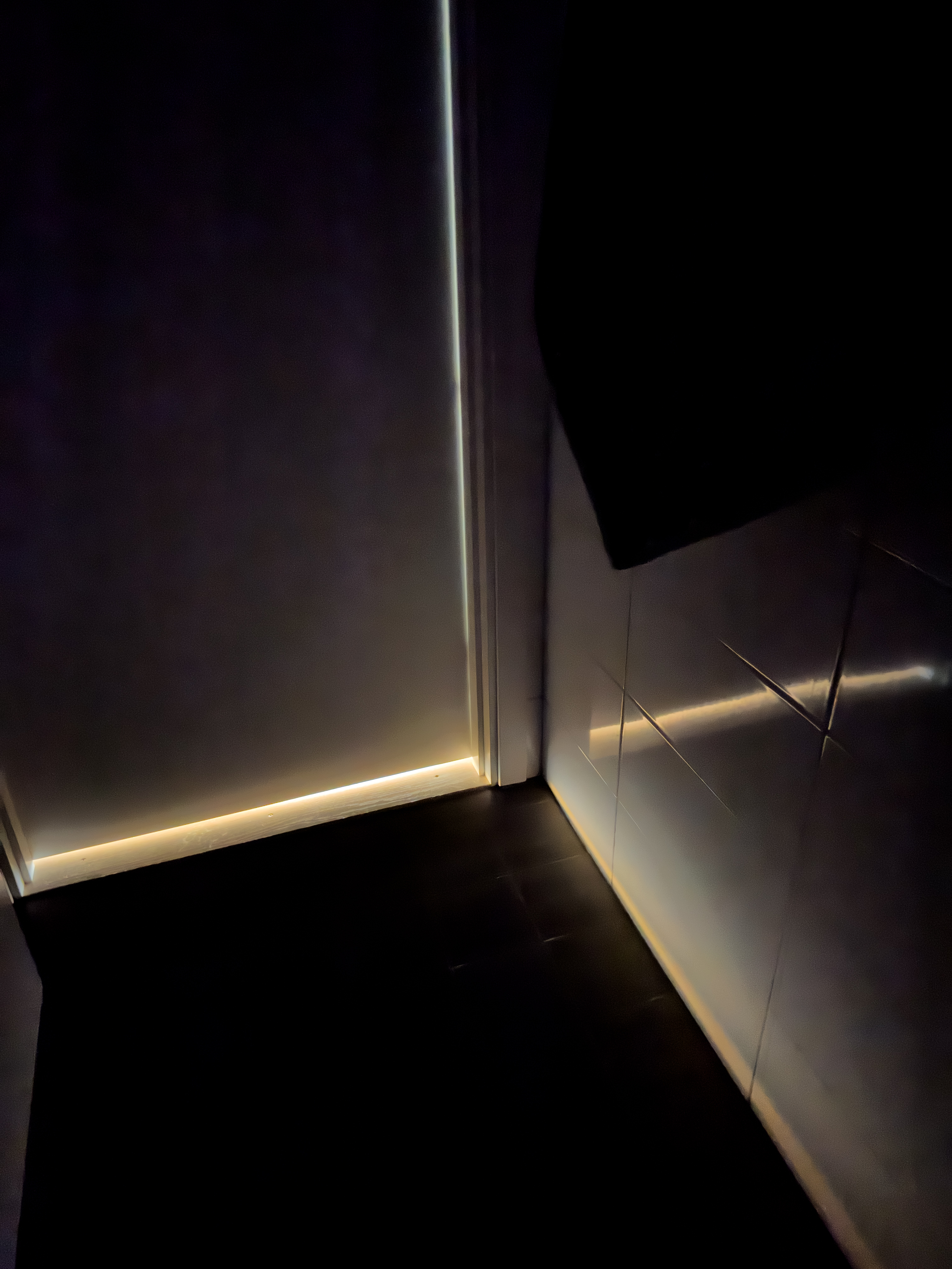

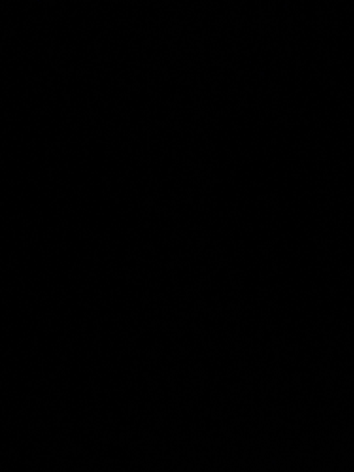

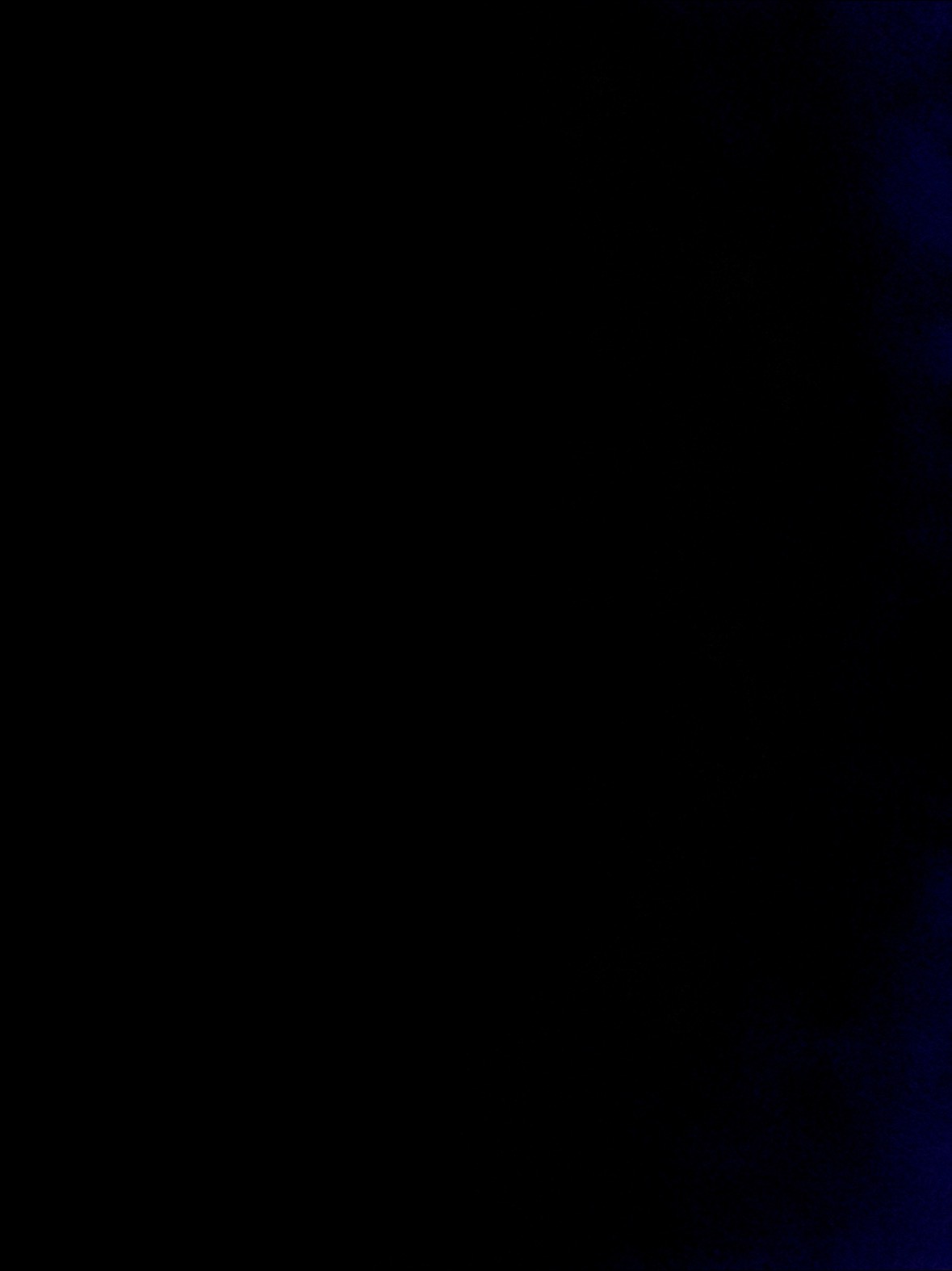

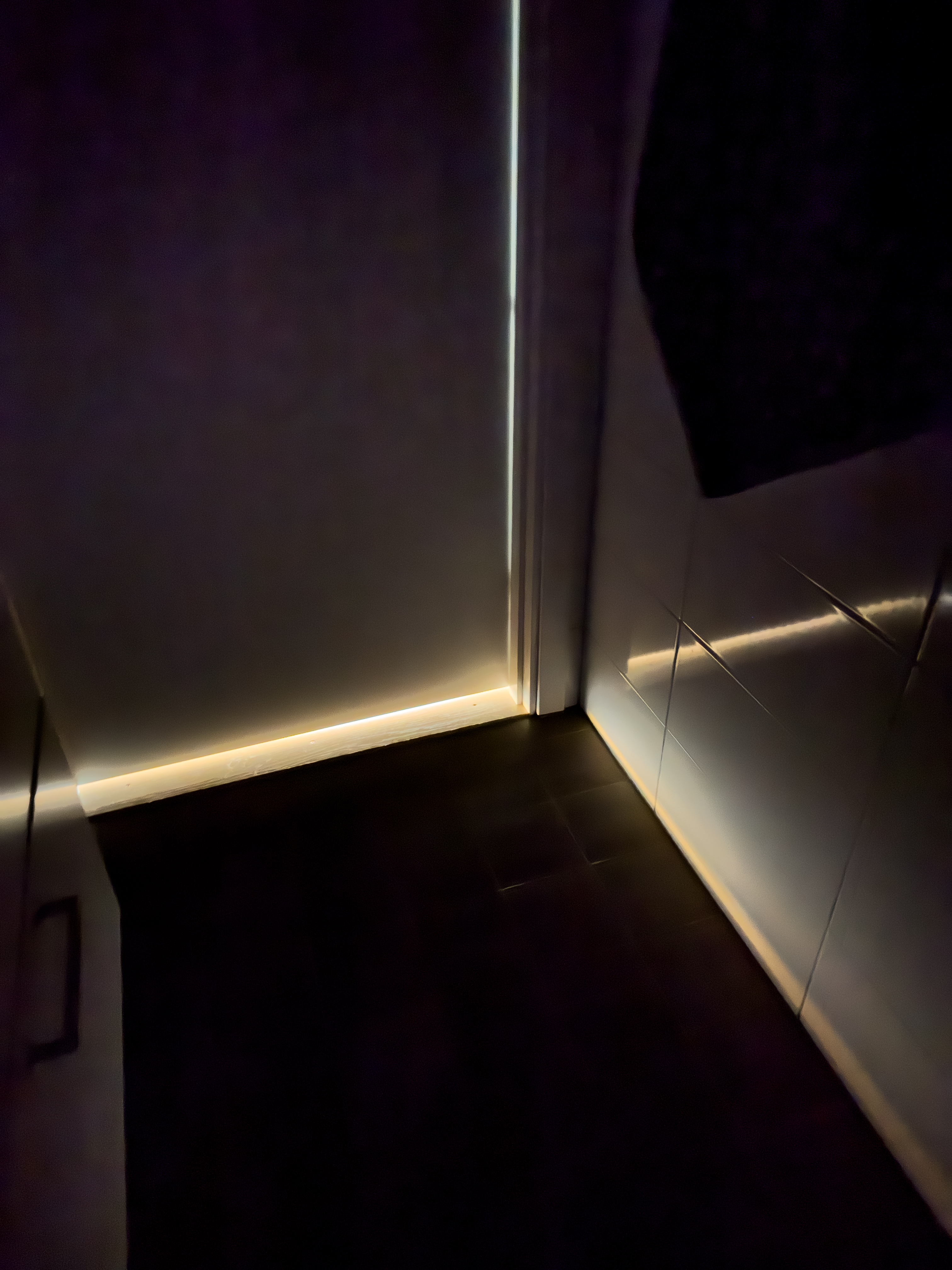

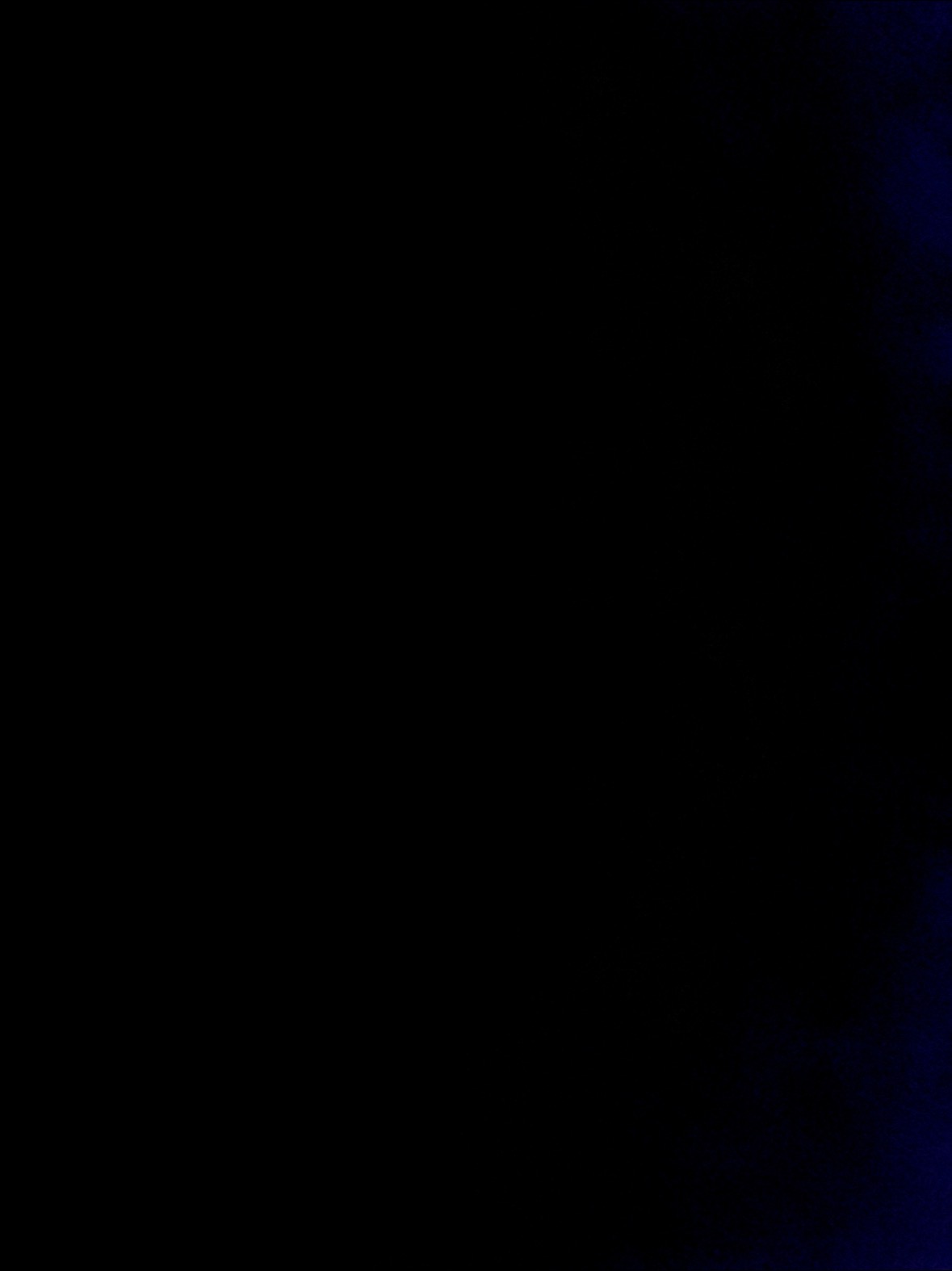

But hmm. I did try to replicate the same scene on my phones (16 Pro Max and 17 Pro Max) and both show some odd artifacts that I haven't seen before.
It seems that the complete dark room in combination with the bright light shining out though the gaps in the door create a very tricky condition for the camera.
I've shot thousands of astro shots with this 16 Pro Max and never seen any such artifacts before.
My new 17 Pro Max is probably a little better.
Apple iPhone 17 Pro Max (Stock camera, 1x, 24mm, 2s, f/1.7, ISO 6400, 12.19MP)
Apple iPhone 16 Pro Max (Stock camera, 1x, 24mm, 2s, f/1.7, ISO 6400, 12.19MP)
Looks like processing (SW) issue - in my case they have ruined it since iOS 18.2 and never patched it since. Strange that your astrophotography comes out alright though.
I think it is some kind of scene detection that really tries to boost shadows too aggressively.
Most likely the reason why some users now see the blue streaks/clouds in pitch black on units that was previously unaffected.
That's what I have noticed on my 16 Pro too (when I'm doing this test). Didn't remember looking like this.

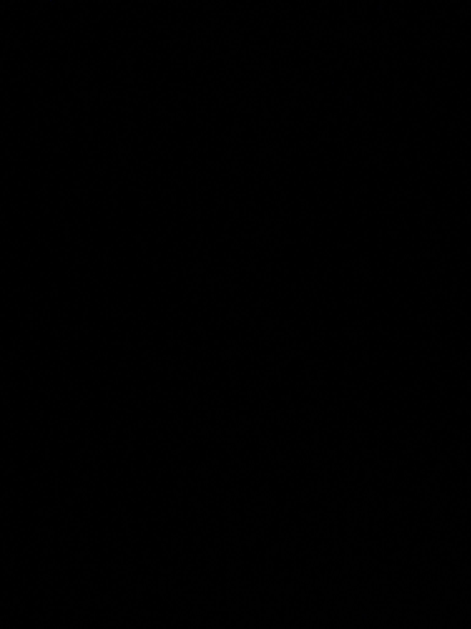

I can confirm that the issue is not present while using the ProCam app for long exposures in a pitch black room.

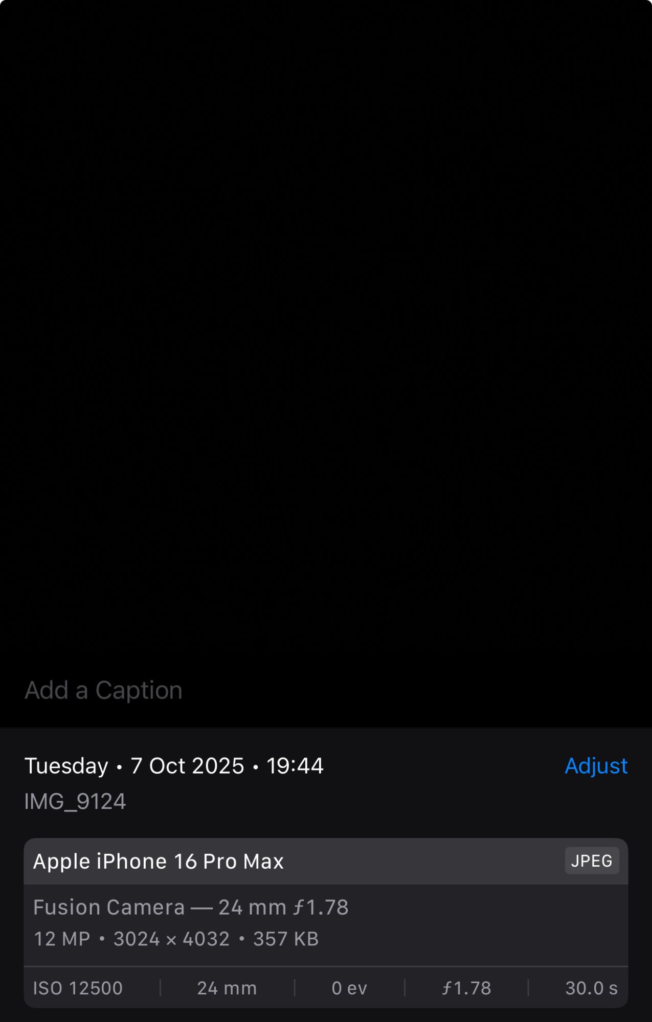

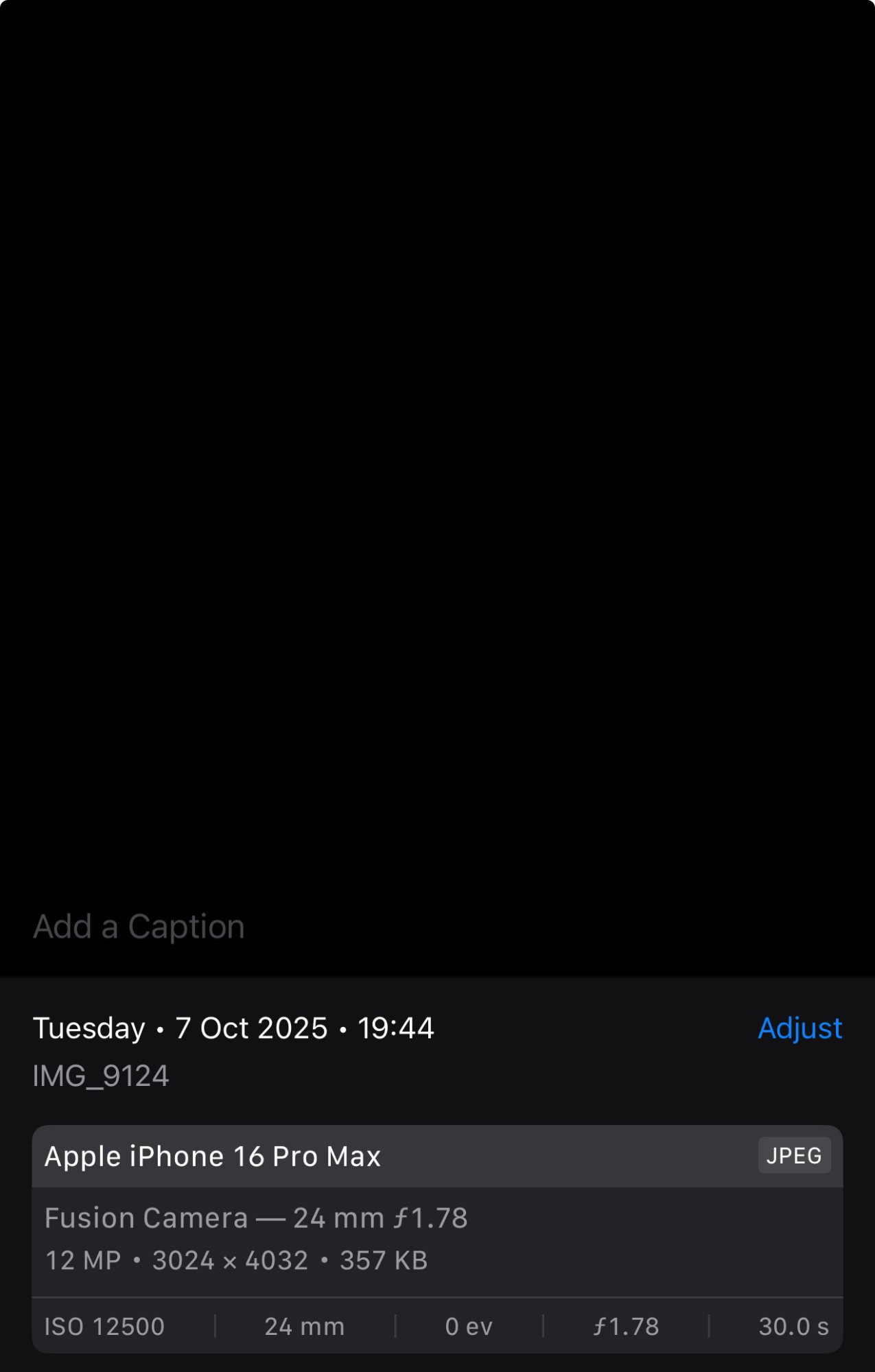

ProCam: “Slow shutter” mode, Low Light, ISO 12500, exposure 30 sec.
Great result!
The only difference I can see is that you have ev value 0 whereas stock camera gives usually 3.7-4 ev in complete dark conditions. Not sure if it matters in this case.
Reactions: nickelro
Great result!
Yup, I noticed that too. Will look into it these days, maybe there is a way to manually increase the exposure value to match the ones from the default Camera app.
Reactions: GloryNox
If you do that, you will enhance artifacts that are not meant to be seen. That is the reason why the tabletop test does not work. The camera will attempt to recover detail in complete darkness and just show the sensor interference instead.
