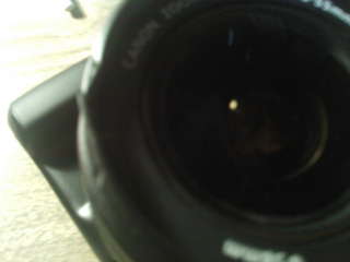

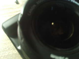

No major harm was done.
But I'm still pissed. I'm a (broke) college freshman who is very meticulous about her things. While they were gifts from my parents, they were worked hard for (I got good grades, did right, they were proud of me so they rewarded me with my DSLR and a MBP). I'm even careful with my crappy dumb phone.
My mother is always complaining that she never gets any pictures of ME. We are having a function tonight at my college, I gave the camera to a friend to get a couple shots of my outfit. She says here, take it, I need to go get ready and hands it to me. The strap is still around her wrist, I didn't have a good grip, she snatches the camera out of my hands and it hits the ground.
I've attached the crappy shot (taken by my dumb phone) of the little dent on the lens. Every time I see this, I'm going to be pissed. It wouldn't be so bad if I had done it.
I just needed to rant about this to someone who would understand. :-/

Check the sharpness of the lense (pop it on a tripod, and take photos of a newspaper that fills the frame corner to corner). Do this at a wide open aperture, a closed closed aperture, and one in the middle. Expect to see some unsharpness in the corners, this is normal and changes at different apertures. Just check to make sure that it's not terrible.
If the lense checks out, and it probably will, then be thankful it wasn't worse. I had a camera tip over up near Cambridge Bay, that broke the filter and dented the front of a wide-angle lense in 2000. Basically it badly dented the filter rings. I was royally p*ssed off, but couldn't get it fixed at the time. Then I just accepted it, and finally got it fixed last year..... when I got tired of not being able to use filters on that lense. It's the mark of well used camera. But the first ding is always the hardest.

No tripod, but I took some shots tonight at the function on a bunch of different settings and everything is okay.
She's offering to give me about $50 towards my next lens. I told her I'd have a hard time accepting it, since it is only a little ding. She said well I'll just slide it under your door one night (she lives down the hall from me) so we'll see if she holds up to that or not.
That isn't too bad, I have seen worse! Unfortunately it was the worst part to his the ground. If it still works well, don't worry about it 🙂
New lenses can be extremely expensive so save up for a new one and do your research 🙂
