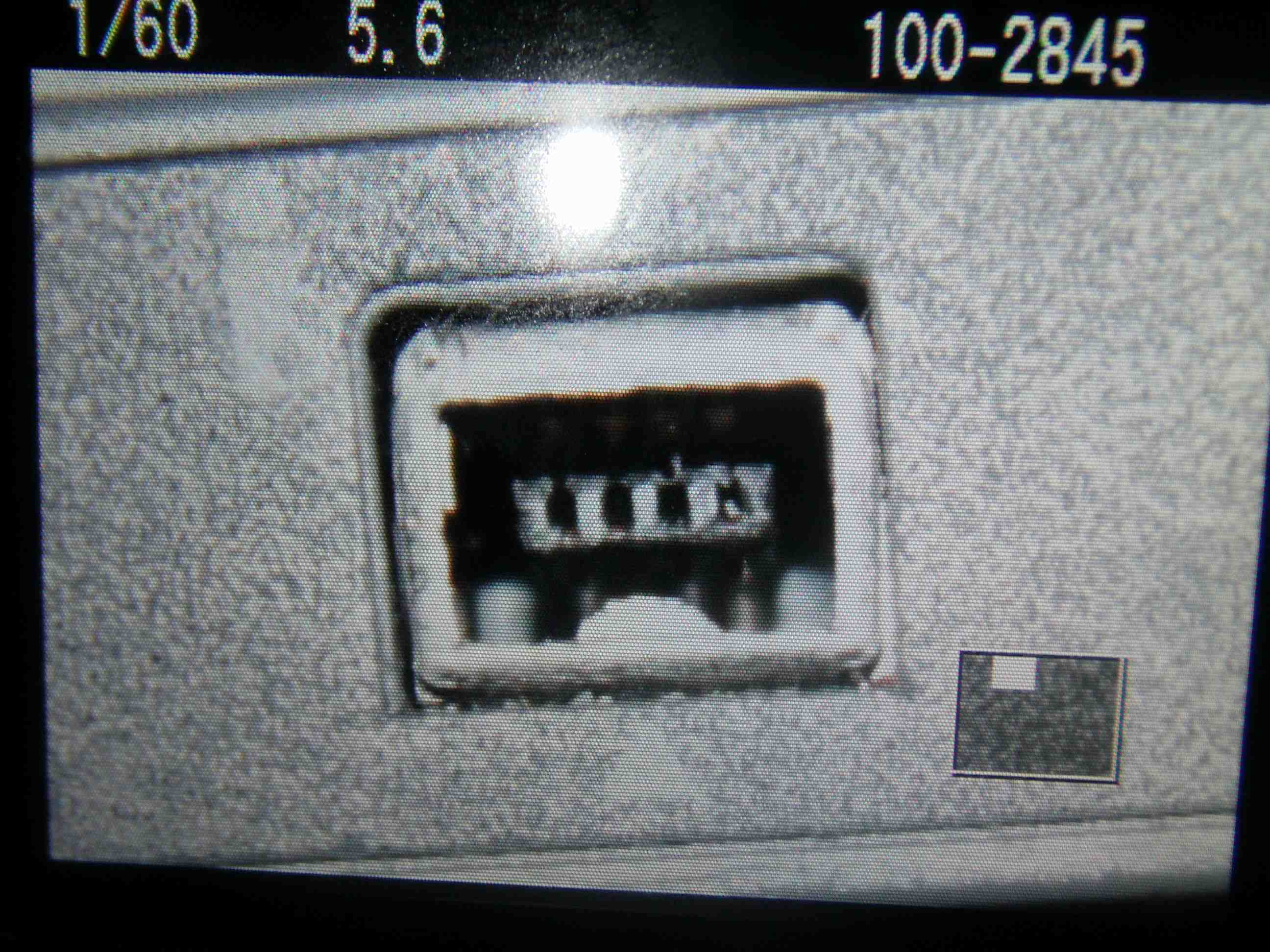

Ok heres whats happening.
I got my sisters DV Camera and with ONE of the shorter cables it didnt say no info in system profiller and listed the blabber speeds upto 800mbs. Now. With the new cable it says no info. And when i use the supposidly GOOD Small cable with my sony dcr hc22e it still doesn't pick a signal up even though my camera does.
Below I attached a pic of the firewire port on the deck. XD

Also make sure your looking at the 22E manual because i know the DCR-HC21 has a DV port on it.
Yep. I was looking at the appropriate manual. It couldn't agree if the camera had the port or not.
I wonder if there might be a menu item on the camera to set i.Link up. Also, make sure you are in VCR or PC mode.
It is possible that one of a few things are messed up. The port on the Mac, the cable, the port on the dock, the camera connection to the dock, etc. Diagnosing it may be very difficult.
When i first imported my video ages ago via PC. I set it to play mode. Then it said DV-in on the camera a few mins later my pc picked it up. I read on the internet that sometimes the firewire port are very sensitive to shorts
