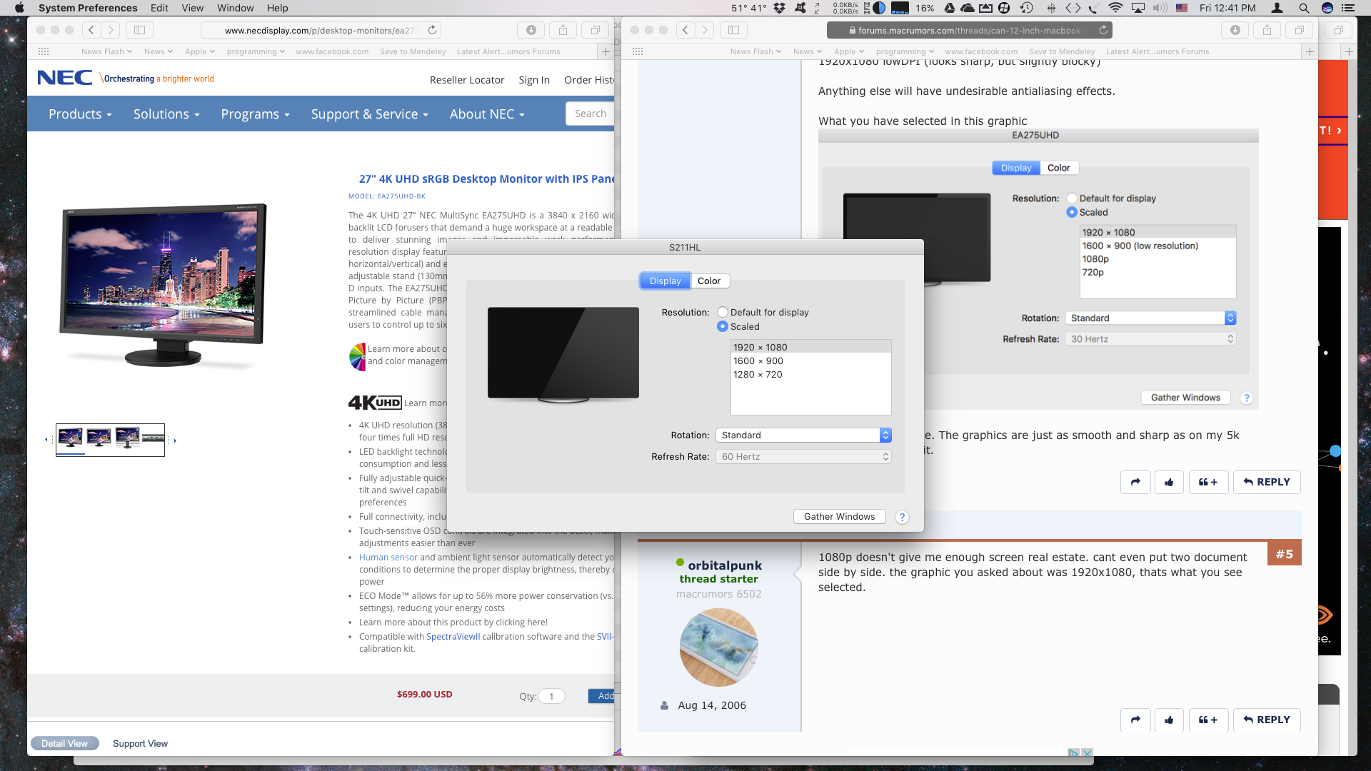

Could you post the relevant screenshots? Also, note that "4k" isn't always 3840x2160.
You can see here in the resolution options how anything above 1080p does not have HiDPI
Here is a screen shot at 1600 x 900. Its fuzzy
Here it is at 1080p. Its sharp
Here are two resolution switching apps and they also show that anything above 1080p excluded HiDPI

The way I see it, you have three choices for resolution.
3840x2160 (looks small-- this is the native resolution of the display)
1920x1080 hiDPI (looks smooth and sharp, like a laser printer)
1920x1080 lowDPI (looks sharp, but slightly blocky)
Anything else will have undesirable antialiasing effects.
What you have selected in this graphic
should work just fine. The graphics are just as smooth and sharp as on my 5k iMac, so just enjoy it.

1080p doesn't give me enough screen real estate. cant even put two document side by side. the graphic you asked about was 1920x1080, thats what you see selected.

Could you post a screenshot of the entire screen?
(command shift3)
This is from my 1080p secondary display. lodpi, of course, but the proportions should be the same as on your 4k display.
Now, if the control panel takes up vastly more space, there's a problem.
