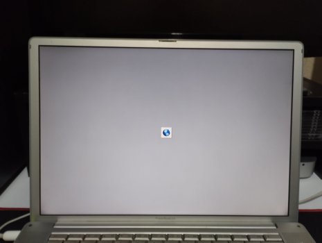

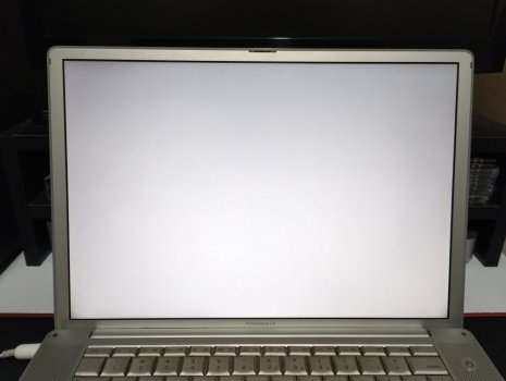

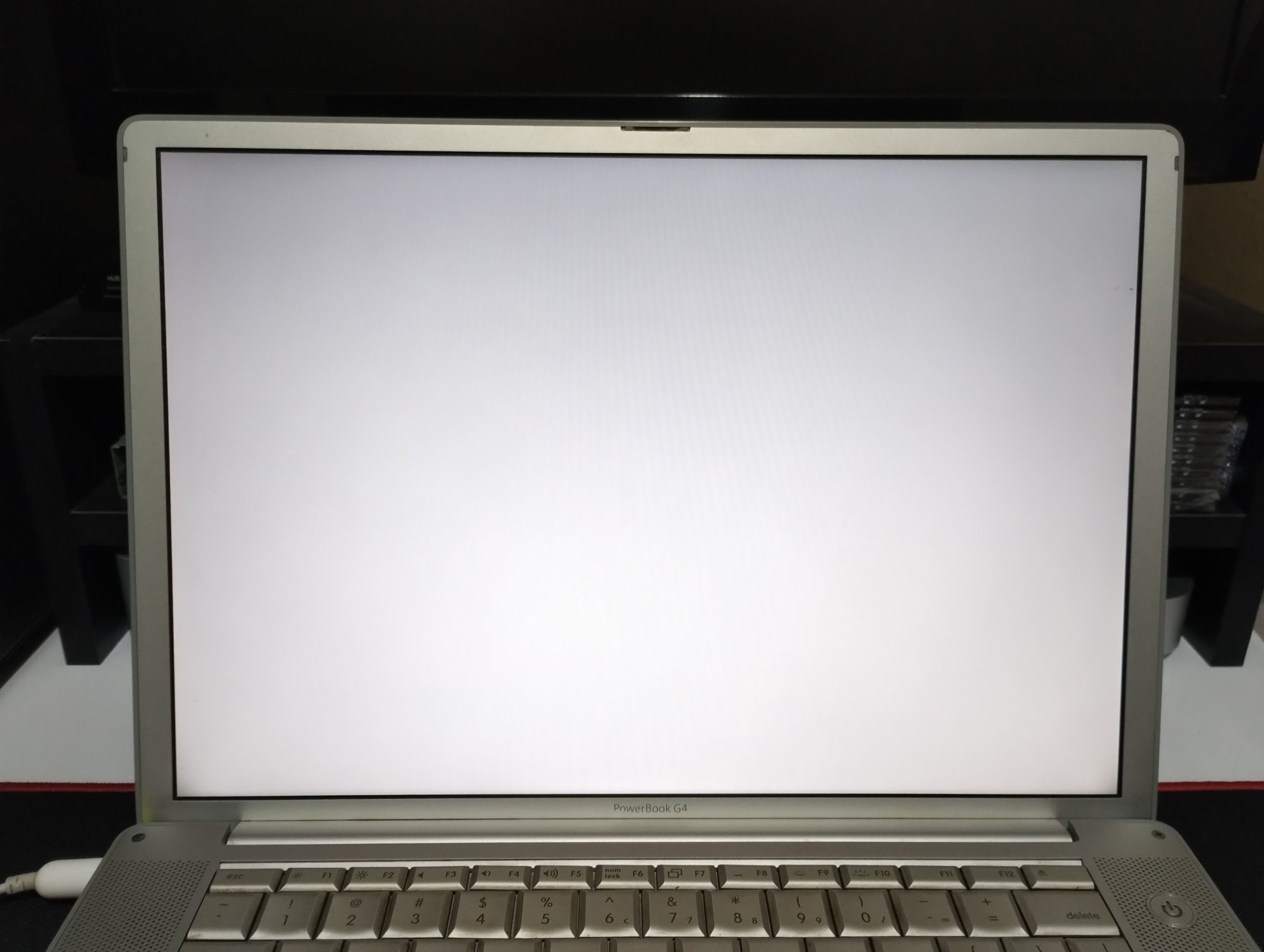

The PowerBook arrived yesterday and guess what, I got lucky! It's a DLSD, A1138. As soon as it arrived I went to test it. It came without a charger, so I grabbed a 45W unit from one of my G4 iBooks. Although the charging indicator turned green (the battery is dead, as expected), it didn't turn on. I then tried a 65W adapter from a 17" PowerBook, and... it turned on! But, this was the furthest that I got... Upon turning on, it didn't chime, and got stuck on a white screen. No Apple logo, no prohibitory sign, no question mark, no nothing.
I could hear the hard drive seeking, but after 30 seconds or so, it stopped. I tried to leave it on for a few minutes to see what was going to happen, but after about 5 minutes it rebooted itself and did the same thing again.

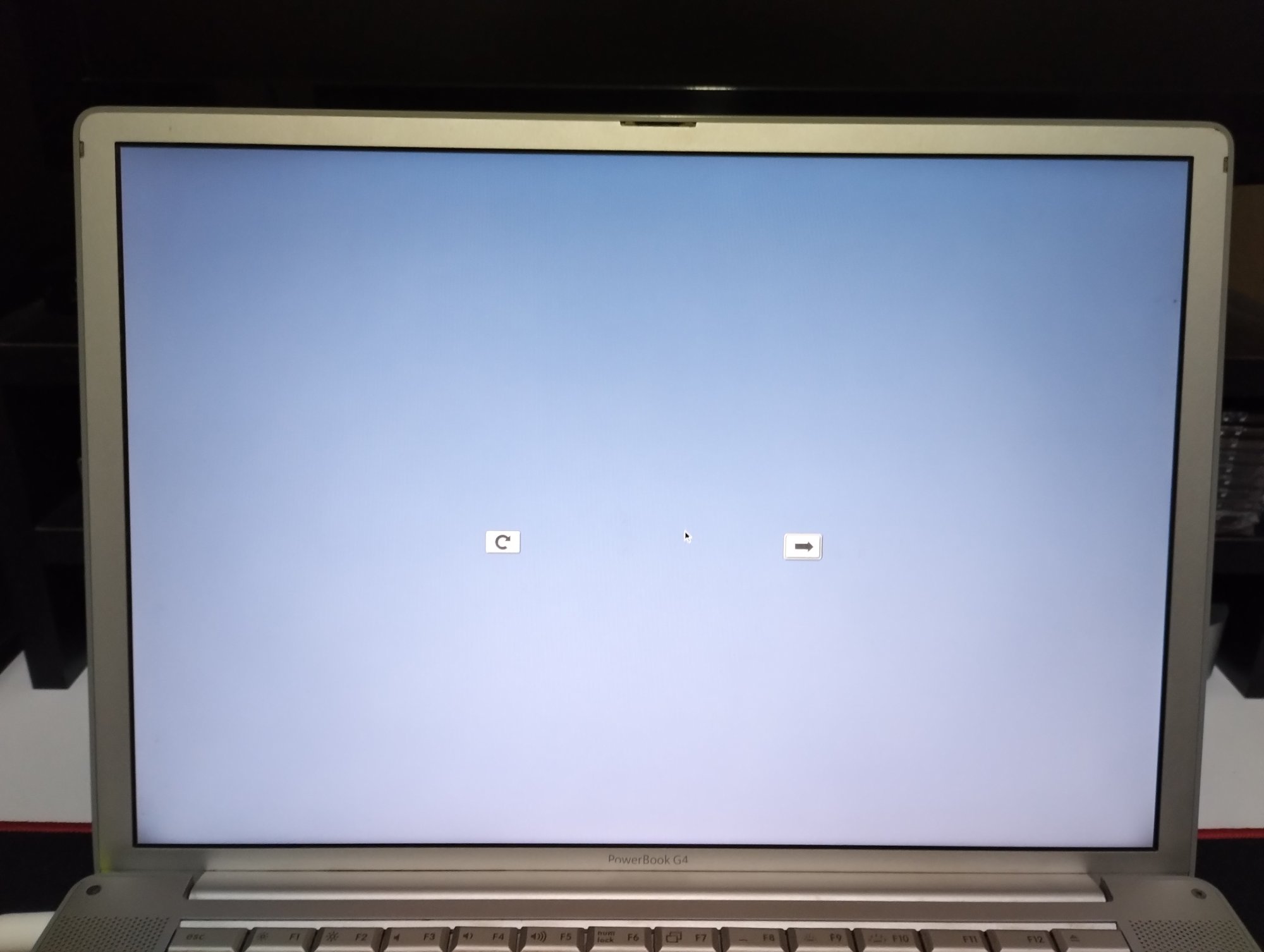

I then tried to boot into the boot picker, and it worked. It showed no bootable partitions, so I tried putting in a known good retail Tiger installation DVD (I know the DLSD needs 10.4.2, but I wanted to see if it could at least read the disc). Like the hard drive, I could hear the DVD drive working, but it also didn't show up.

Hey guys, I'm back. So, I tried all the suggestions, but to no avail. I then tried an old external FireWire drive that I have, but the PowerBook just wouldn't see it, including the boot picker, even though the drive worked just fine with other Macs.
After that, I tried Target Disk Mode, connecting the PowerBook to an iBook G4 running Tiger. System Profiler on the iBook could see that a Target Disk device was connected, but the hard drive itself did not show up.

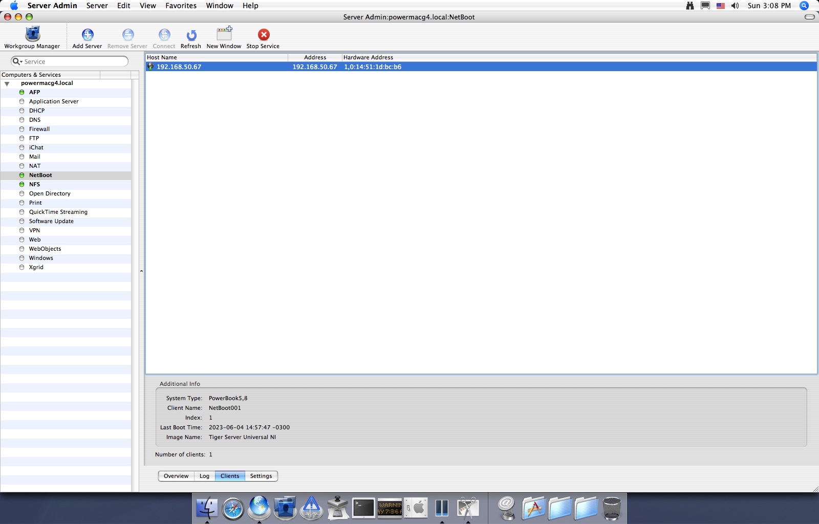

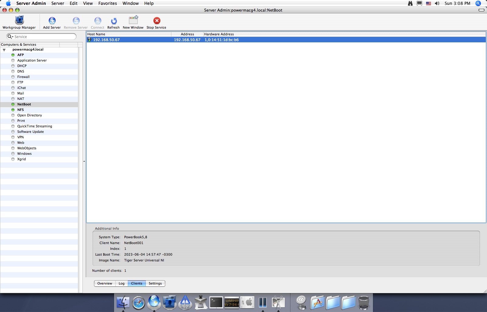

Now, I know this is silly, that I could just take the drive out and be done with it, but I decided to try one last thing before doing so: NetBoot (and NetInstall).

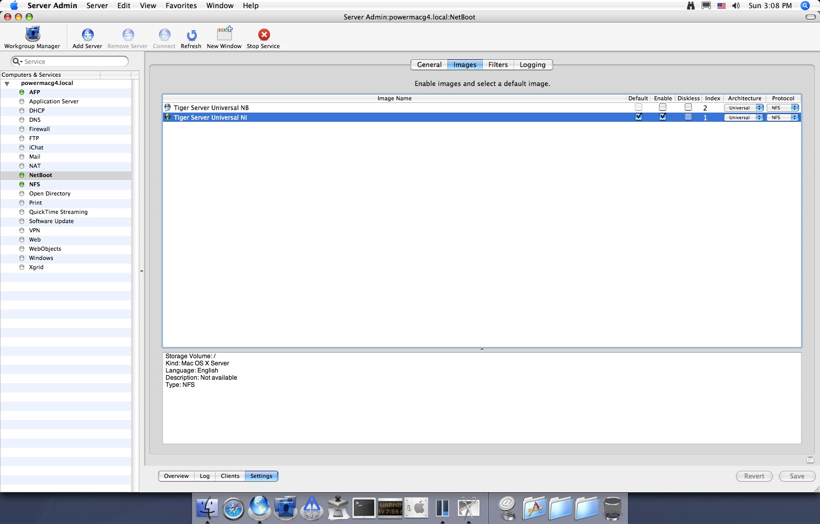

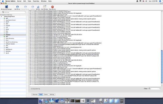

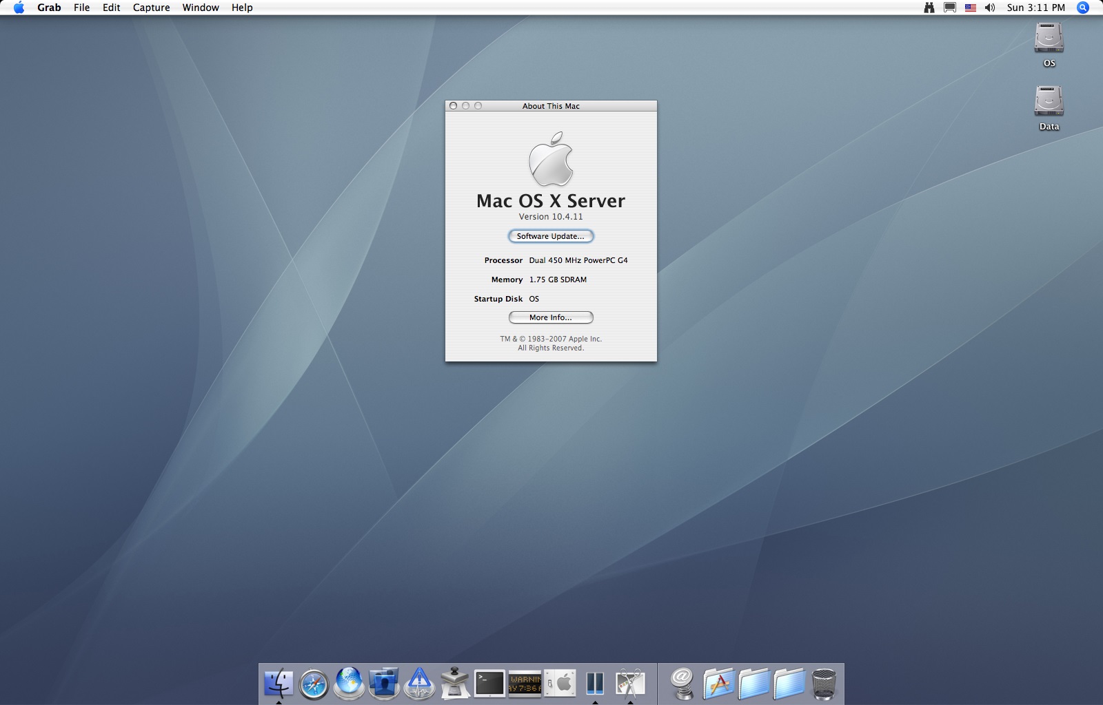

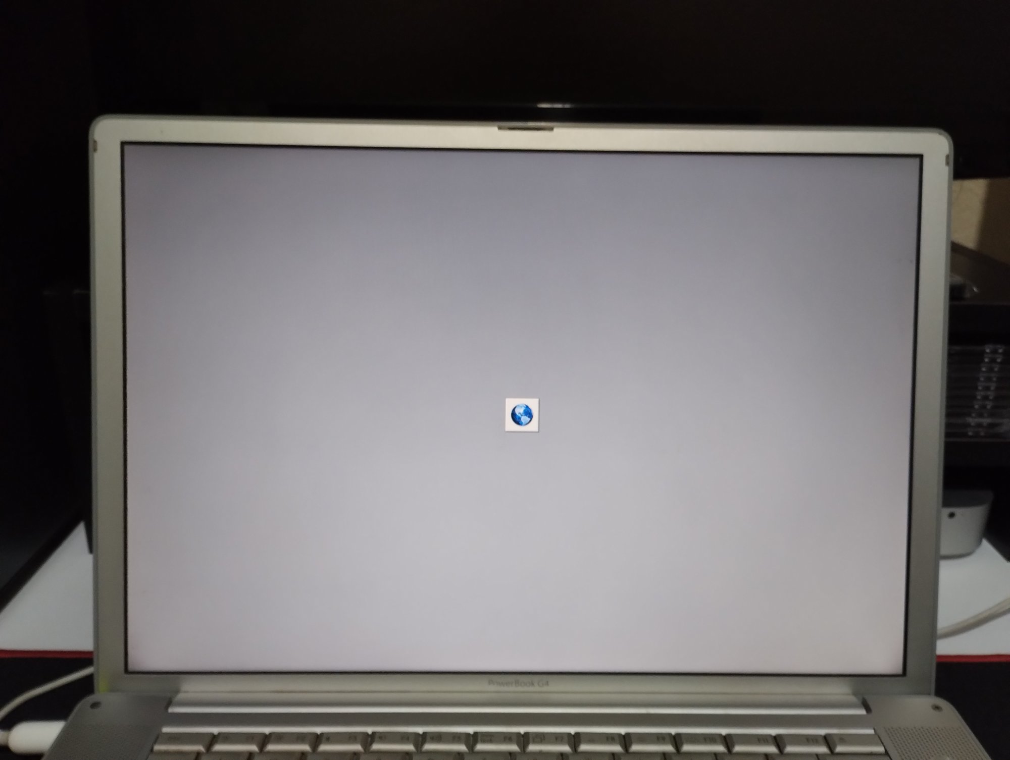

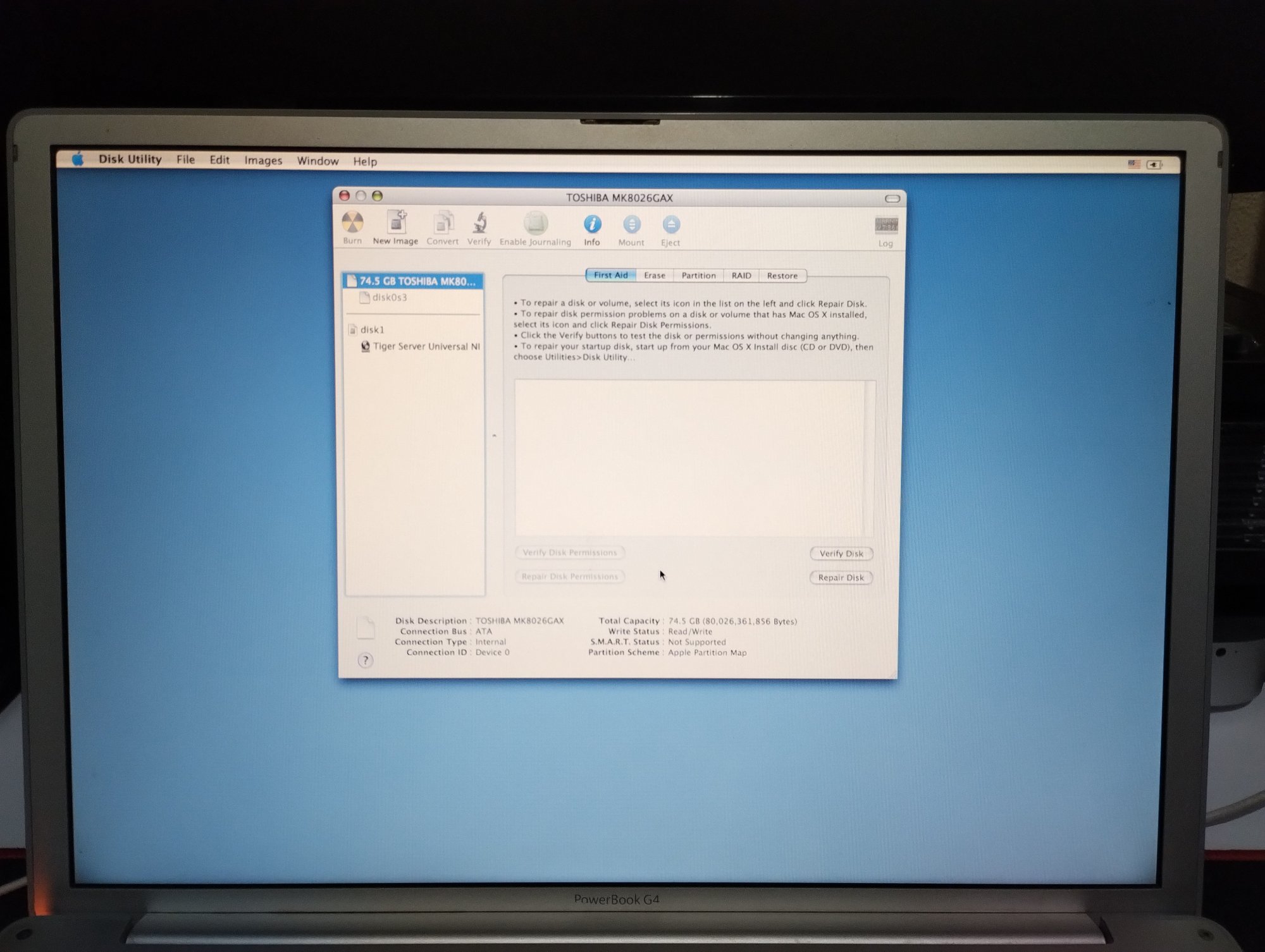

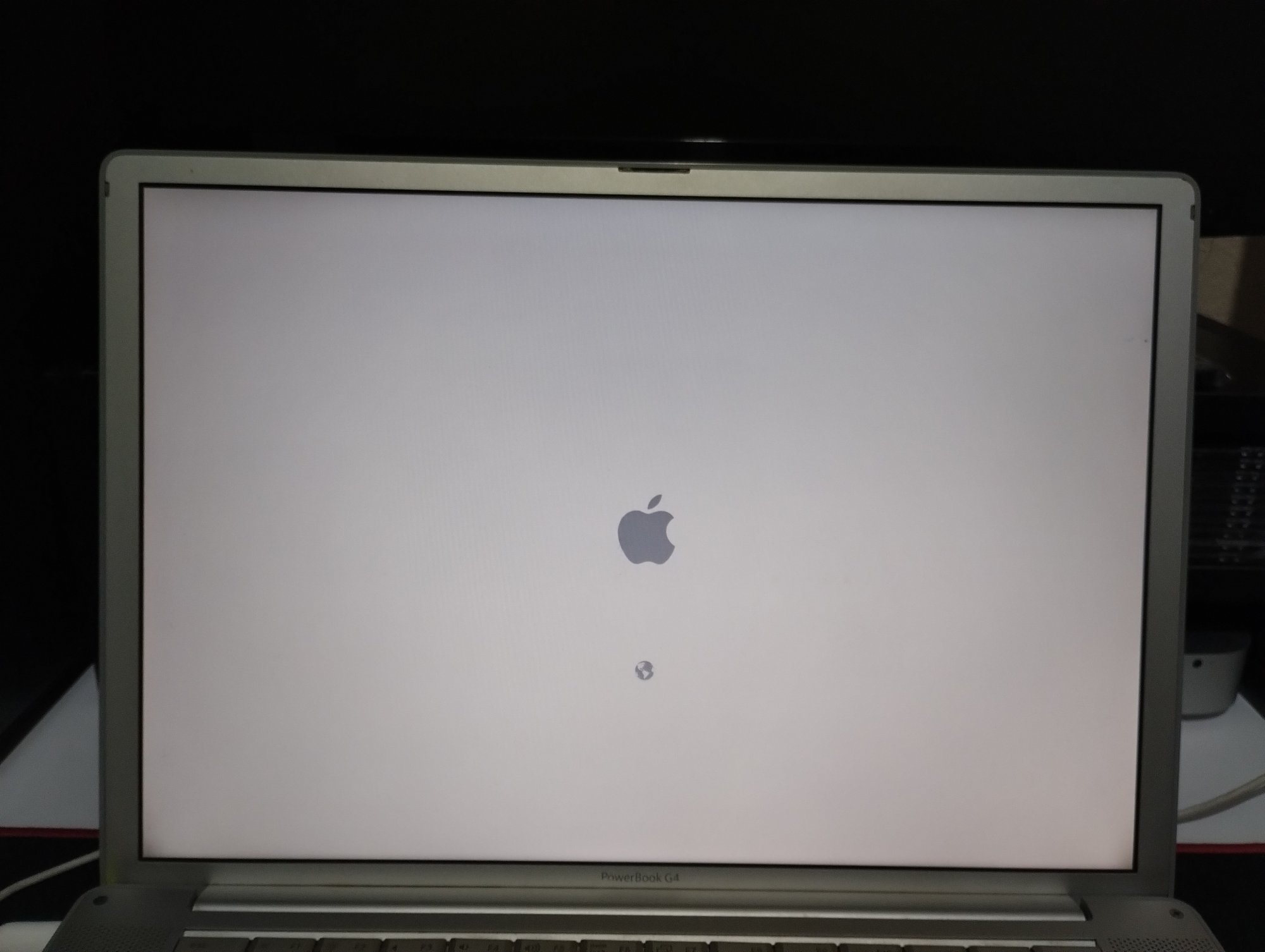

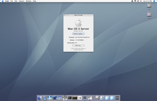

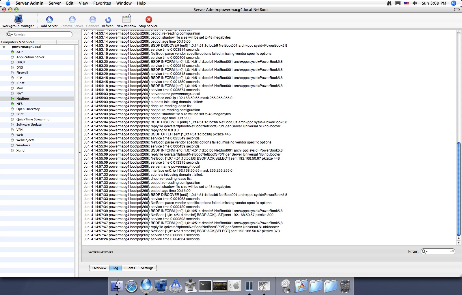

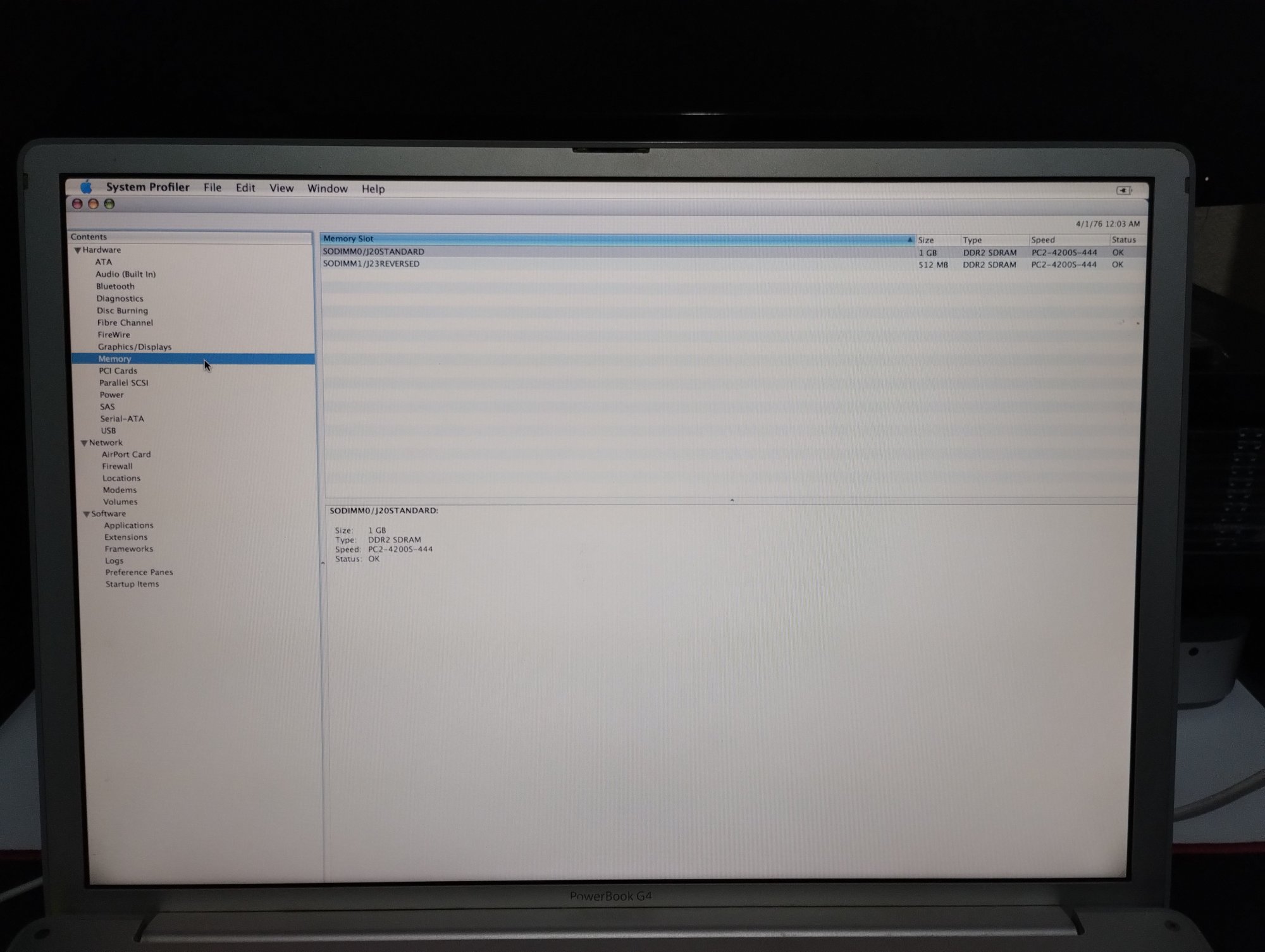

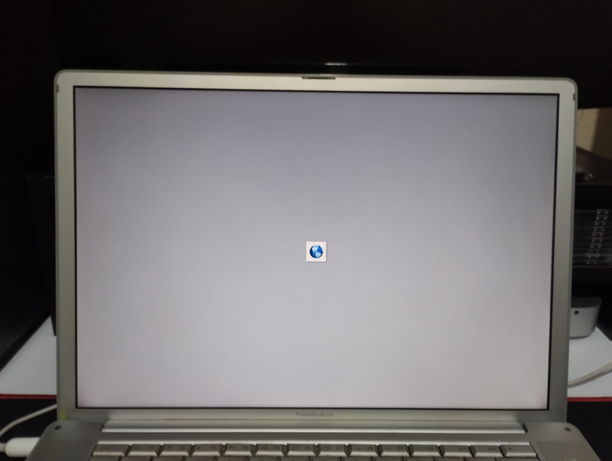

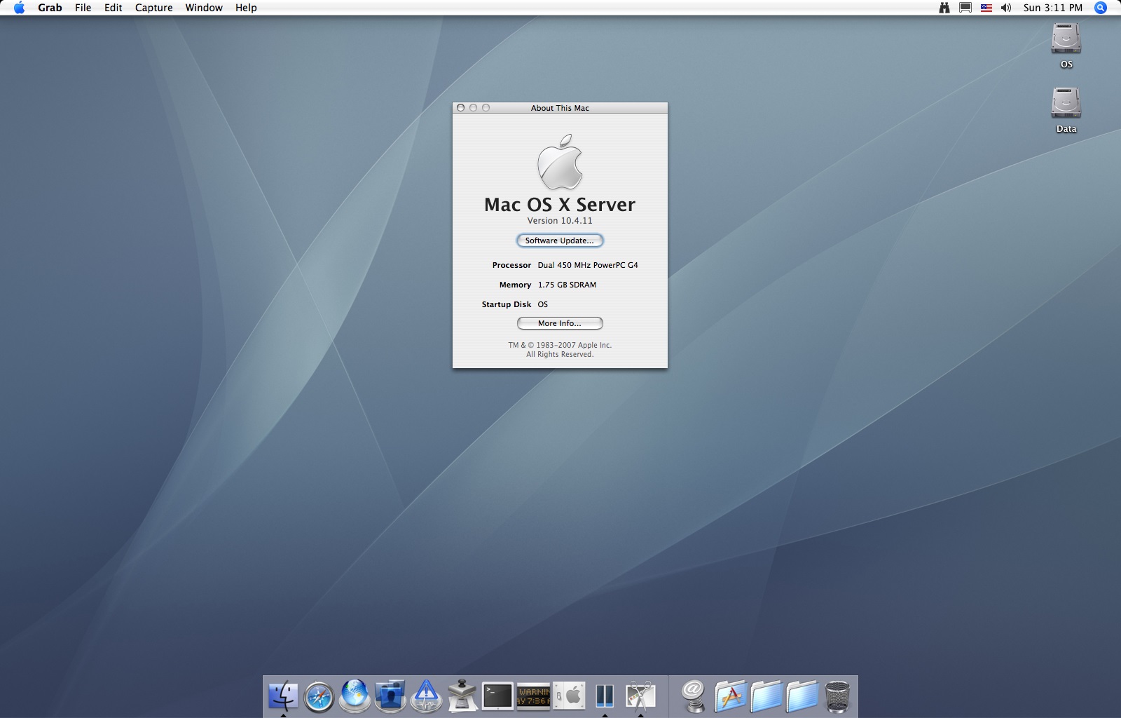

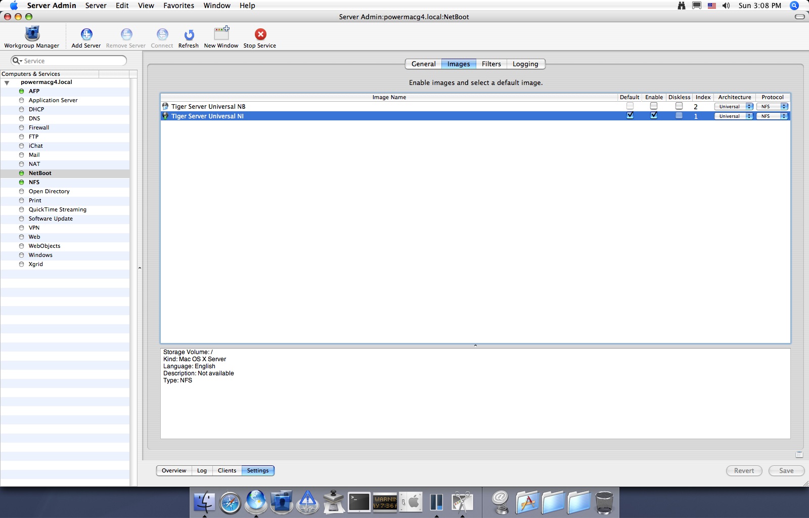

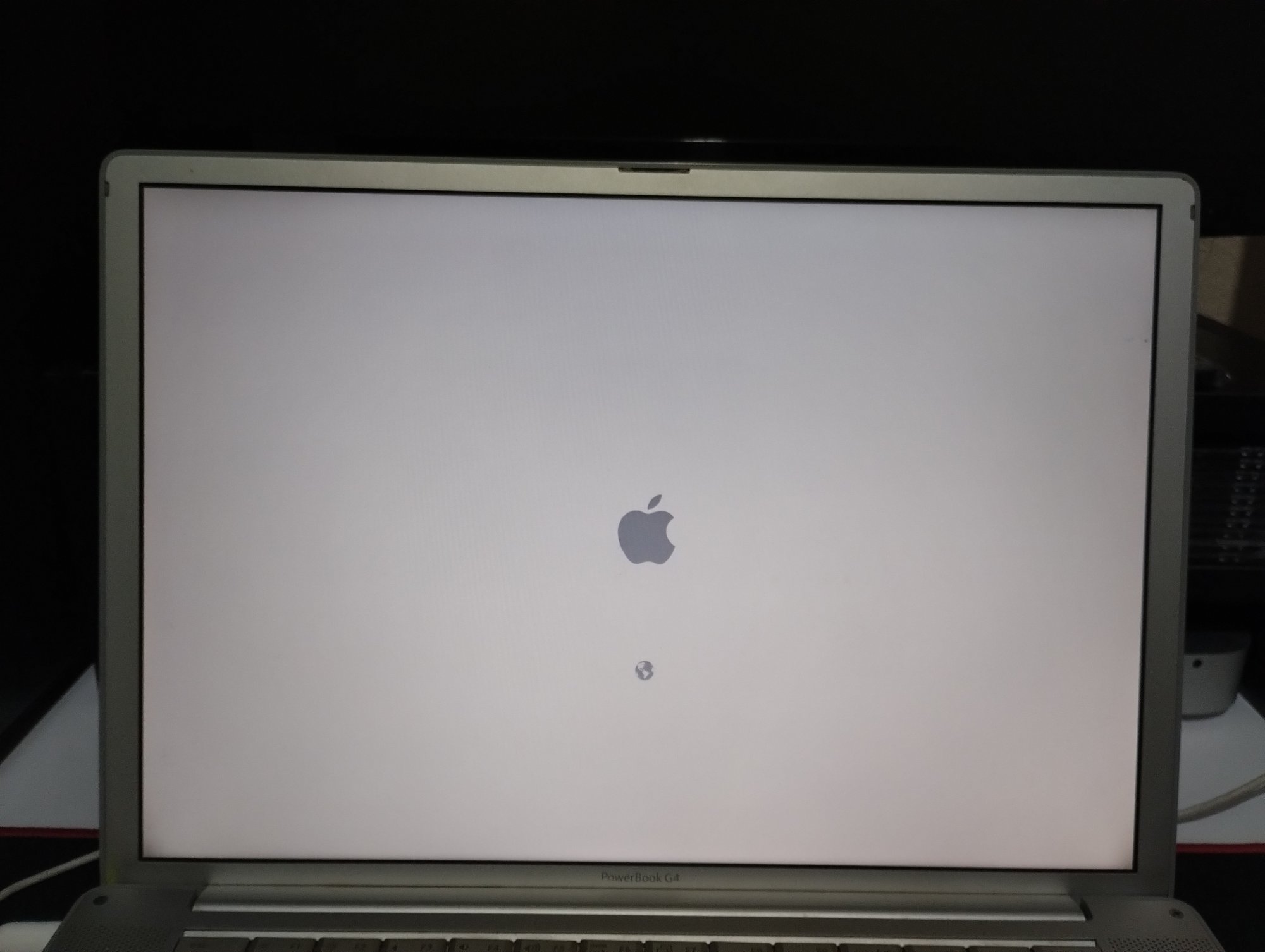

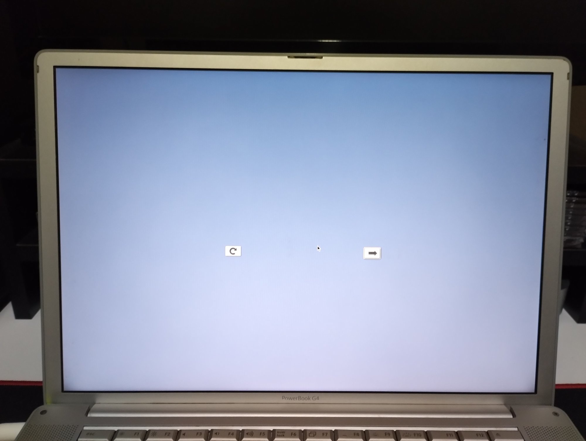

I'd been wanting to try Mac OS X Server and NetInstall/NetBoot for a while, but never got around to doing so, until now. I installed a copy of Tiger Server Universal (10.4.7) on a Power Mac G4 and started playing with it's options. I ended up creating two images, one for NetBoot and another for NetInstall. I enabled both, set the NetBoot one as the default, and turned on the PowerBook while holding the "N" key. The PowerBook sat on the NetBoot screen for a few seconds and voilà, Mac OS X started booting! With the NetBoot image I got as far as the login screen, but the system froze while trying to load the desktop.

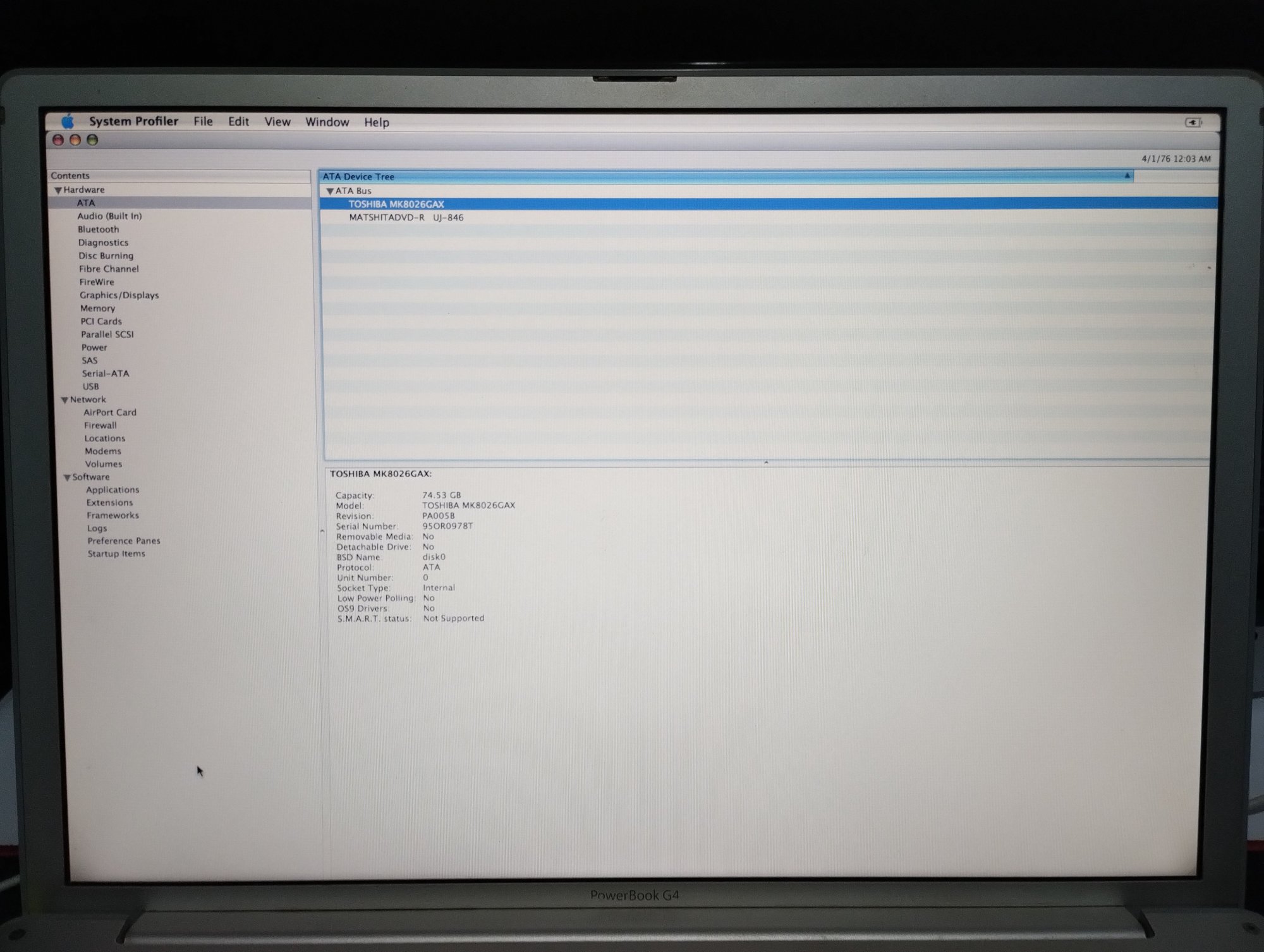

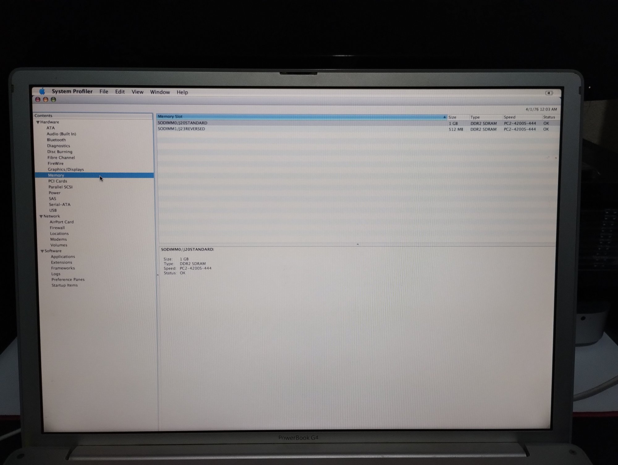

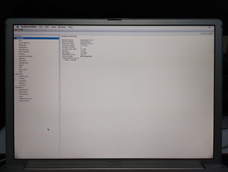

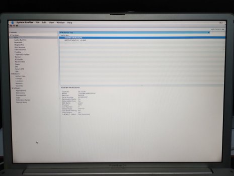

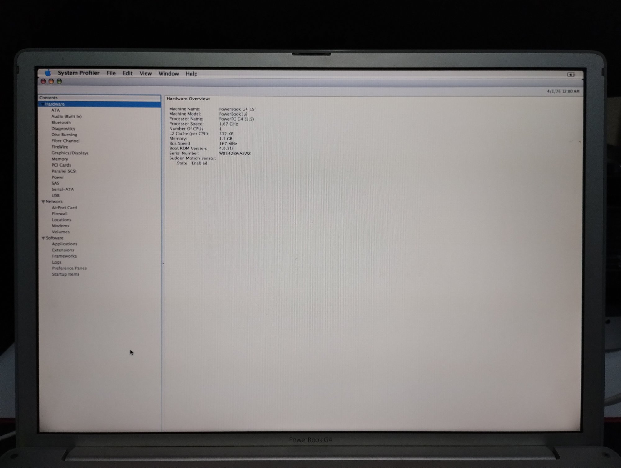

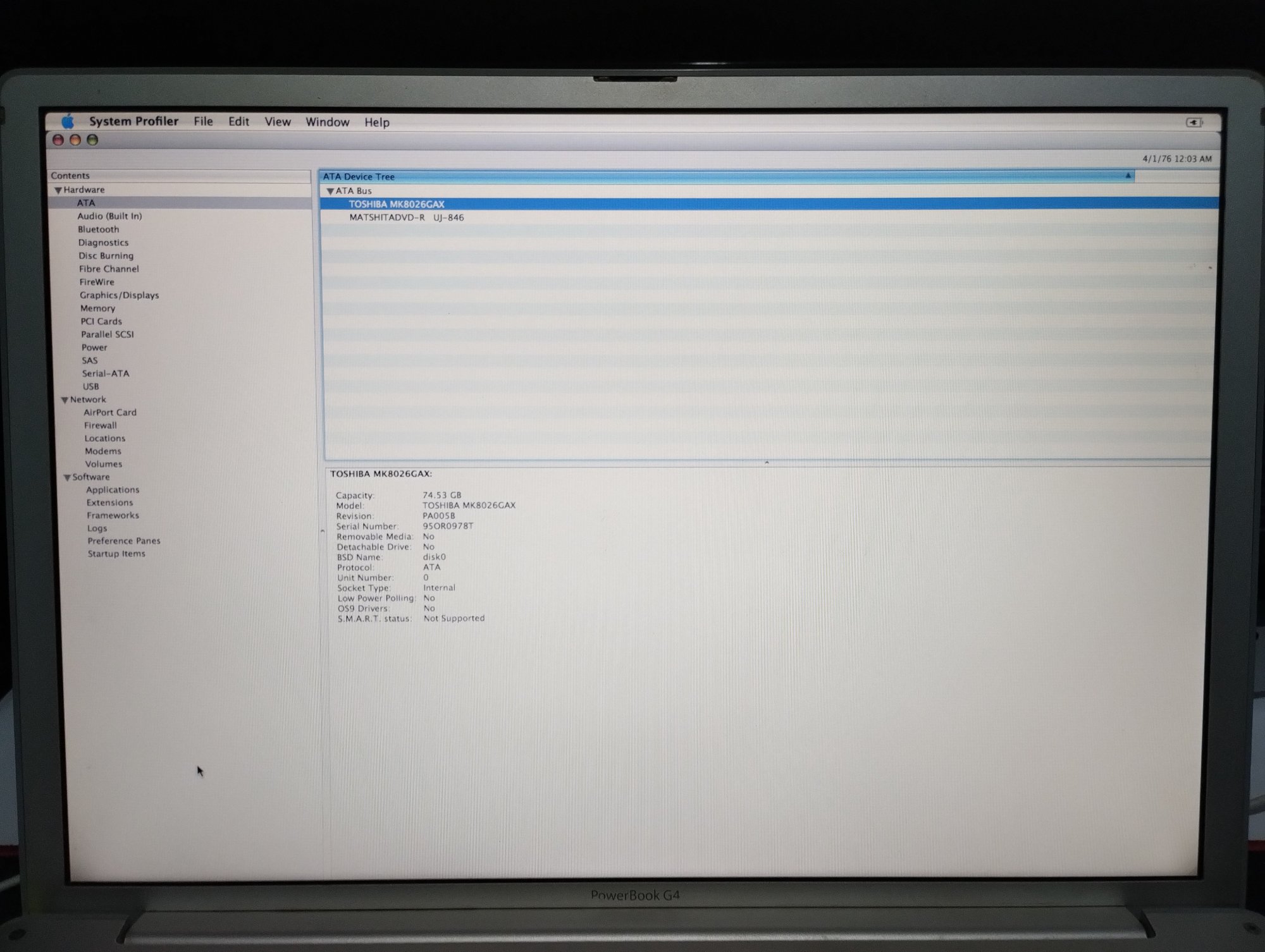

I then tried the NetInstall image, and it worked first try. After a few seconds I reached the installer, and finally could verify the PowerBook's specs (it's indeed a DLSD, with 1.5 GB of DDR2 RAM).

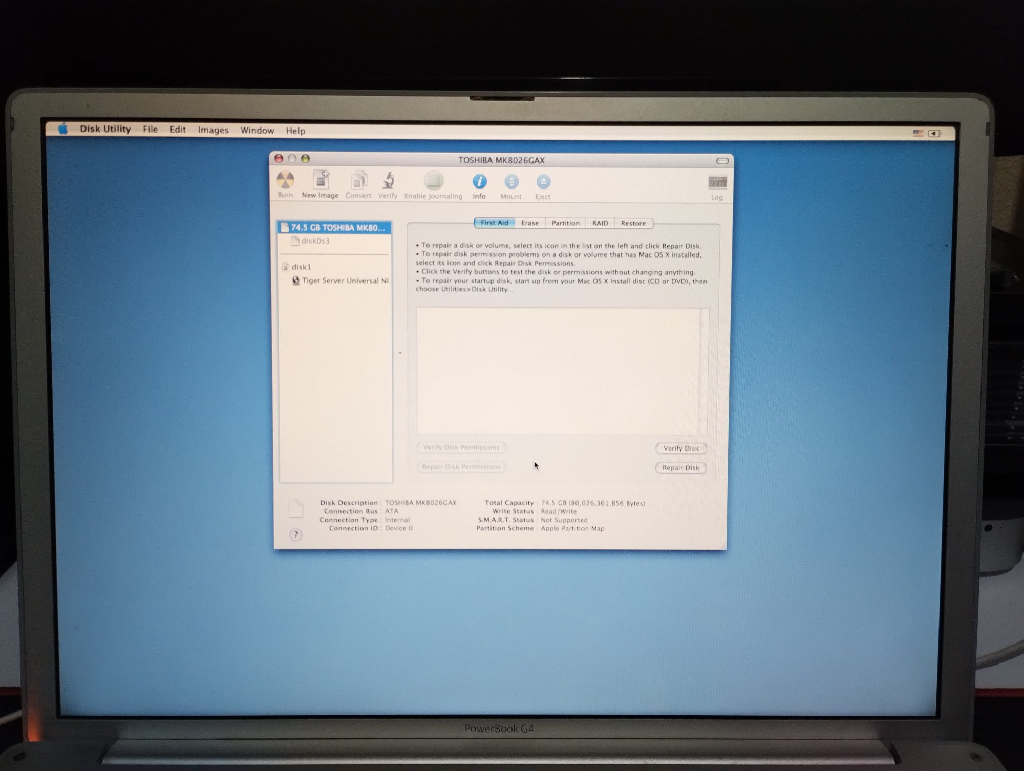

Surprisingly, both System Profiler and Disk Utility were able to see the hard drive, a Toshiba 80 GB unit. I tried erasing it, but the system froze during the process, confirming for this' theory that the drive is bad, but not to a degree where the system wouldn't detect it and thus skip it during booting.
So, now we know (or at least I do) that a bad hard drive can indeed stop a PowerBook from booting (and even affect the booting process in general, preventing external drives and optical media from being detected), and I found out how fun and useful Mac OS X Server (NetBoot in particular) can be.
The other way you would be able to know, without even powering it on or opening it, that it was a DLSD: look underneath on the bottom for those magical alphanumerics, “A1138” 😀
When you open it, the next way to know you have a DLSD: look for the ribbon cable with a sticker which reads “FOR POWERBOOK G4 1.67GHz OR HIGHER”. Only the DLSD models featured that.
