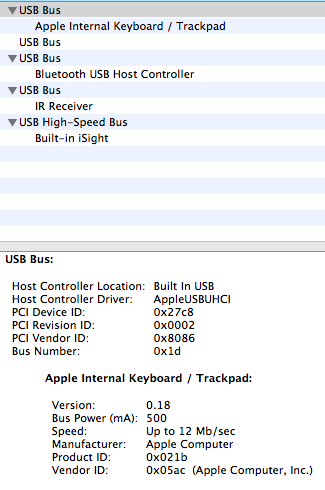

Probably. The C2D was a drop-in upgrade from the CD, so I dont see why they would have changed a lot of connectors around. Regardless, all the internal components (like keyboard, trackpad, iSight, etc) use USB:
