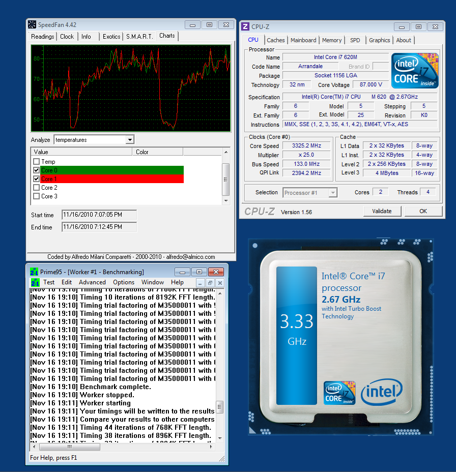

Well..uhh...
...this is what I get (native of course)....
