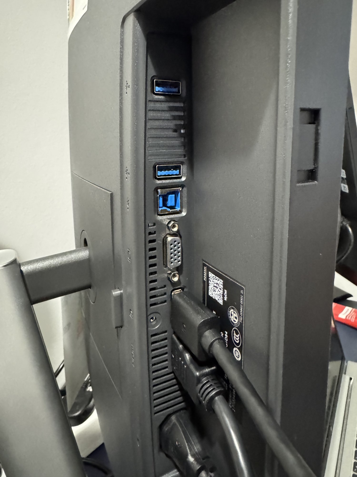

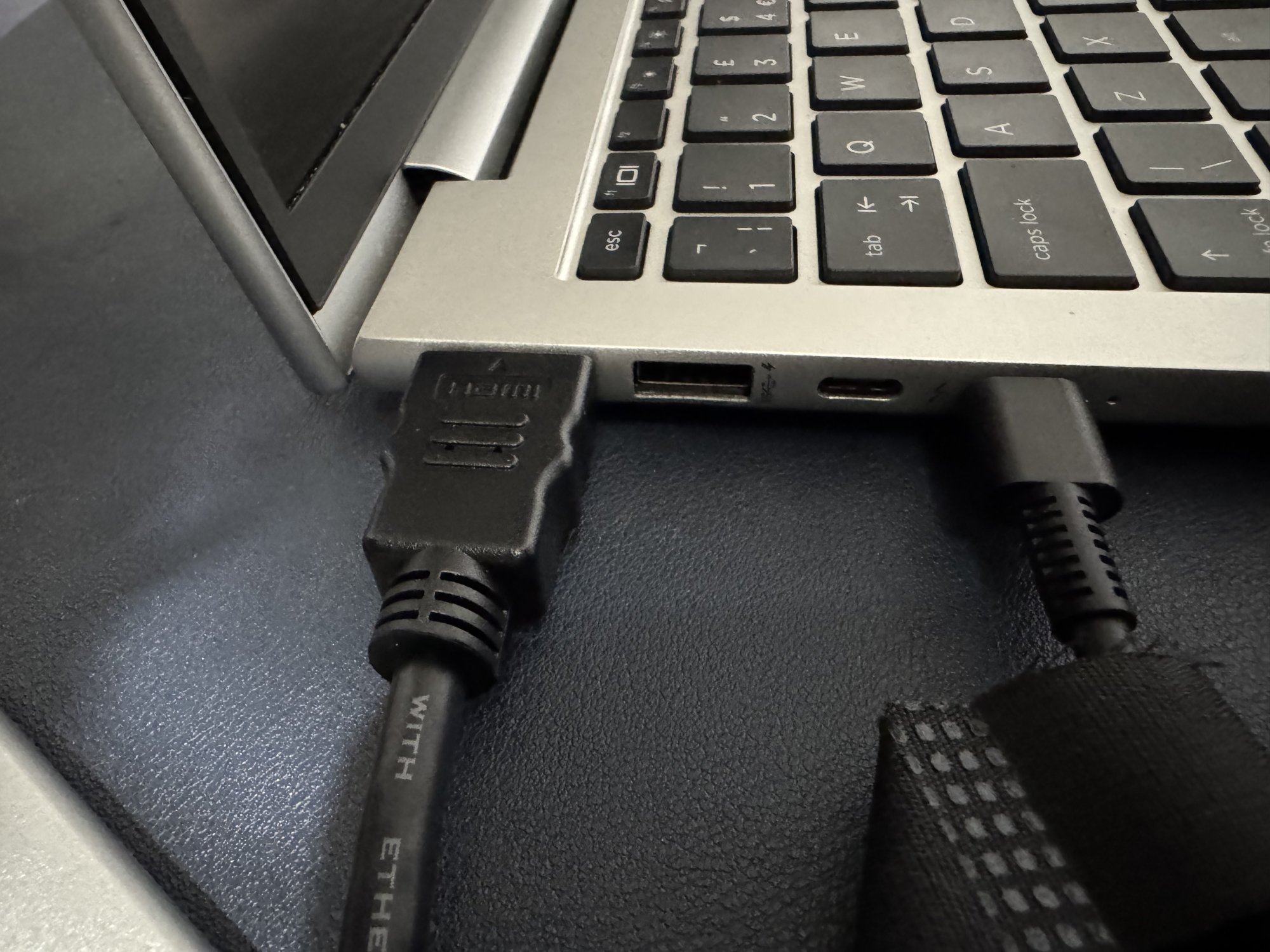

I’ve two Dell monitors and a HP Laptop
I’ve tried the display cable from the dell p2425h into the other second monitor but it doesn’t detect . I’ve connected the P2425H to the laptop through HDMI
Windows is not something I know about, but MST DP daisy chaining between DP monitors requires a DP signal from the computer to the first display.
A quick google search looks like this monitor doesn’t support daisy chaining:
No, the standard Dell P2425H monitor does not support DisplayPort daisy-chaining because it lacks the necessary DisplayPort Out port for MST (Multi-Stream Transport)
