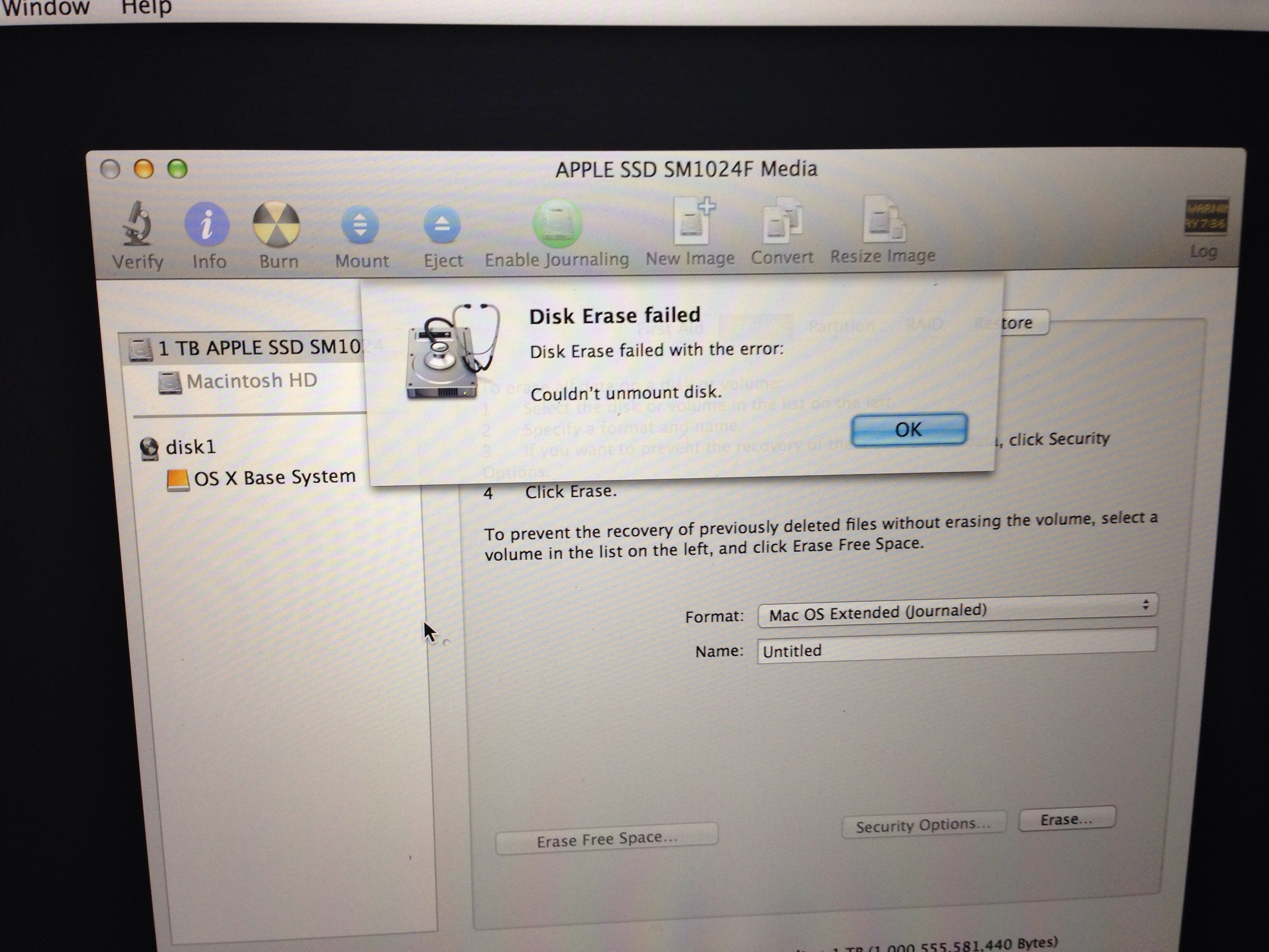

disk utilities to install new copy of Maverick disk Erase failed couldn't unmount disk . got this message
Okay for the second time I've installed fresh copy of Maverick with new account same thing happens at boot up keeps shutting off and turning on and off constantly rebooting. I don't assume to know much about computers but I'm believing to think hardware failure will take to be repaired next question closest Apple Store for me is an hour and 40 minutes away recently they opened up in my town a store called simply Mac they are authorized by Apple anybody have any experience with them. Thank you all for your replies and trying to help
