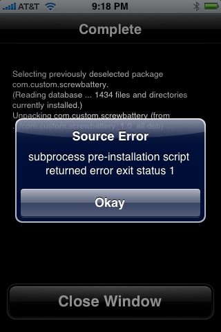

I used Cydia to install a battery image on my iP3G, then decided I didnt like it. I uninstalled it and now I have no battery image at all when charging (I am speaking of the large one on the main screen). Anyway, when trying to install any other battery images from Cydia, I always get this error.
Can anyone shed any light on this?

Hey, I have the exact same issue (on an original iPhone)... I even tried to re-install the same battery mod, and it had the same error! It's sort of frustrating, and I'd like to see some sort of resolution to this issue that doesn't involve restoring!
Can anyone help?

So, I found this on another site... what happens is the "charging battery" png images get deleted when you remove any of the battery mods. Seems like a huge bug that should be fixed. The quick fix is to put the necessary files back on your phone, then run Cydia and add the battery mod you want.
You need to get the original battery charging images, or just make up some dummy files that will take their place temporarily. They are called "BatteryBG_1.png-BatteryBG_17.png" (17 of them, total). After you have them, originals or not...
1. Go to the battery background directory:
/System/Library/CoreServices/SpringBoard.app/
2. Add the 17 missing files BatteryBG_1.png-BatteryBG_17.png to that directory
3. Run Cydia and find a battery mod (if you had dummy files)
4. Restart - everything should be fine
Now remember, if you use the Cydia battery mods, DON'T uninstall them... it will delete the files off of your iPhone and not restore the previous versions (as it should have done, in my opinion).
Hope that helps
