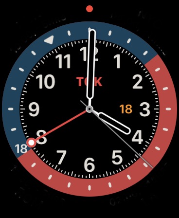

I can’t for the life of me figure out what the red pointer (the one that you can see between the forty and forty five minutes past) is for and also what it’s indicating?
I thought it was for a second time time zone. But I have that set to none.
Yes, I've spent quite a lot of time figuring it out.
Basically it's a second hour hand for the local time zone. However it completes one 360 degree sweep in 24 hours, as opposed to 12. It will be pointing straight up at midnight your time, and straight down at midday. You can count the hours using the markings on the bezel, you'll see there are 24 including the arrow located right at the top.
Now if you set a second time zone (e.g. tap the centre of the face), on the bezel where the red hand is you'll now see an hour indicator for the time in the alternate time zone. This will either be 1 through 12 if your Apple Watch is set to 12-hour time, or 0-23 if the watch is set to 24-hour time (you can change this setting within the Apple Watch app on iPhone --> Clock --> 24-Hour Time).
The bezel colour change then switches to the sun-rise / sun-set time in the location you have set.
If you don't want to set an alternate time zone you can still tap and set current location. This will have the bezel colour changes at the sun-rise / sun-set time and display the most recent completed hour in the location where you are. Tapping the centre and setting it to 'none', as you have in this photo, sets the bezel colour change to what you are seeing, e.g. 06:00 to 18:00, if you are reading the hour off the 24 hour outer bezel.

It tells you the time based on a 24 hour clock. Looking at the outside (the dashes on the blue and red) each of those is an individual hour. So its showing 16:40 as the time

It’s a complication many watch manufacturers use on their watches. That’s where you primarily see most GMT watches have what’s called a Pepsi dial like what you have here, or a black on top blue on bottom “Batman” dial. It makes it easier to know AM/PM quickly when looking at the second time zone. As mentioned here, it also offers 24 hour timekeeping as well.

No. It indicate YOUR time. Just look at the number the red hand pointing. It will be exactly the hour time on your time zone.
Looks here. It’s exactly number 4 (even though you can’t see it clearly) as same as the hour hand pointing, which is 4 o’clock.
Now if you change it by turning the crown then it will point to time of another time zone of your choosing.

Here
I set the secondary time for the city that‘s 2 hours ahead of where I am and when I glance at it I know suddenly it’s now 18:01. Why?
Because on the GMT “bezel” the only number shows is 18. Far easier.

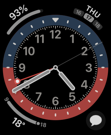

The apple implementation does have a few quirks. It only reads 24 hour time for the second time zone if you have your watch set to display all digital times in 24 hour format. I don't really want my digital watchfaces to show using a 24 hour clock, but I'd really like it if this watchface did.
The second issue is that they have the colors backwards for most of the options. I would think that the darker color should be night and the brighter color should be day (so in the red/blue images that are typically posted, night - blue - is on top and day - red - is on the bottom). But most of the color options have the brighter color on top (night) and the darker color on the bottom (day).
Combine the backwards color combinations with the lack of 24 hour time for the 2nd time zone, and it can become kind of confusing.
1000% agree. It‘s such a missed opportunity - for me, the majority of watch colors on this face are unusable as they counteract my intuition, i.e., in “Plum” the purple is nighttime and gray is daytime! Because of these unnatural-feeling day/night designations, I use the watch face far less than I would like…the traditional GMT faces of “Pepsi” (red/blue), “Coke“ (red/black), and “Batman“ (blue/black) all convey this information in a visually elegant manner! Other colors should try to follow suit.
