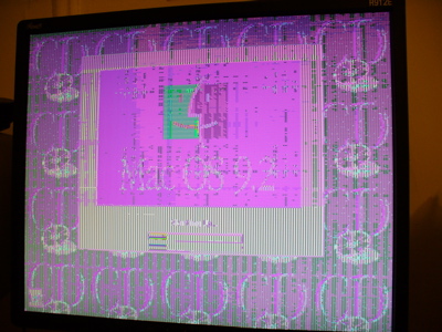

Yeah, I guess I'll have to piece it back together and see if I can get it to beep at me. Though I don't think the Cube had an internal speaker, and I don't have any more USB ones... hmm. Well, we'll see. And I don't think it's the hard drive, since the once I'm using for it is seen by other Macs, and it would have at least shown me the blinking question mark if it was missing the file system - and I get no video output at all.
Okay, I got it to finally boot up! Pieced it all together, used an external FW DVD drive, and this is what I got (see attachment).
So... I'm assuming this is a video card problem. Because that sure as heck ain't normal. I'll try it out on my CRT as well, to make sure it's not the LCD that's having problems interacting with it, but I seem to have narrowed it down to one key broken part...
