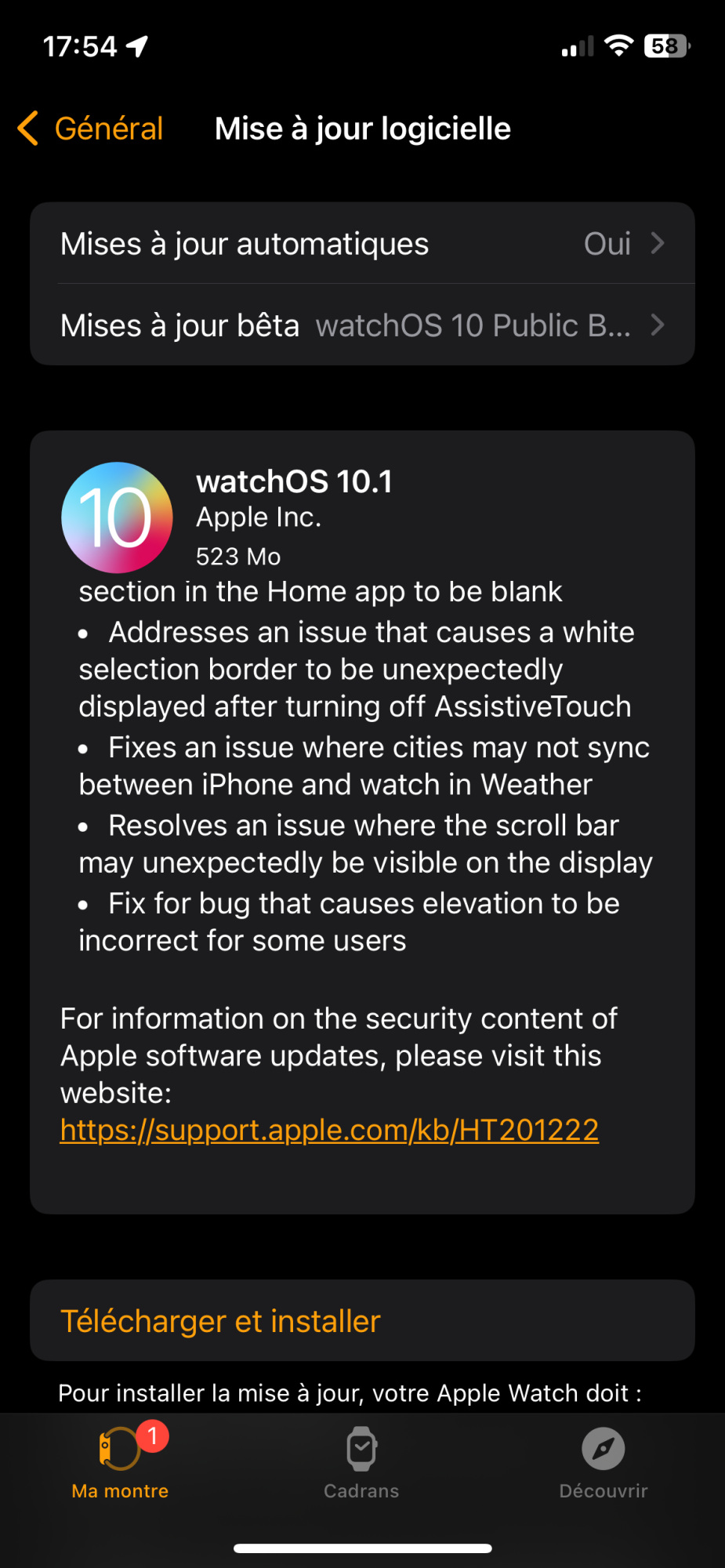

I'm pretty sure the WatchOS 10.1 RC release notes said the elevation problem was a bug fixed for 10.1. (I can't seem to find the release notes now to confirm.)
In any event, with the 10.1 RC, the elevation at my house is now reading the correct 85 feet (as listed by USGS Topo maps) +/- 10 feet . Previously it was reading 150 - 240 feet.

According to Apple, this bug will be fixed with the next update.
After updating apple watch 10.1, the elevation seemed fixed, but I feel like it still shows strange things from time to time. Is it the same for you?
I’m on 10.1 Ultra 2 and my home altitude varies at times. Most it’s 243 ft but it varies down to 174 ft. iPhone shows 300 ft. Very inconsistent
