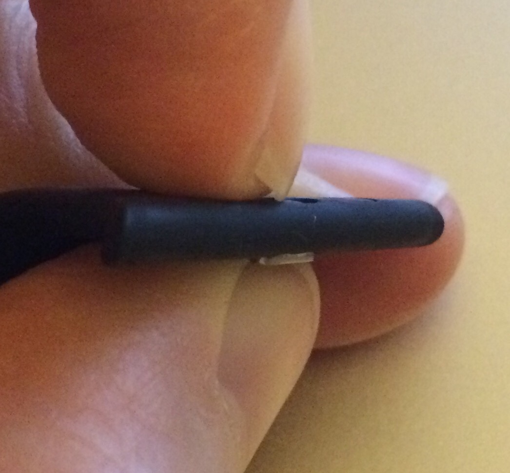

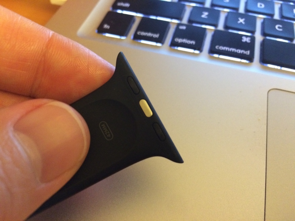

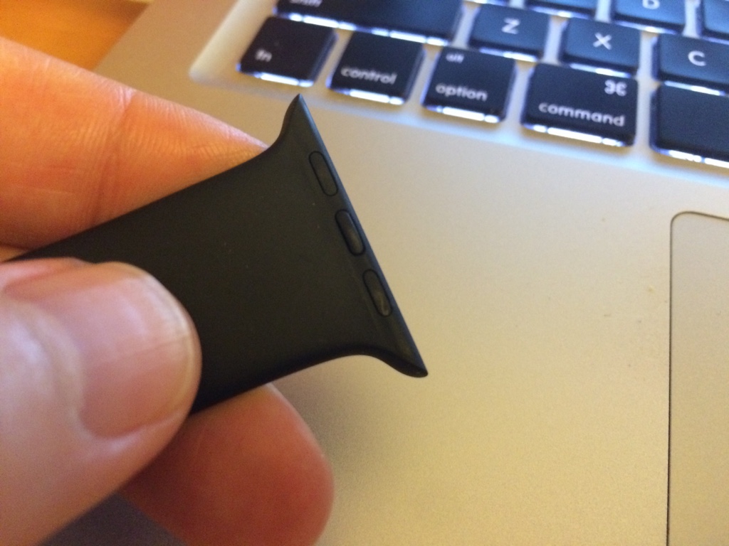

The bands have that little bump on one side, right? It's black on mine. The piece which locks the band into place is the silver metal piece on the other side.
As it slides into the channel on the watch, it loads the springs inside the strap end, which the push the flat metal piece into a corresponding hole in the watch.
The Watch's push button presses against this metal piece and lets the band slide out again.

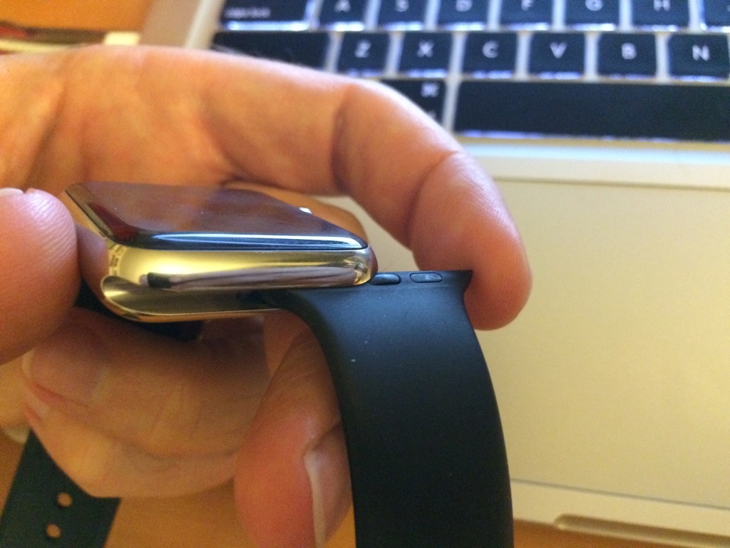

If you are careful inserting and removing the bands I don't see a problem. Hold the button on the case down completely when you slowly slide out the band so there's no resistance. When you are inserting your band, slide it in up to the point you start to see the middle button reach the case and then depress the upper middle button so the band slides in without catching the button and forcing it down.
You may also notice the bands slide into a channel that is slightly angled downward. You can notice this more when looking at the watch from the side. Maintain that angle when inserting and removing and that should also help.
