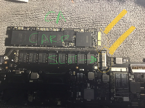

A friend of mine has a MacBook Air 2011 model that has died (her dog peed on it!! yes, seriously... you read that correctly!!) and I am wondering if it would be possible for me to attempt to extract the data on her internal SSD drive by connecting a USB to SATA cable to the internal drive and cloning the SSD.
I think the internal SSD of these MBA's are soldered into place so was wondering if I could open it up, disconnect the cable and somehow connect a new SATA cable.
Don't think this is possible as it is soldered, but thought I'd ask anyhow 🙂

The SSD can be taken out. Just remember that SSD's in Apple products have that proprietary SSD connector so you will have to find the right adapter to plug it in.

If it can be taken out, it's an SSD with a SATA connector surely, so can accept a normal SATA cable?
No. It's a card-type SSD, and plugs into a card connector on the logic board, no cable there at all.
It's similar to an M.2 SSD card, but the pins on the card edge have a pin or two different spacing (just enough to make it compatible only with other Apple products.)
Looks like this - and you would like to get the white enclosure in the background from that kit, as that's really all you need (and a standard USB cable to plug in to another Mac.) OWC also sells the enclosure separately

Nope as far as I know it's an m2 flash storage. Looks like a stick of gum. Connector on end slides into MB connector. Connector is a Mac specific connector. It's not a standard m2 connector. There is a a slot in the connector. Some are near the middle some are off to one side depending on year/type. Need to find the right connector. Adapters are also available.
https://eshop.macsales.com/shop/ssd/owc/macbook-air/2010-2011
