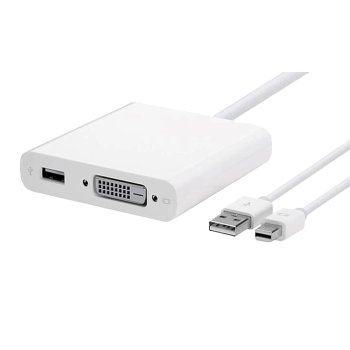

Hi guys previously I had my 2015 Macbook Pro connected to my 30" Apple Cinema Display which ive owned since 2008 and it worked brilliantly. A few years ago I replaced my Macbook with the then new M1 Macbook Pro however never really looked into connecting it to my 30" Cinema Display. Ive seen this done using external adaptors however I was wondering whether I could somehow utilise my Apple Mini DisplayPort to dual link DVI adapter to save me from having to buy additional accessories? I have attached a picture of the adaptor I have. Whilst I know it has a USB Type A connection, I have a Type A to Type C converter for it.
I have tried connected it all up and whilst the Display power LED does come on, the screen remains blank.
Any advice is appreciated
Thank you :)

The USB-A connector is only to provide power to the electronics in the adapter. The video signal is only in the mini DP connection.
So you need an Apple Thunderbolt 3 to Thunderbolt 2 adapter to pass through the video for your M1 to your monitor's mini DP connector, and a source of power to the USB-A plug - simplest is to use a USB-A PSU.
I haven't tried this with an M1 Mac, but I used it for an earlier Intel MacBook Pro.

So you need an Apple Thunderbolt 3 to Thunderbolt 2 adapter to pass through the video for your M1 to your monitor's mini DP connector, […]
That adapter will not work with DisplayPort devices. It only works with Thunderbolt devices, such as Thunderbolt displays. It can’t be used in this case.
You can get a simple USB-C to miniDisplayPort adapter and daisy chain the miniDP to dual-link DVI adapter to that (you’ll also need a USB-C to USB-A adapter or USB power supply to supply power to the adapter) or buy a USB-C to dual-link DVI adapter.
Hi and thank you so much for taking the time out to reply.
Following what you advise would any USB-C to Dual Link DVI work. If that is the case I would rather buy one item rather than a few gadgets to make the previous adapter work. My query was more from the perspective of possibly not having to buy anything additional but if I must I would rather take the most minimalist approach.
Ive seen on a few youtube videos the same USB-C to Dual Link DVI being recommended however wondering if any kind would do as good of a job.
Thank you
Sorry Paul I have just seen your reply now buddy. Really appreciate your contribution. I think Amethysts recommendation of a USB-C to Dual Link DVI sounds like a good idea dont you think.
I suggest you have a look at this thread (e.g. post #15), which suggests it isn't that simple. Given that, I'd probably give the USB-C to miniDP > miniDP to dual-link DVI route a try first.
