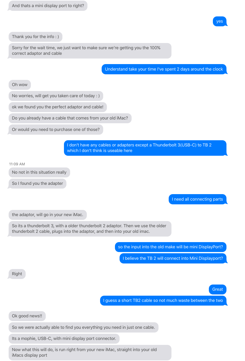

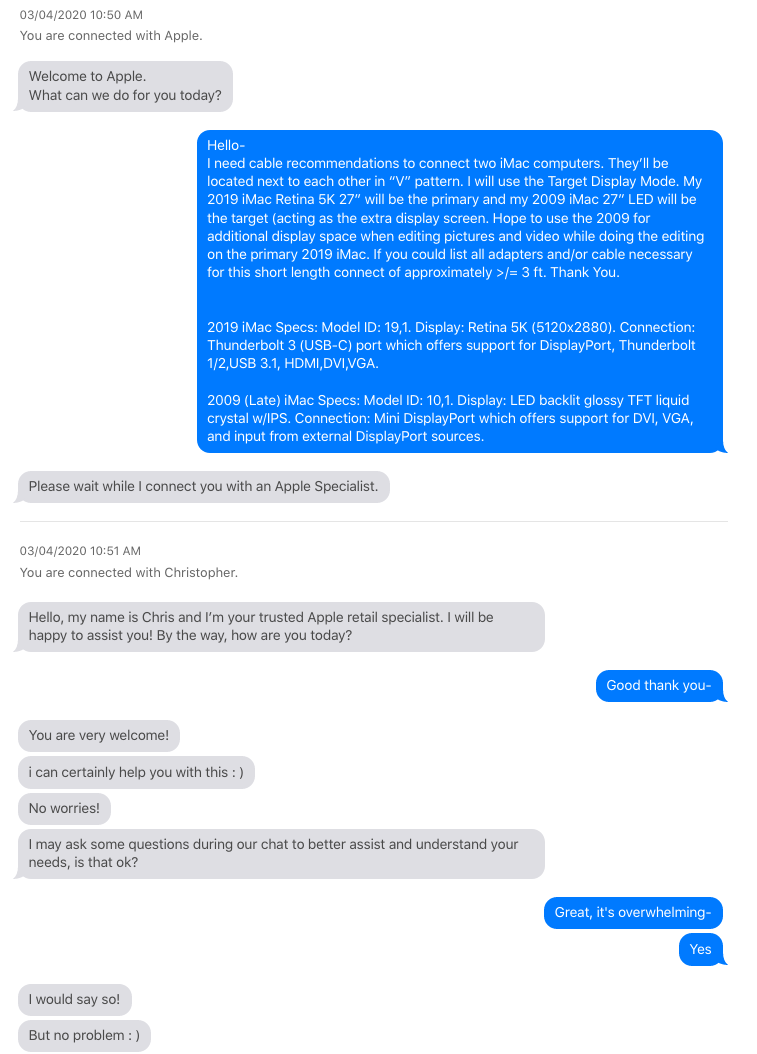

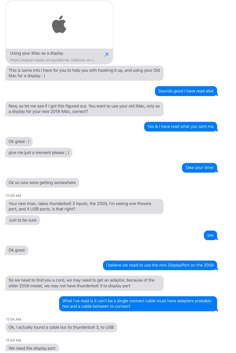

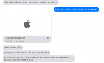

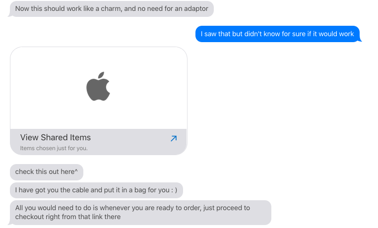

Here is the answer, I got through to Apple help. One single cable, "Mophie USB-C Cable with Mini DisplayPort Connector". See here: https://www.apple.com/shop/product/...-connector?fnode=8b&fs=f=cable&fh=4595%2B45c4
As most here have suggested and in all the Apple help it continually states multiple adapters are necessary. I found a single cable (similar to that in the Apple link above) from a 3rd party vender site but they explicitly warned NOT to use it connecting two computers due to fire hazard and machine/display damage.
I attached the Apple Support Help conversation with "Connect with a Specialist". I took 4 screen shots of entire online chat.

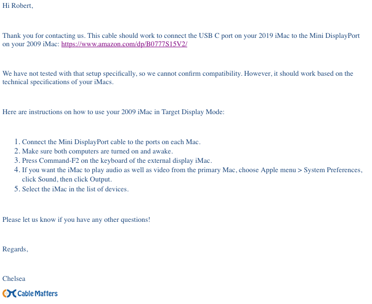

I also contacted "Cable Matters" and they returned with a similar and cheaper cable see here: Amazon
I went with the above Apple option, always a better choice in the end when dealing with cables as I've learned. Included the correspondence from the company in attachment.
