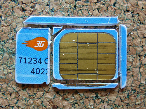

I have a full sized SIM from a work phone that I have used in my last two iPhones. This account is paid for so I want to cut that SIM to put it in my iPhone 4.
It was easy last year to activate the 3GS with a new number (I later put that SIM in my 2G iPhone and gave it to my daughter), swap SIMS and then everything worked fine. With the smaller SIM slot, I am not so confident. I know that people have cut full sized SIMs and put them in iPads, but I don't want to mess up my SIM since it might be tough to get another one from work.
Anyone know? I have looked at the tutorials online, but the iPhone 4 contacts look a little different than the ones I am seeing.

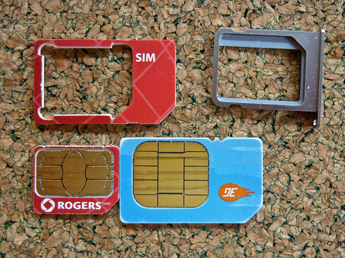

Here is what is scaring me a little. The contact part of the SIM is a different size.
3GS on the left and iPhone 4 on the right.

The contact on my sim that I cut was the exact size of the micro sim. I ended up not using it and just having AT&T activate the iPhone 4 sim with my number but it should work. Of course all it takes is a quick call to AT&T to activate the iPhone 4 with your number.

For the archives and anyone else in my situation.
It worked.
I activated the iphone 4 with my daughter's number.
Then pulled the Micro SIM out.
Put that Micro SIM in an adapter in my 3GS to give to my daughter.
Cut my full size 3GS SIM to a micro size and put it in the iPhone 4.
Phone works. :)

I have a prepaid Go phone that I'm using with a 3GS. I want to buy the iPhone 4 no commitment price, cut down my SIM and throw it in the iPhone 4.
I cut my AT&T GoPhone sim card down and sadly it doesn't work now. :(
I'm not sure if it was because I cut into the three metal contacts on the bottom of the card. The microSIM that I have from Rogers doesn't seem to have the top or bottom contacts...
