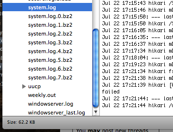

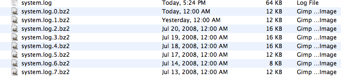

Actually, system.log.1 is already a backed up file -- system.log is the active log. So (1) it doesn't matter what method you use to delete it (because the system is not currently logging to it) and (2) when you delete it, the system will continue to log to the log file it is using, i.e. system.log ... but it does sometimes happen that the current log file has gotten out of hand, so this is still good advice. 🙂

I wonder why it isn't noting itself as compressed.
Yeah, that's odd too. I thought they automatically compress when they rotate now. Particularly at 5GB, one would hope. The 5GB file will probably be about 60kb when compressed. 😀
