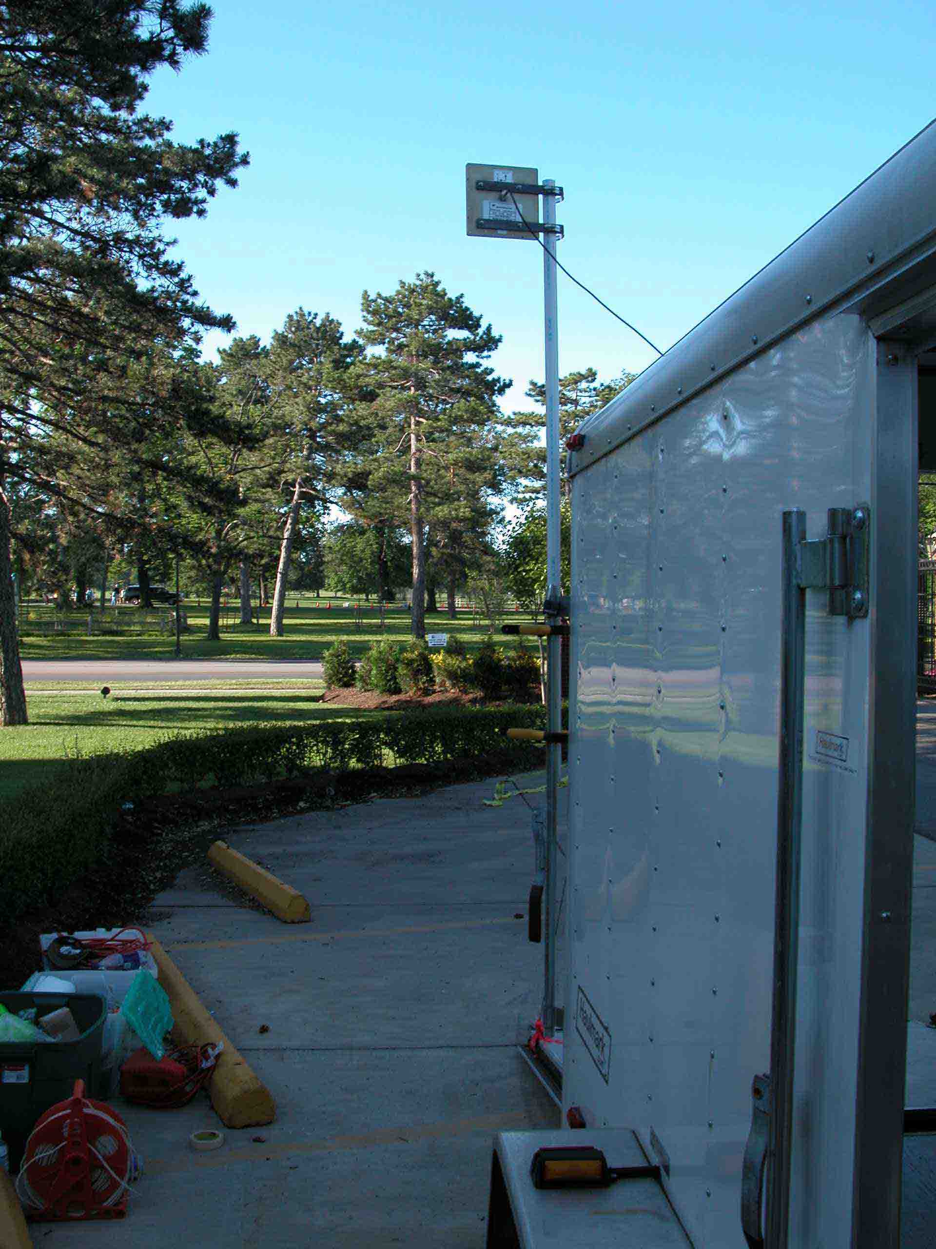

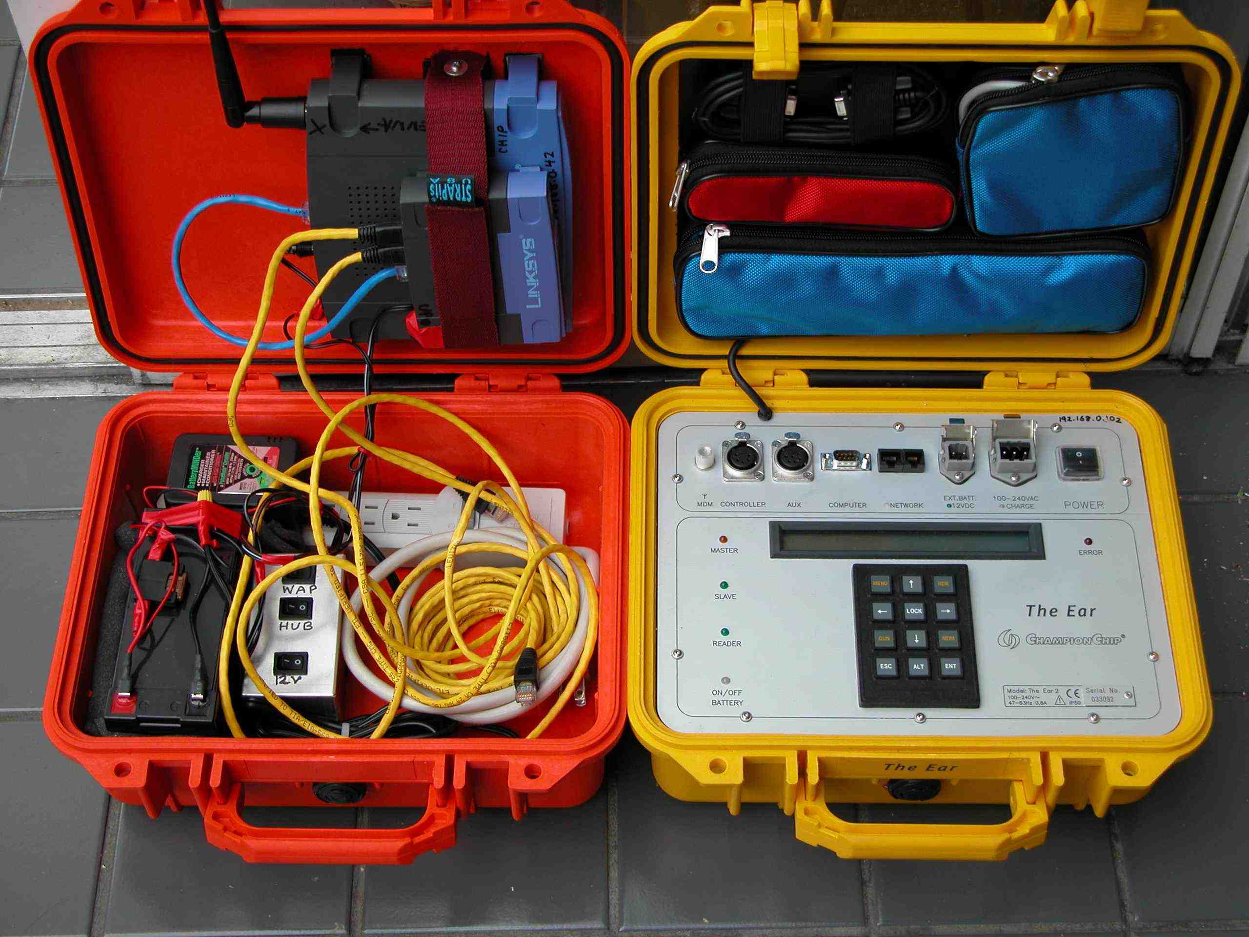

Three or four years ago I had to construct a wireless G link that would work up to .5 mile (and was portable/battery powered, but that's not your problem).
It wasn't difficult.
Here's your materials list:
-- two wireless access points (WAP) with external antennas
-- two high gain directional antennas
-- cabling (RF cables; ethernet cables)
-- appropriate mounting hardware
Each WAP attached to your router via ethernet cable.
The WAP's external antenna is removed, and the high-gain antenna is cabled to the antenna socket on the WAP.
The WAPs are set to "bridge mode."
That's pretty much it.
Here's a link to the company I used for the equipment
http://www.hdcom.com/links.html
I used Linksys WAP 54G because that's what HDCom liked -- I had no opinion, so it was fine with me.
They don't seem to be carrying the antennas I used, but they were like these:
http://www.wirelessnetworkproducts.com/index.asp?PageAction=VIEWCATS&Category=480
This was a very effective setup for me, and it had to be because my business depended on it (those times when I needed to use it).
Here's an image of the portable setup (the WAP has its small antenna attached in the picture; in use, there would be a cable running from the WAP to the antenna. Ignore the yellow device on the right ... it's the device that the portable WAP setup was designed to connect to.
The second image is of the antenna in use. In the background you can see some orange cones -- that's where the other antenna was. In this case it was a couple of hundred yards away. I could go much farther if needed.
