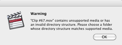

I noticed today that a quicktime file never made it from LOG and Transfer to FCP all the way. The file is 13 gigs big. I don't have the original clip from my Canon Vixia HF20. I try to drop it into FCP and it says that it's "unknown file type"
Is there anyway to rescue this file and have it converted into a proper quicktime file?
Well with no luck anywhere else I used AeroQ's software and it worked.
FC had only transferred 12 min of the 60 minutes of the video but I was able to recover the first 12 minutes. The service was very fast and the software is very easy to use.

See if VLC plays it, if it does you can use the advanced output feature to reencode.
VLC WILL play anything, but that doesn't mean that it will turn out well on other programs, sites, etc. For example, it will (almost always) look terrible on say YouTube or an embedded file.

Here's a movie repair tool: http://grauonline.de/cmsimple2_6/en/?Solutions:HD_Video_Repair_Utility
The tool works on most camera movie files and requires a non-broken sample file of the same camera to repair the corrupt file.
