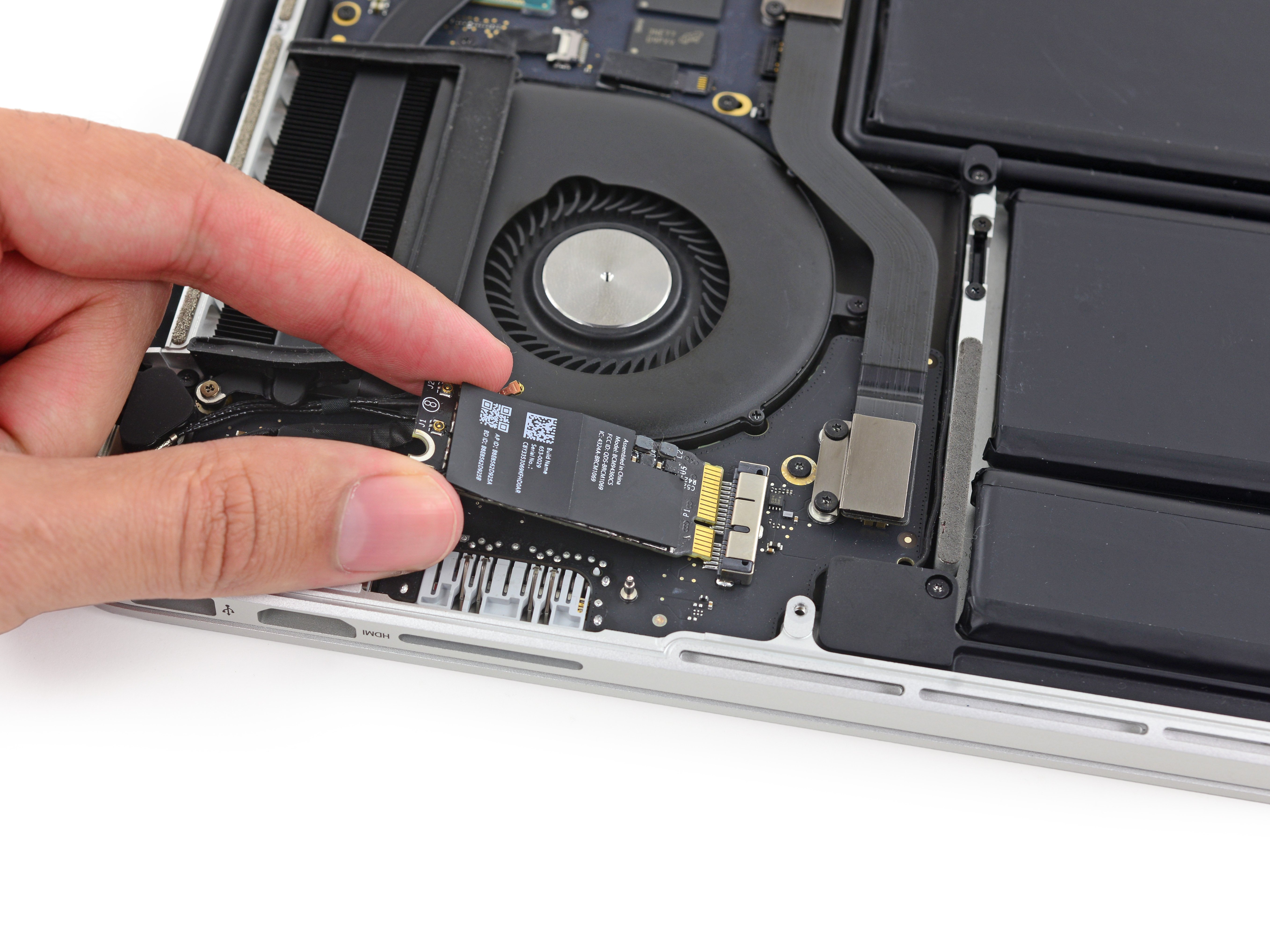

You simply have a Wi-Fi/Bluetooth card, with a failed Bluetooth section. It's certainly worth trying a replacement card for less than $20. The replacement job is not hard. Should take no more than 10 or 15 minutes. You do need the correct tools for that replacement. The link that MacCheetah3 posted above is a good one that shows you everything about the repair.

Here are the 13-inch instructions.

Yes, plug and play. The software is included with macOS.

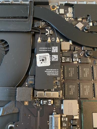

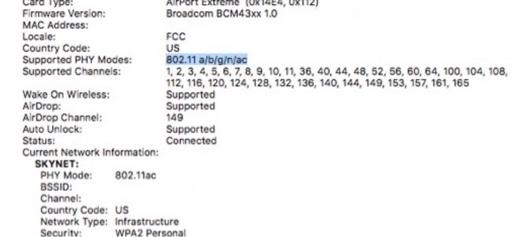

The wifi/BT card should be in the laptop with three wires connected to the top part of the card. If you see the three wires but no card then you can easily get a replacement card from eBay. I sourced a wifi/BT card for 2013-2015 MBP so that I could upgrade from the 802.11n card to an 802.11ac card. These cards are plug and play and work as I now have 802.11ac on my Early 2013 MBP 15-inch.
It was a very easy upgrade
